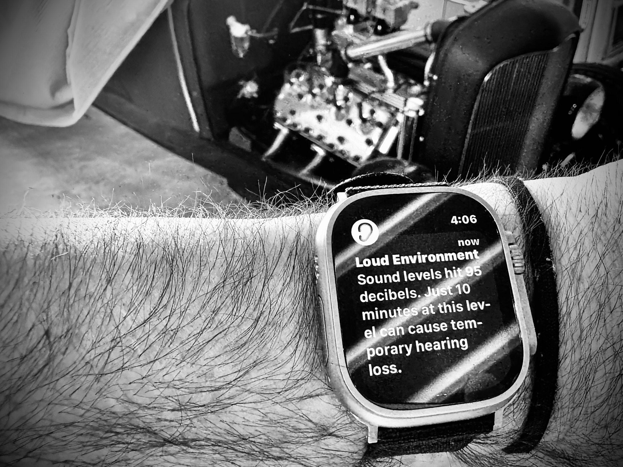

    Really want to run the Eddie Meyer intake, but just can’t beat this intake icing problem. Driving me nuts, but this photo makes me happy.
  2. Sharpone
    Joined: Jul 25, 2022
    Posts: 2,494
    Sharpone
    What’d ya say
    verno30, chryslerfan55 and Stogy like this.
  3. banjorear
    Joined: Jul 30, 2004
    Posts: 4,737
    banjorear
    Haha. Things sure do get loud inside a garage with an uncorked flathead.

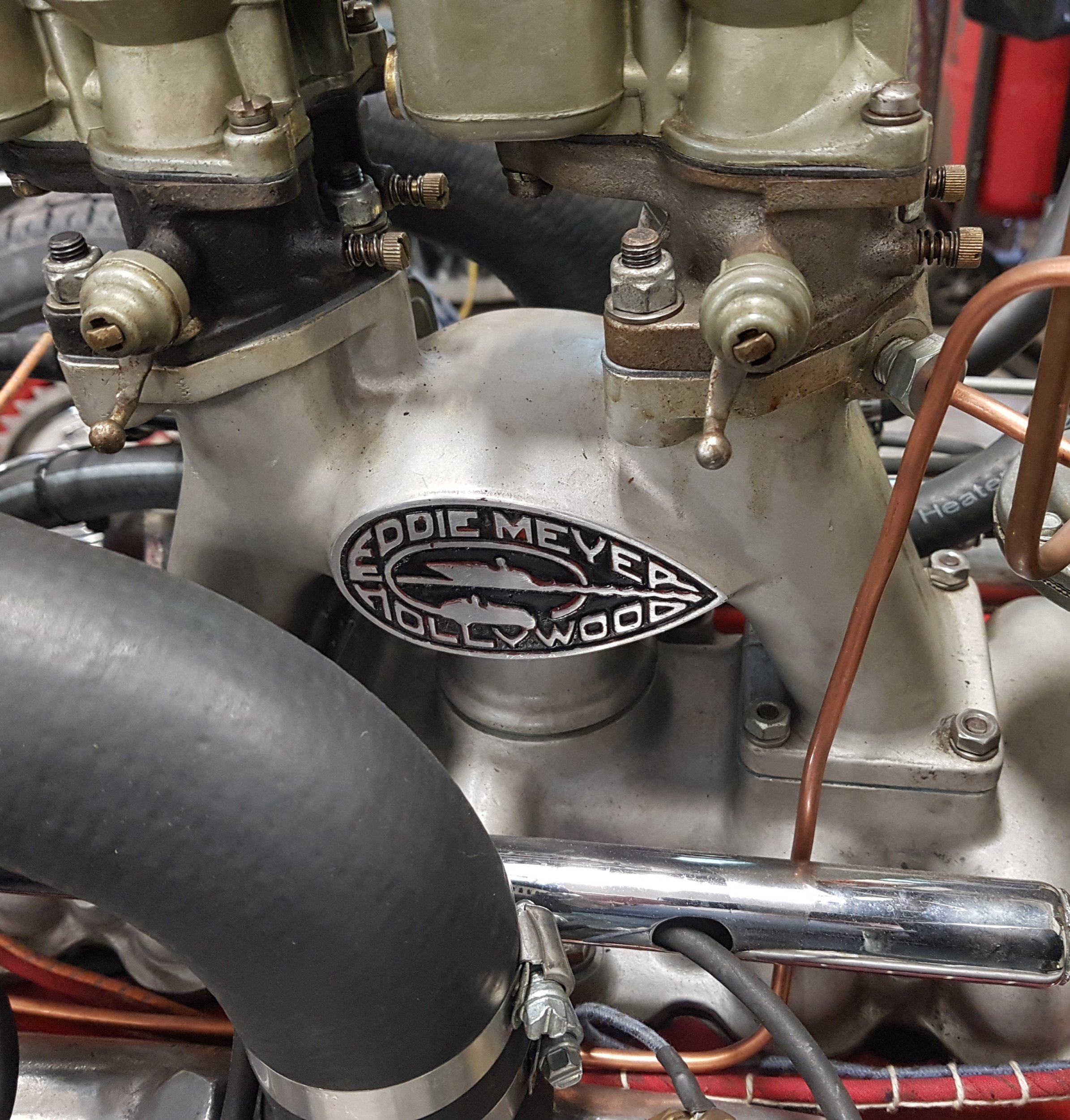

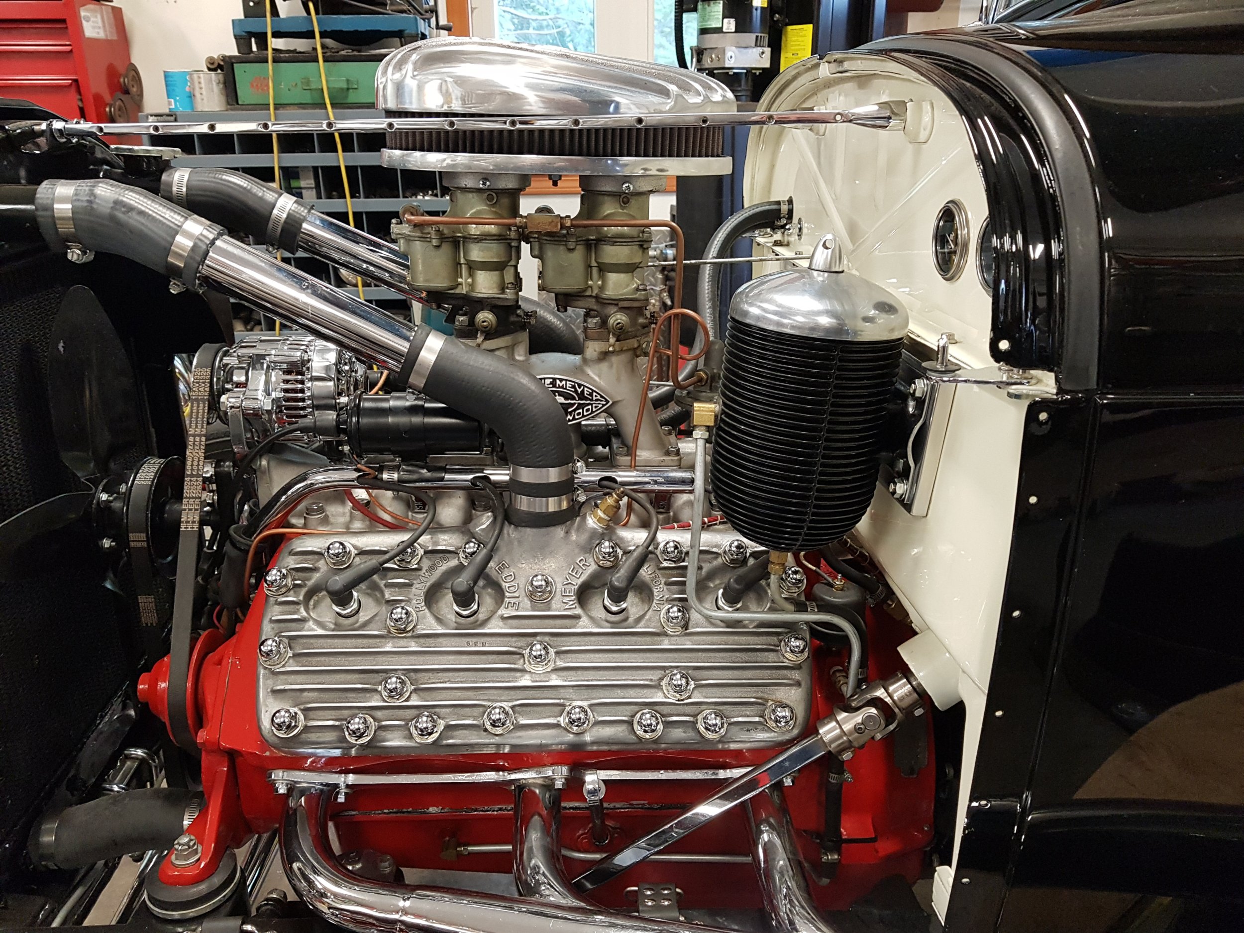

  18. banjorear
    Posts: 4,737
    banjorear
    The intake in question is pictured in my avatar. I'll try to get better pictures. It's a two piece design and has a provision to allow hot water from the cooling system to circulate (send and return) around the top carburetor base. When racing, there were block off plates so you could remove this heating from the system.
    I guess the thought was that when running your gow job at Muroc or El Mirage, carb heat wasn't needed. If you ran on the street, there was a provision to add heat if you wanted.
    Later on, they just added heat to their post-war version of their two piece intake seen in the pictures above.

  24. banjorear
    Posts: 4,737
    banjorear
    Yes. The center "leg" of your top is mated to the base which is open to provide heat from the two small center ports on the block. The Eddie Meyer that Ryan and I have does not have that. Look at the picture for my Avatar, you'll see what I mean.
