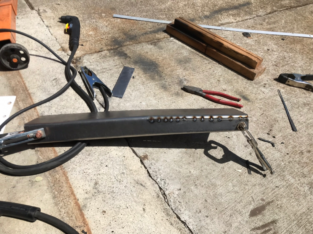

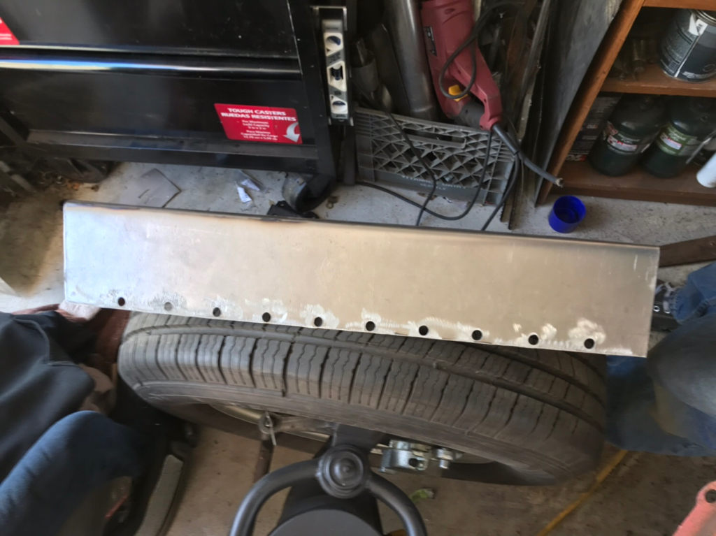

    I got one chunk done today. Bent a “J” channel out 18 gauge. Made a little pie cut because the rocker tapers at the front.
    Ground it smooth and drilled some holes to spot weld it to the outer rocker.
    So far so good. Need to make up a mount now.

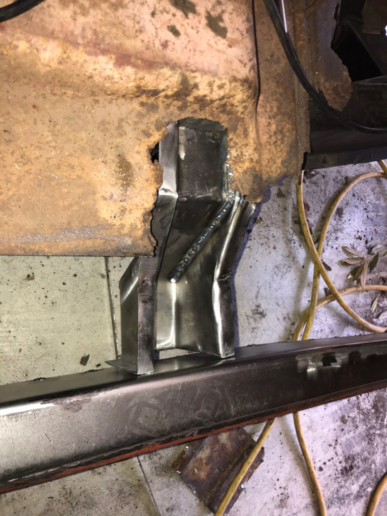

    Got the front body mount made today. Spent just as much time figuring out the pattern as I did making it. Quite a bit of hammer and dolly work left.
