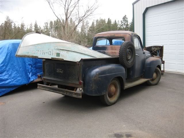

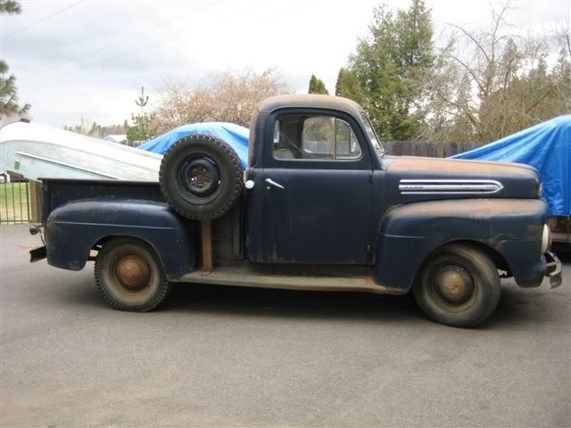

    I finally get to see these !
    That is a great looking original truck, I wouldn't touch it at all, if anything drop it a bit via an axle and bit of leaf spring work then leave it alone, especially if it's a flat head V8...

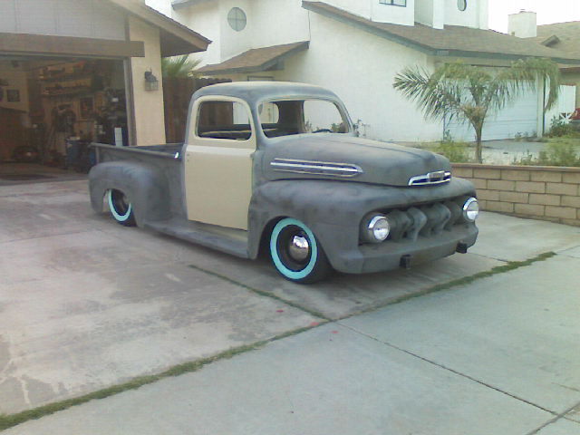

    Sanford, Thought you might have done some suspension mods. Then I saw the ditch you put the front tires in!!!!!!! LOVE IT!!! 0603081937.jpg
