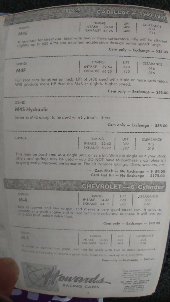

  3. Hope this is readable....

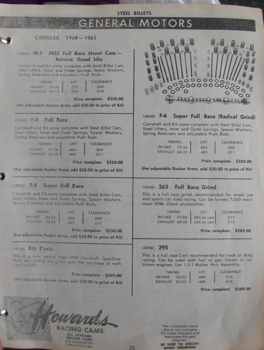

  7. Here is the steel billet page, no M-4 as they start at M-5 :confused:
    Countn'Carbs and Hank37 like this.
  8. Looked at cam again It's stamped Howards M-4 , could be made back in early 50's . Cam is not a steel billet .
