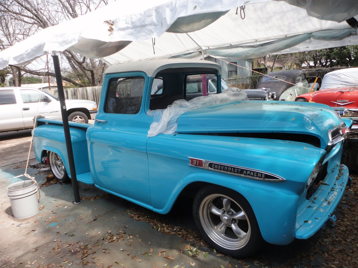

    I use this- this is the only pic I have. It's 10x20, (12x22 would be much better, even 12x20), but it works just fine. Used clear plastic sheeting, and cheap shower curtain rings (reinforced the holes with duct tape). The brand is Shelter Logic, bought it off of Amazon or Home Depot, had it delivered to the house, cost less than $200.00, has endured two years of constant Texas sun and wind, although a bad windstorm hurt it enough for me to glue sign banner material over it. Now it weighs more, but is much heavier duty. And the sigh banner stuff is cheap on-line too. And now you can hang LED lights and blind yourself.

    Well done. Now if I only had a garage that big.
