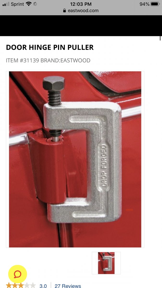

    If you do can you pull the hinge pins and pull the front of the door out or forward far enough to unhook the back?
    I saw you mentioned you had new check straps, don’t know if those are too short to try....

    With what probably broke in the latch mechanism your most likely going to have remove hinge pins anyway just to open the door and fix the latch.

    Agreed, If you're going to have to pop the driver side pins to get the door open to do the latch repairs, have at it. At least the 32 is at home.

  28. That is what I said. I think the door straps will not be an issue. If the doors have never been off, it may need heat and that is a problem.
