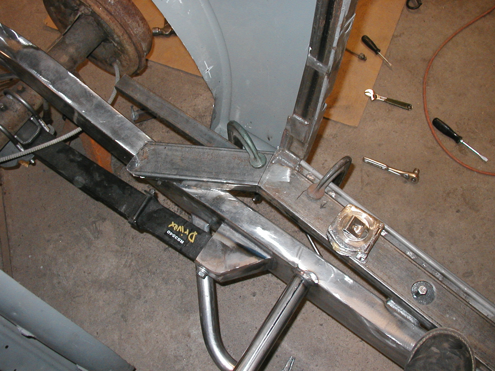

  3. Been there done that. In fact my current 32 has them on it. What I've learned is to box the complete rear half of the frame and run a soft spring. The distance from last crossmember to end of rail is a long way and without boxing the rail brakes off at the last rivet hole. Be sure to box inside the crossmember at the rail. I used chassis eng. 33/34 Ford springs and built my own brackets to fit. Rides nice and Cheep by comparison to 4 bar or other stuff. Here are some photos of them on a 34 Chevy. Don't have any on the 32.
