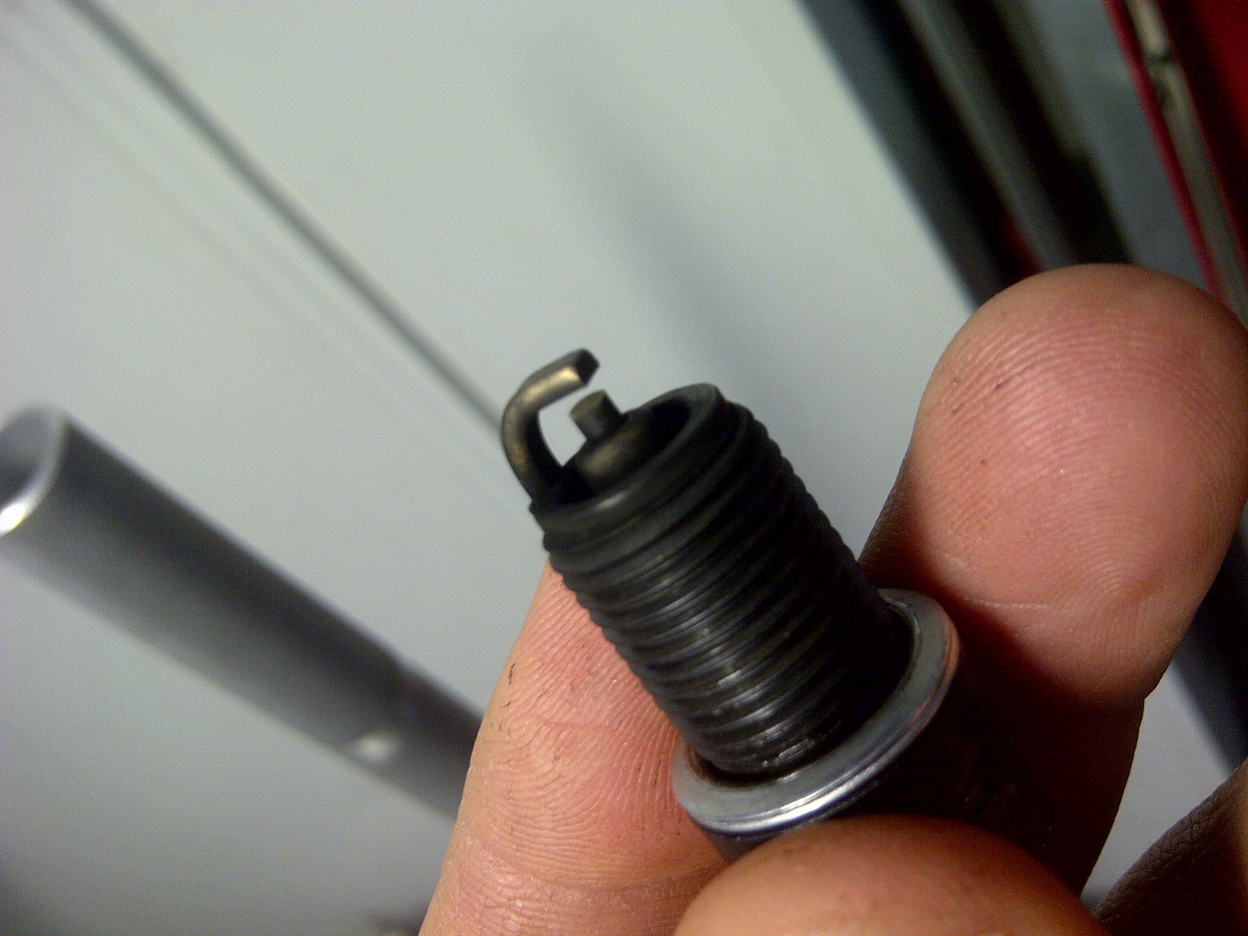

  6. 55Thunderboy
    Joined: Mar 27, 2009
    Posts: 358
    55Thunderboy
    from NYC
    guys here is a photo of a sparkplug from cylinder 1, i am running Autolite 3924 these may not be the best plug for this but i don't know.
    what do you guys think?
  7. Fiddytree
    Joined: Sep 7, 2008
    Posts: 204
    Fiddytree
    from Durango
    Wow, a little rich?

  9. big duece
    Joined: Jul 28, 2008
    Posts: 6,734
    big duece
    from kansas
    Sounds like the idle jets too big, and the mains are good if it screams after 3k. IF they are IDA's, what size chokes are in? 37mm or 40mm?
