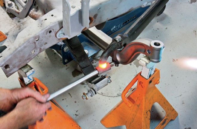

    Thanks for explaining the spring hangers guys. I'm not full bottle on all the differences of these I beam front ends so it made me stop and wonder.
    I've dummied it up on the frame and the hangers do need to be heated and moved to allow for where the joints will be mounted on the x frame. This pic is from the CE frontend upgrade: 1940-ford-pickup-chassis-torch-re-aligning-wishbone-ends-with-transverse-leaf-eyes.jpg

    Yup, those are 35-36 wishbones.

    Andy
    I would not just bend the hangers. You are ending up with a changed mounting span for the spring. The hangers move in as the tubes move out. It is better to bend the tubes.
