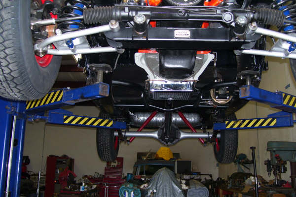

    We did a chassis for one using the orginal rails and x frame. There is a lot of shape in that frame in side profile and top view. The parts we used aren't exactly on topic but you can see the pictures here.

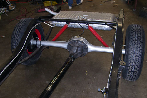

    Here are some pics of a 40 Chevy frame I repaired/modified. The car rides like a dream and drives like a pony car !
    Since these photos, we added a front stabilizer bar... made a world of difference in the handling.
    We added the read shock crossmember and the trans crossmember and surrounding stiffening structure. The M2 front suspension was probably the easiest part of the build. The Heidt's crossmember fell right into place.... very nice product !

    40 Chevy is a completely different animal.
