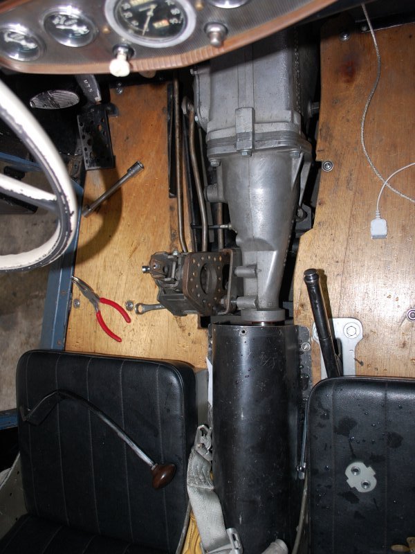

I succeeded in fabricating a center shifter for the Muncie tranny

    Anyway, since I certainly obtained the big hint from the Saginaw shifter I appreciate Weedburner very much.

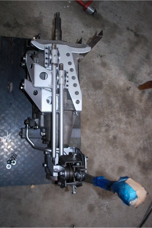

    I can see where the tight fit of linear bearings on the slide sections would require a swing mechanism. The original Saginaw version had long tubes for the rod guides which required a looser fit to allow for swing alignment. The Toploader version uses simple 1/8" long holes in the guide plates which can accomodate the swing and still maintain a tight fit. Much lighter than my original version too.
    To accomodate for the swing at the shift levers, i threaded fixed studs into the shift levers themselves. The part of the sliding rods that engages the shift lever studs have a vertical slot to allow for the arc as the shift levers move front/back from neutral. Same on both versions.

    If the stud is not used, I think that the Saginaw shifter of Weedburner was also functioned well.
    Incidentally, my shifter doesn't have the bearing.
    I attached linkage by the pin which the friend made, and the clip of Muncie without using a stud.
    A pin does not interfere with the movement of the linkage like a stud.
    And pendulum mechanism is more important for the top of a rod than a lever rather.
    The pendulum of a rod was made so that it could exchange easily, when it wore out.
    In fact, I had a different plan for center shifter.
    The shifter that my friend had designed had the quality of a formula car that used the rod and Heim Joint.
    And, reverse had a similar linkage to not the rod type but 1st - 2nd.
    However, Heim Joint deprives of the space for the gas pedal of tight model T.
    Therefore, I misappropriated the design of the shifter of Weedburner.
    I got the space for a gas pedal by flat pin and simple linkage.
    And, to drive the road of the snow, I need to cover tranny.
    Therefore, to give priority to the space of the gas pedal including the cover, I have
    improved this shifter. HaHa

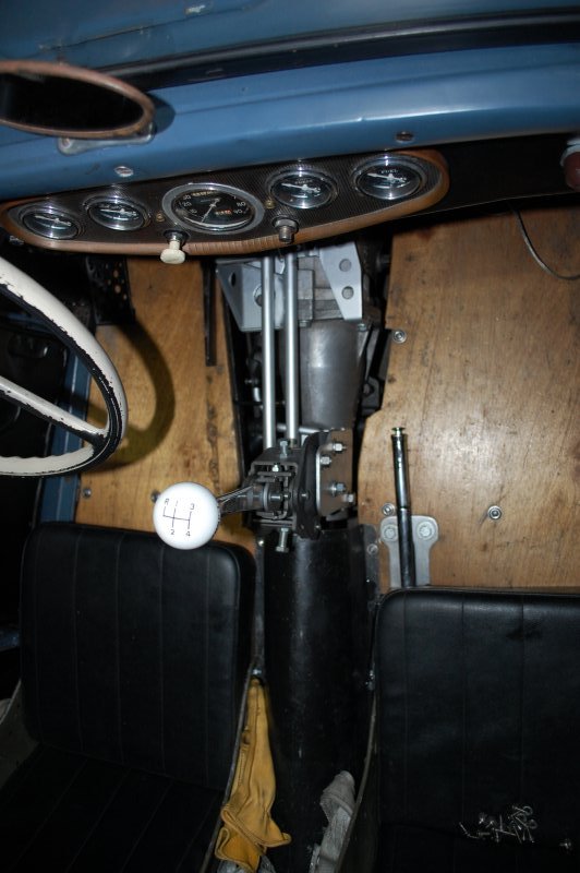

    Because the shifter was an obstructive protuberance my right leg was always uncomfortable.
    And linkage rod was also a troublesome protuberance.
    I did cut out the cover reluctantly, in order to step on gas pedal.
    However, because the linkage rod and the shifter had moved, wide space was secured.
    This structure is named Tano shifter. HAHA

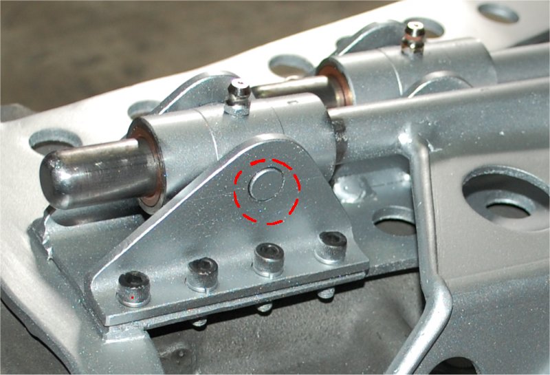

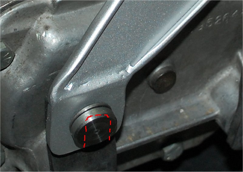

    The top of the rod swings 0.4 mm by the cam mechanism.
    The linkage lever does 0.2 mm slide up and down.
    And the shifter side can swing 0.2 mm by only the pin and the clip.

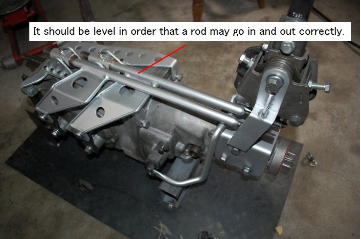

    Please set up the rod to the center surely.
    If it is not correct, you cannot adjust the rod.
  24. Tano
    Joined: May 3, 2010
    Posts: 85
    Tano
    from Japan
    It should be level in order that a rod may go in and out correctly.
    Please measure the range where the rod top and lever swing in your tranny.
    The shifter functions smoothly if the top and the joining section are faithfully built in those measurements.
