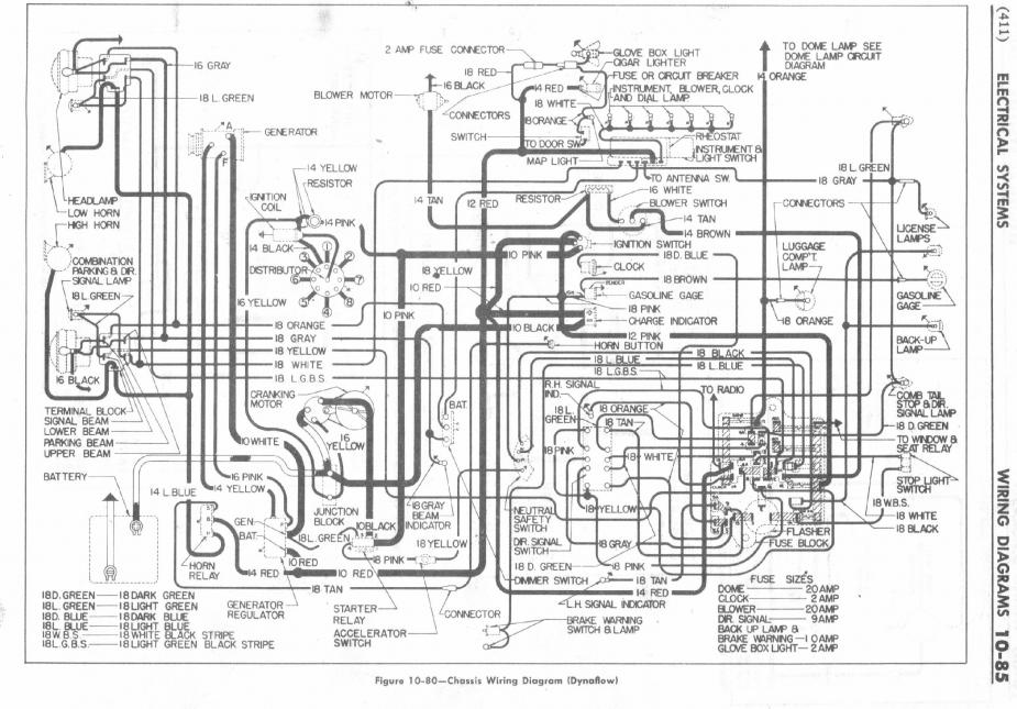

  8. Judd
    Joined: Feb 26, 2003
    Posts: 1,894
    Judd
    From the 56 Buick shop manual. If it won't open big enough pm me your e=mail and I'll send it.
  9. squirrel
    Joined: Sep 23, 2004
    Posts: 56,089
    squirrel
    The colors look different than normal GM stuff....but using the 56 wiring diagram and the instructions for the new harness, you should be able to figure it out.
  10. brewsir
    Joined: Mar 4, 2001
    Posts: 3,278
    brewsir
    That will work...Thank you all!!!
