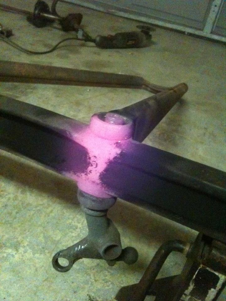

    Seriously though, a rosebud with a decent amount of gas flowing should get it hot enough.
    Since we can't see your technique over the interwebs it's hard to tell what you're doing.

    Ok that pic helped. What does the candle wax do? Mine wasn't near that hot. I heated the area up for a min or so then pounded then repeated. I'm gonna give it another go around tomorrow. Thanks guys.

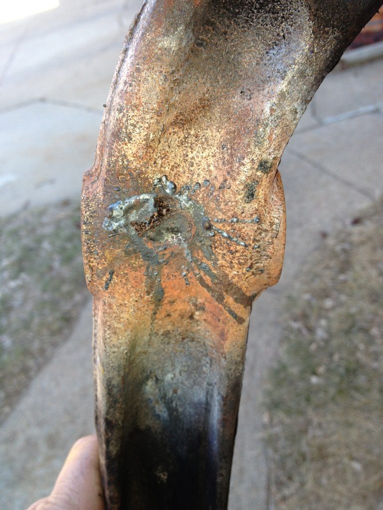

    I was successful at removing the perch. My only question now is is this bad? I got a bit to close to the axle and it splattered

    Yep, too hot!! Yowsers!! What kinda tip were you using?

    I used a rose bud tip. I was about 1/2 in away from the axle when it splattered. Will that harm the strength of the axle any?

    I'm no metallurgist but I'd guess so. Worse things have been run.
    We'd better get 38Chevy454's attention to this thread, he'd know for sure! :)

    no, i think you'll be alright, they'll take the heat, it doesnt look like you did much damage, lighting grind it, maybe use a 7018 rod (hard but flexable) and weld up the spot. and grind it smooth. just my .02
  29. Holy crap that axle was hot to do that .
    What was wrong with heating the bolt as hot as possible ( white) and stopping before the Axle turned red, let cool and repeat ? Like post # 14
    The damn things nearly fall out , well maybe they need a tap from someone's little sister but ...

    couldnt tell you if its still good. i wasnt there to watch but you would be supprised ad how many times you can heat something and its still good. did you check to see if it moved at all. most times when you do that it will shrink where you heated it. i would say take some measurements, pull a string line along it and see if when it shrunk it moved in any certain direction. clean it up and take another picture of it. if it looks straight and its made of steel you can probably just fill the pit with weld and buff it out.
