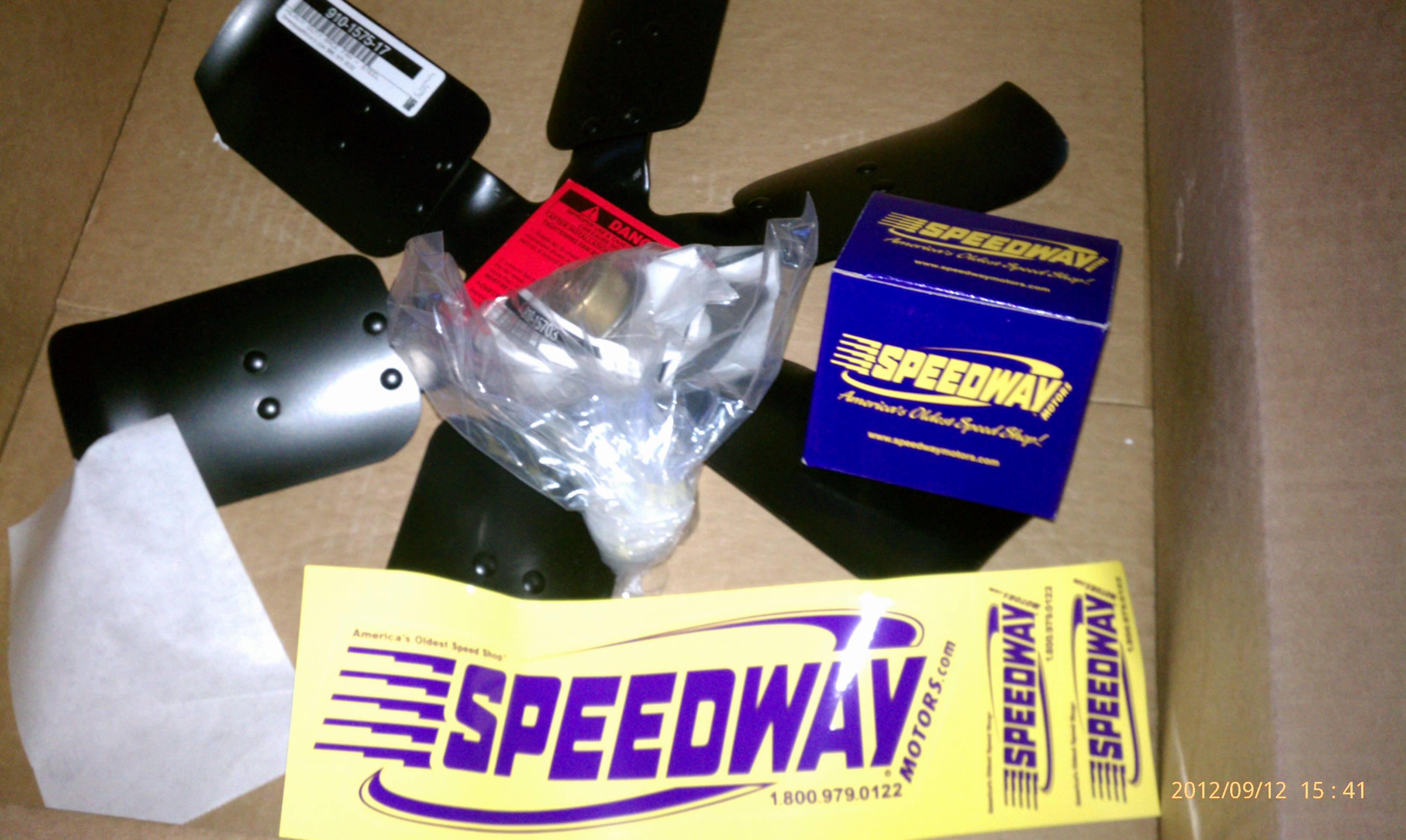

  4. mustang6147
    Joined: Feb 26, 2010
    Posts: 1,847
    mustang6147
    from Kent, Ohio
    The shroud, and aggressive 7 blade fan from Speedway. That was a game changer....I wish I could fit a clutch but room doesn't allow.... I still am shocked at how much of a difference the shroud I made, and proper installation, made in my truck.....
    A/C on, brass 2 core radiator, 85 degree day,,,, I am runnin 160 movin, and 170 in traffic..... I think I need to up my thermostat to a 180....

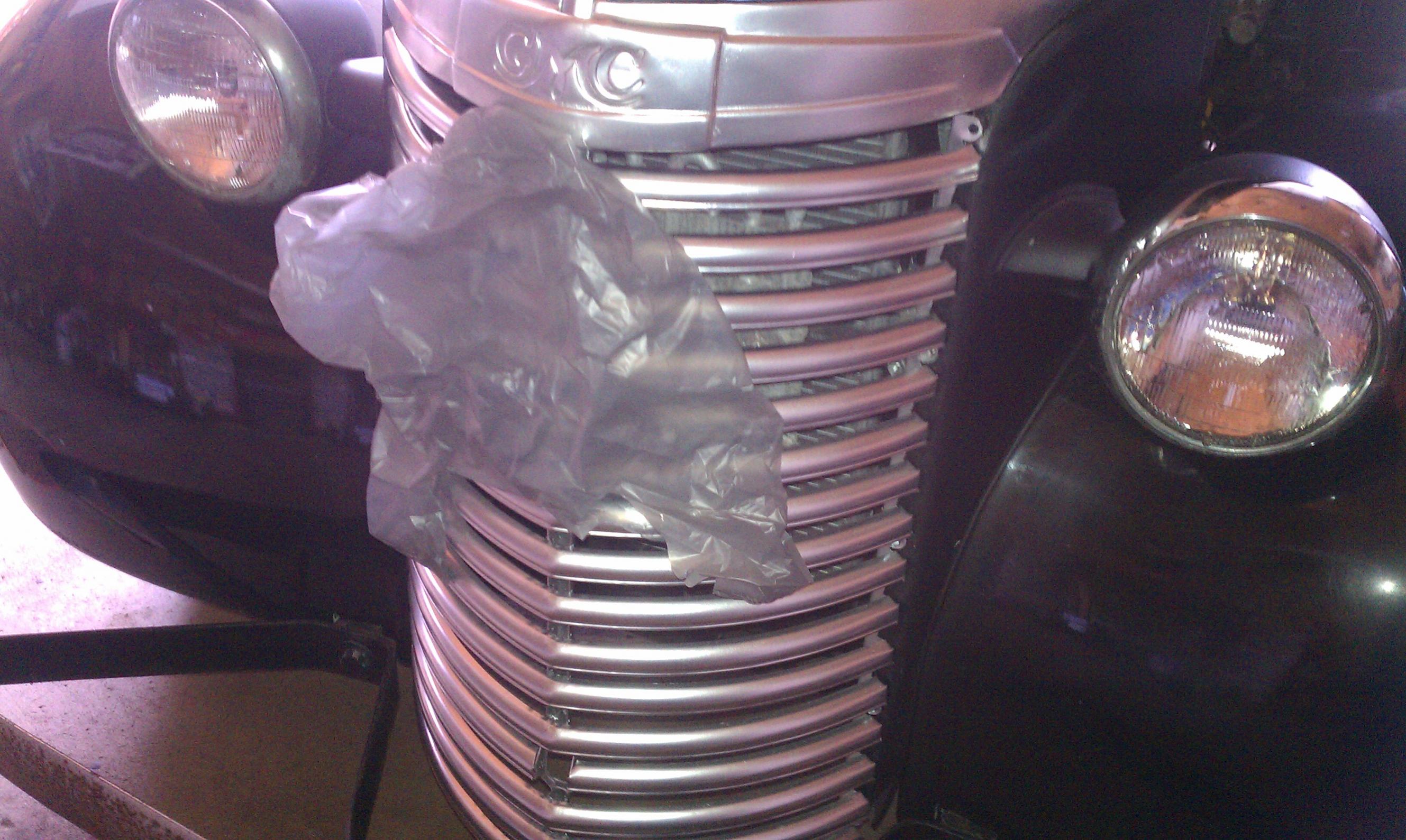

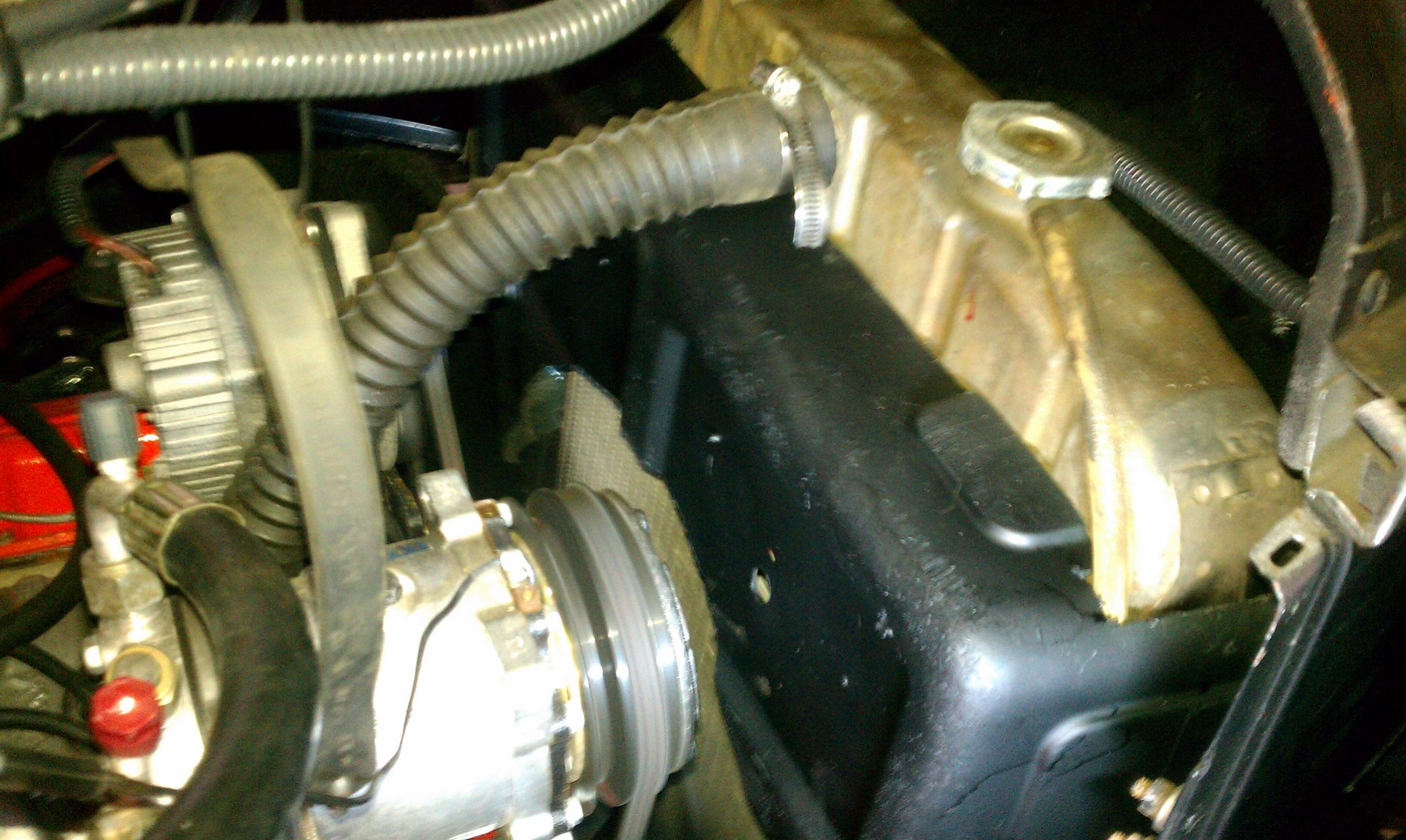

  6. CadillacKid
    Joined: Oct 15, 2002
    Posts: 1,507
    CadillacKid
    The radiator is a 4 core becool direct replacement for the Merc...and there's no shroud with this electric fan...it's just mounted directly in the middle of the radiator...the thermostat in the water pump is a 180 degree...

  8. CadillacKid
    Posts: 1,507
    CadillacKid
    And I checked the iarflow on the front of the radiator before shutting it down...it'll pull in a piece of paper towel, but only from about 2 inches away...

  12. Roger Walling
    Joined: Sep 26, 2010
    Posts: 1,149
    Roger Walling
    The location of the fan and the shroud is very important.
    The blades shoud be almost touching the shrowd and the center of the blades (when looking down) should be at the end of the shrowd. (1/2 inside and 1/2 behind the shrowd)

  14. mustang6147
    Posts: 1,847
    mustang6147
    from Kent, Ohio
    There is your problem..... Not enough air flow.... The radiator is plenty big.
    I cant remember if your runnin the 4 blade, or the electric. But I think your runnin the electric..... And it aint enough...
    Go to page 204 of Speedways catalog.... The fan that I am runnin is a
    910-1575-17.... and I made a shroud.... There are many threads on here, regarding home made shrouds out of steel garbage cans that look great.
    You simply aren't movin enough air....
    When I put the fan on, it made a big difference with the A/C on up to 85 degrees, but when I made the shroud, I was standing at least a foot in front of the grill and it felt like a breeze.... At 1000 rpms, I can suck a shopping bag out of the air against the grill which is 18 inches in front of the fan
  15. SoCal Merc
    Joined: Jul 26, 2007
    Posts: 572
    SoCal Merc
    from SoCal
    My friend's big block 65 El Camino ran hot. We went to an aluminum radiator, tried dual electric fans, Edelbrock high volume water pump, with no improvement. Put on a mechanical Flexlite plastic bladed fan and solved the problem.
