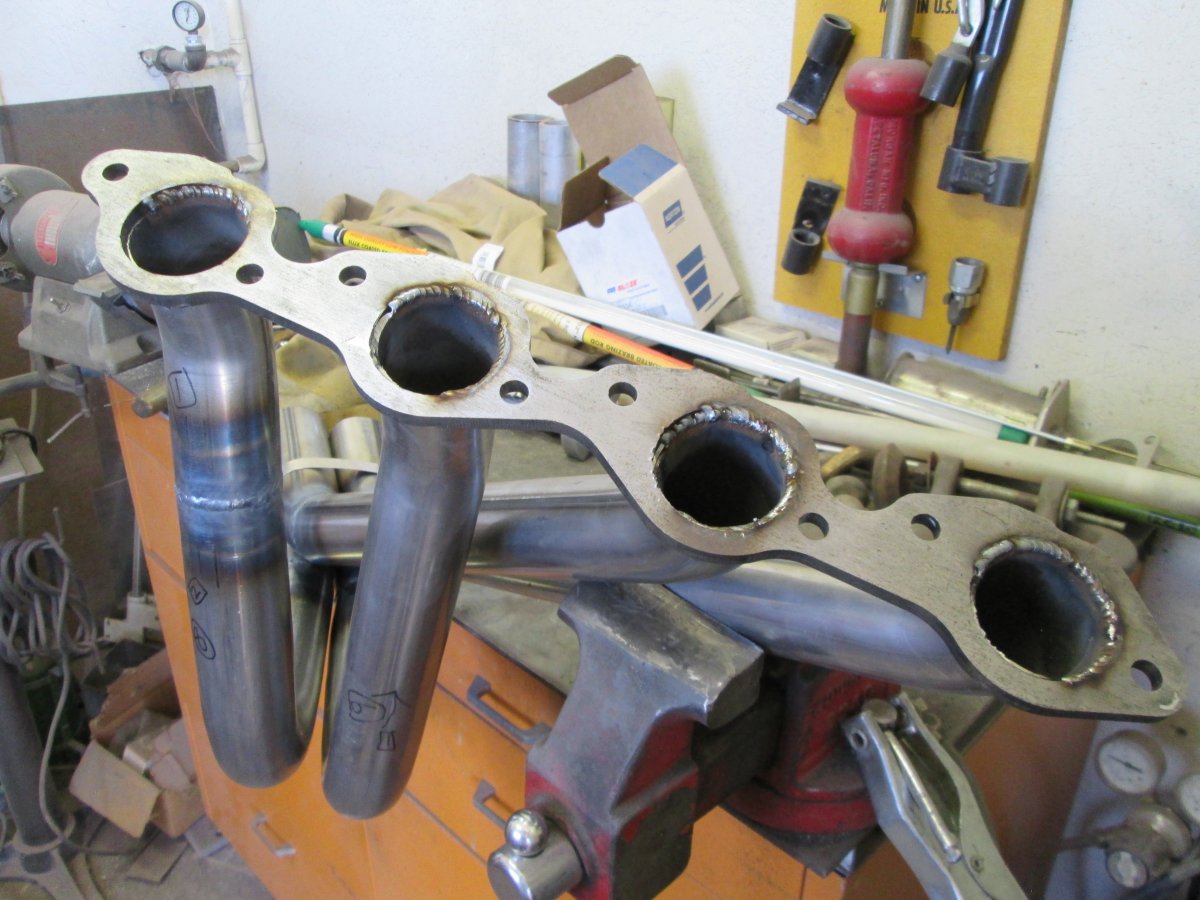

  4. Thinner flange material can benefit from the little bit of raised "ring" because it concentrates the clamping force on the high spots. A decently thick flange shouldn't need any band-aides.
  5. On production headers that always leak I have never understood why the raised weld bead didn't encompass the complete bolt hole so you actually got a good clamp force when tightening the bolts.
    I use or make 3/8" flange plates and just do an inside perimeter weld and a light dressing. No leaks.

    This is how I did the first set I made...I ground the flange flat, after welding. And then brazed the outer side of the tube/flange joint, to make damn sure it would not leak/break. They're doing fine

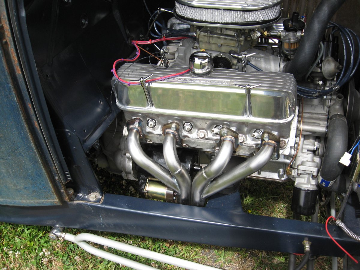

    I use 3/8" flanges, recess weld on the inside, and seal the outside with silicone bronze. IMG_7994.JPG
  12. Same here,
    3/8 flanges, filed flat on the gasket surface
    welded inside
    Brazed a fillet on the outside for support

    Store bought headers are typically assembled and welded in jigs, they stuff the tube through the flange and run a fillet weld around the protruding tube then surface grind it leaving the flat bead.
    When I build headers I bolt the flange to the head in the car, stick the starter tubes in as far as they can, then tack the starter tube to the flange. Then take the tacked together headers off to weld the flanges and bolt them to some loose heads to finish weld. This leaves the tube end flush with the inside of flange, and finish up pretty much like squirrel and others show and describe leaving the gasket surface flush and smooth.

    Ooohh, Marty! That's a beautiful 215!...or maybe the Cu. In. have been coaxed up a bit? I made a set of the individual flanges for my 215 Olds to build lakes headers. Working with just a hole saw or two and a die grinder with a 1/2" carbide cutter, it took a LOT of time to match up what I recall was a really odd-shaped exhaust port.
