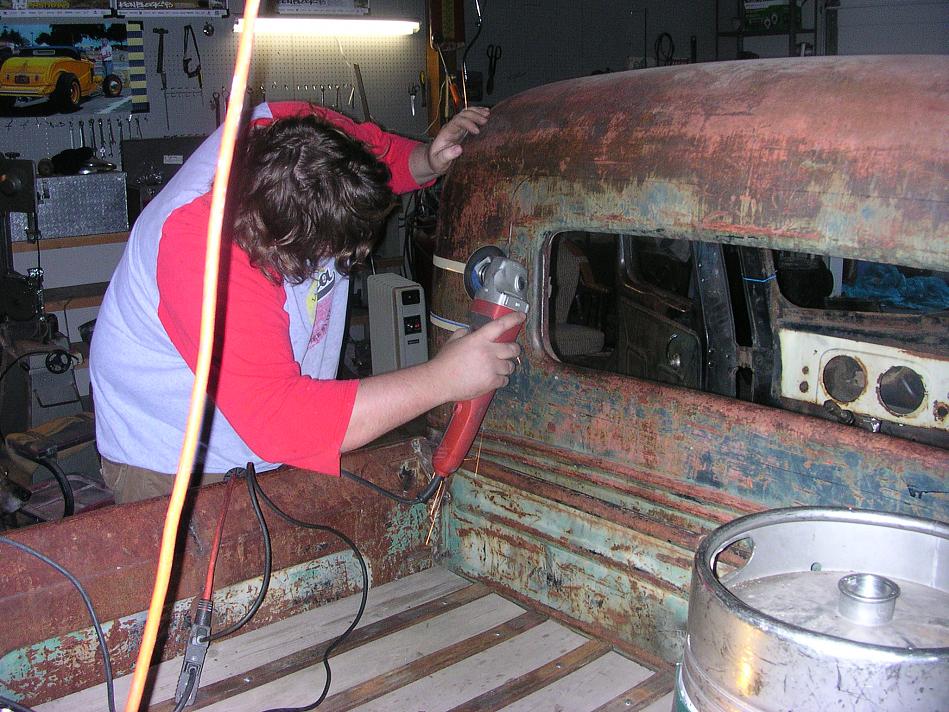

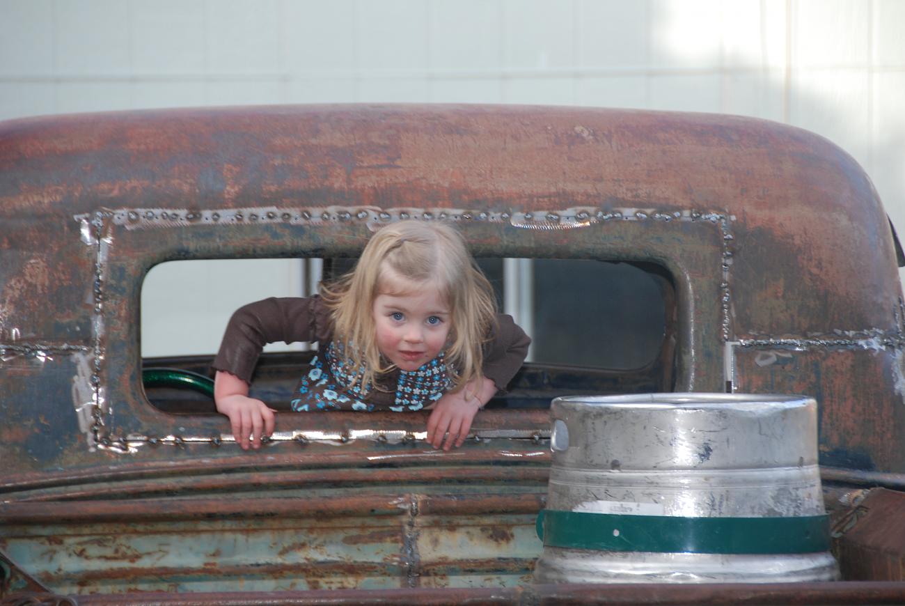

    I dig it too but if that beer keg looking thing is your gas tank you can do better than that
    Pls it just takes alot away from a cool rod IMO

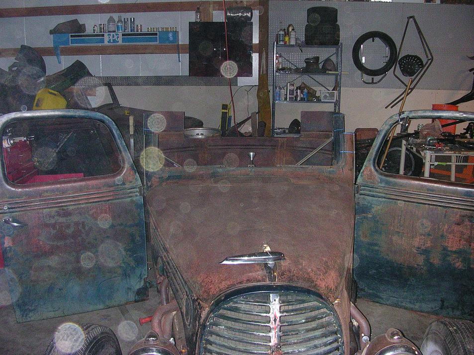

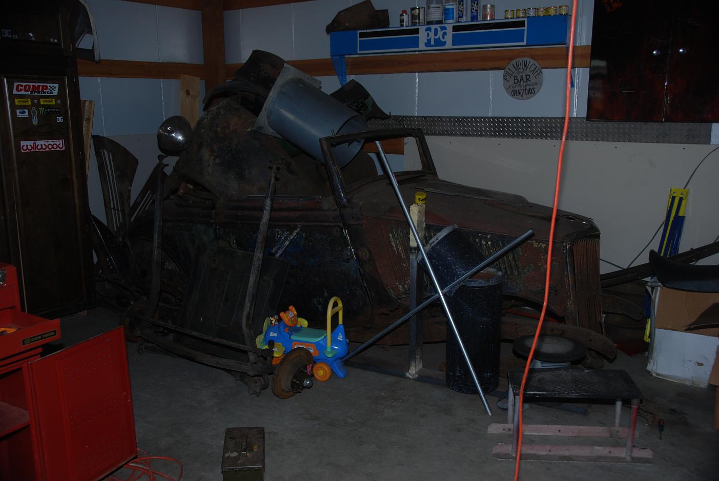

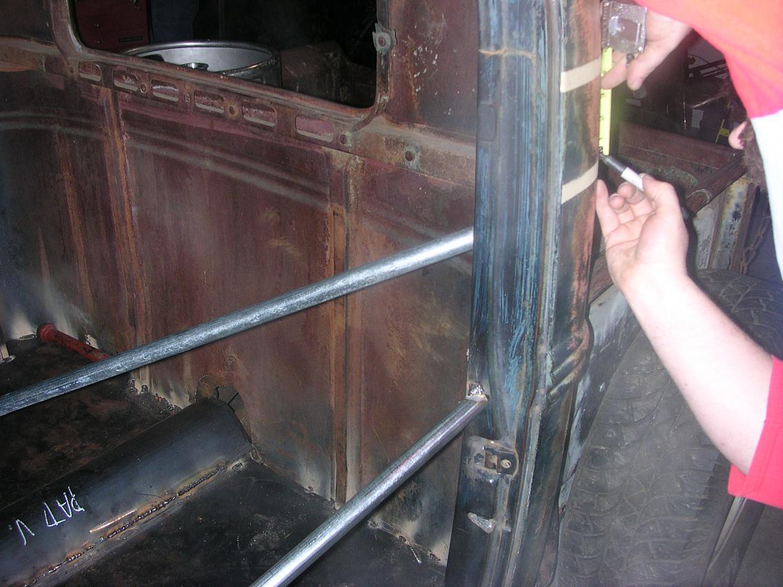

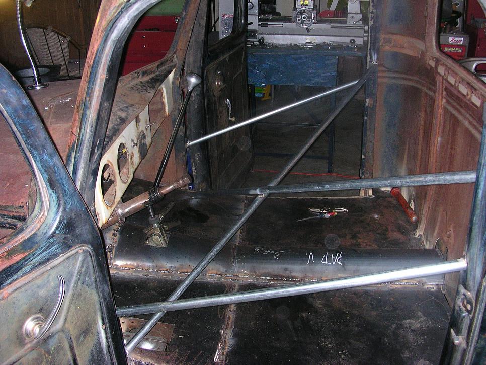

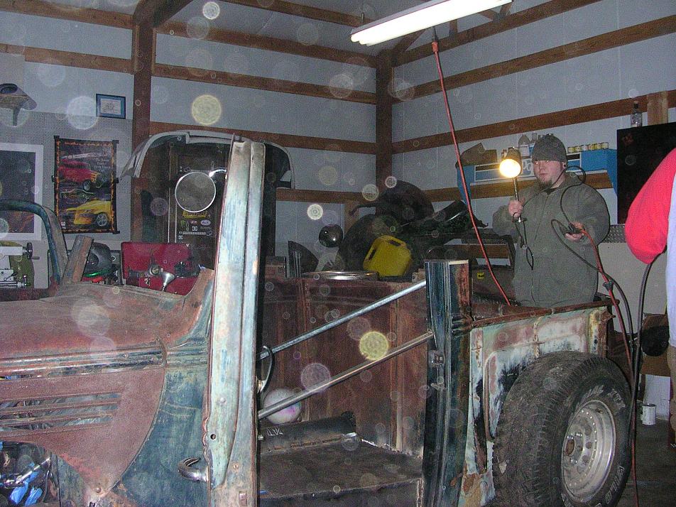

    Yes i think people are in a good mood. I have seen some of these post go bad. Maybe after I list the specs on the engine people will not be so nice Ha Ha But I am building what I can aford. And doing all the work my self and teaching my buddy a little. Any way here it is. 305 sbc 8.8 true trac Rear end 3.73 gears 67 checy c10 truck arms, th350, Canneled 7inch, Choped 4 1/2, Bed is 40 inches long, stock 112 inch wheelbase just moved forward not sure have much. And Yes first I am going to body work and paint the frame shiny black Candy green the split wish bones and axel. Then I am going to paint the dash and door panels candy green panel paint style (Gambino custums style) Hope it turns out half as good, mad props to alex and his crew. The body will be last probally not this summer I want to drive it for a summer. Front Tires are very old so I need to replace them 2. A photo shop would be cool with candy green steelies and white walls or aluminum slots with black walls not sure. Any way here are a few build pics.

    Truck looks great. I agree that you should work with what you can and have some fun doing it......Oh and I love the kid helping dad.....just like mine with their odd shoes and on the wrong feet! ha LMAO!

    Yes she is my little helper can't wait to build a hot rod or custom for her. Maybe a 51 chevy ? If we start it when she is 5 or 6 mybe it will be done for High school.
