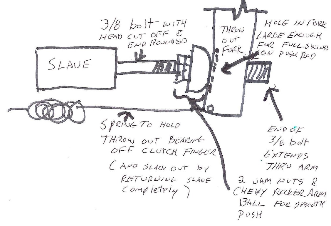

  5. Push the slave all the way in when adjusting, go for a little over a 1/16" clearance, be sure to put a spring on the throw-out arm, set the push-rod to master cyl clearance pretty close, when bleeding you may find the master cyl piston is slow on returning at first, give it time to fully return.

    Thank you, sir. Very helpful information indeed, including the sketch.
