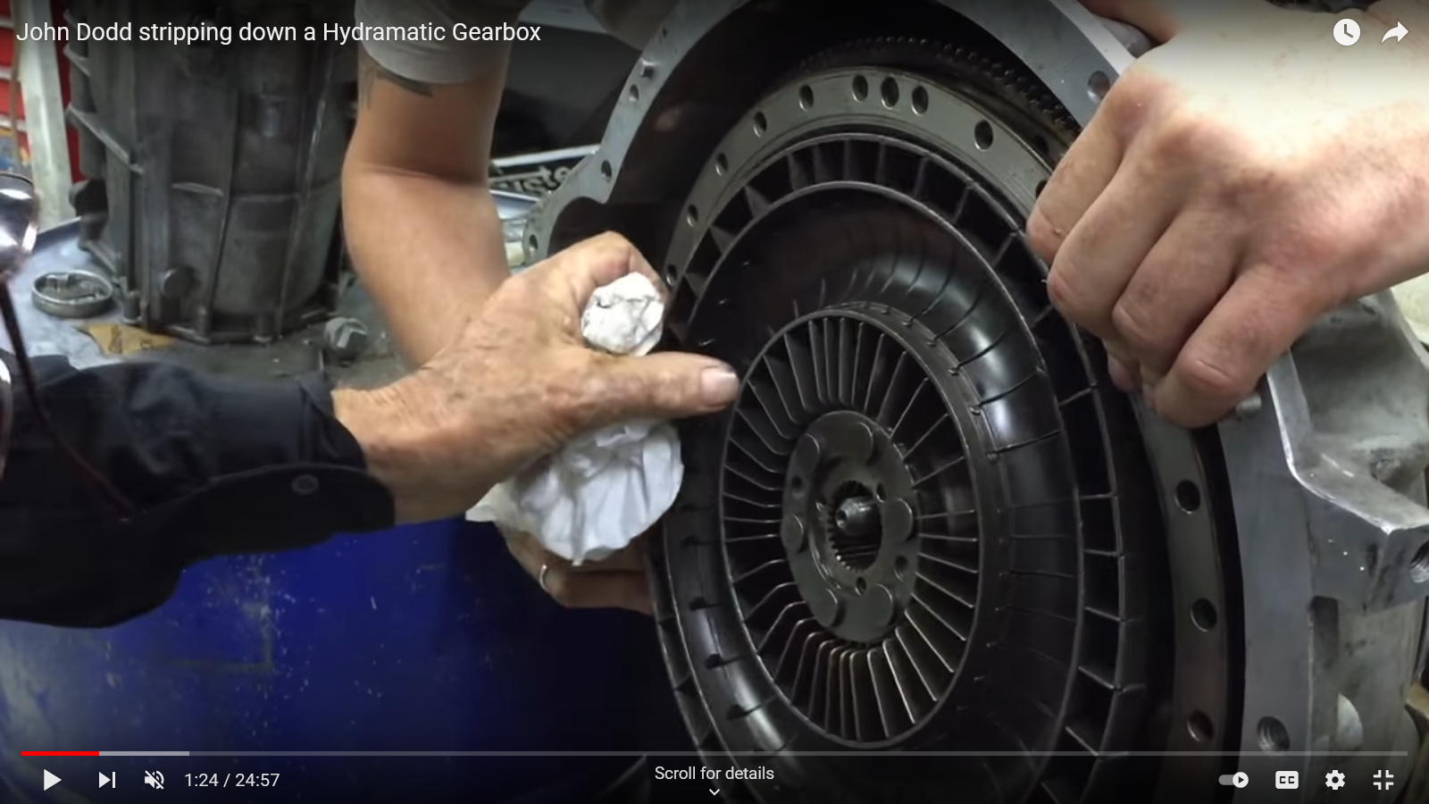

    From what I understand the height of the fins in the torus dictates stall speed and apparently per B&M literature that is true for both the drive & driven torus. My plan was to use the stock driven torus (picture Torus 3) and keep the B&M modified drive torus(Picture s-l1602) to lower the stall speed.

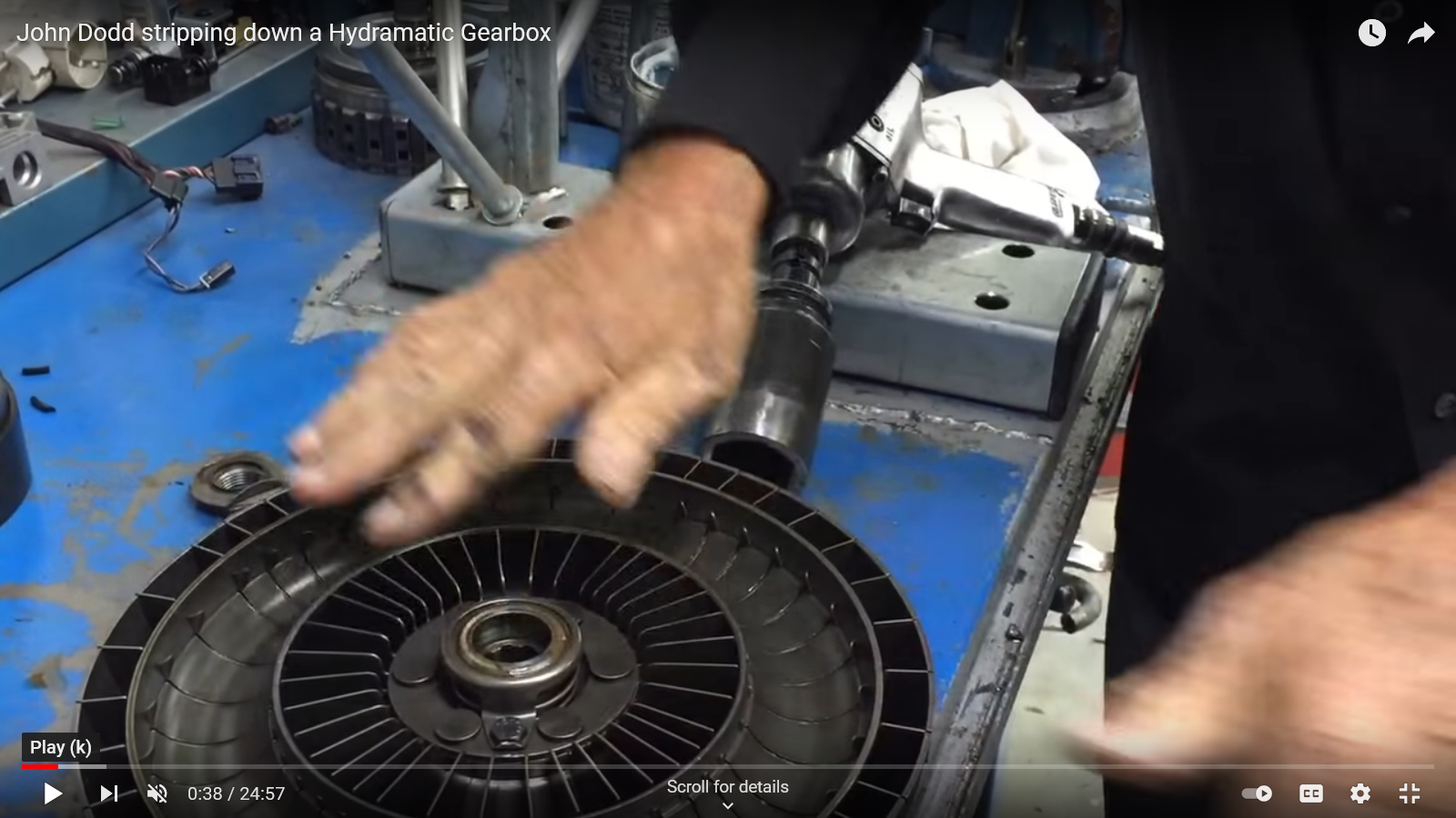

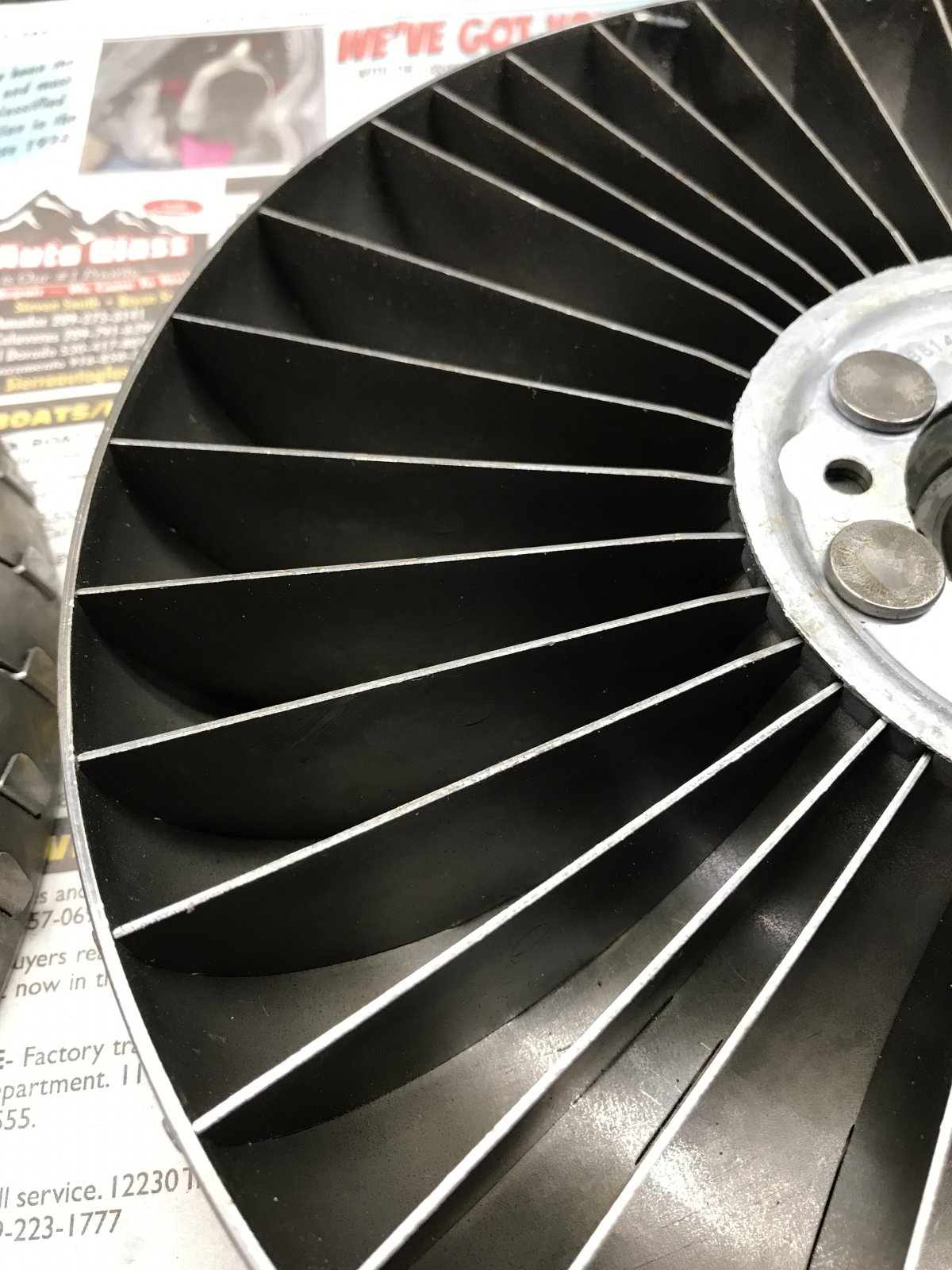

    Now for what has thrown me for a loop and prompted this post, while watching a rebuild video, the gentleman (John Dodd) working on a hydro that when he pulls the torus apart they both have shaved fins in the center just like my driven torus (picture torus 1 & 2). So what gives?? if I understand he concept of how the fluid coupling work and I believe I do. wouldn't this unit have an unbelievable high stall. I have also seen these no center finned torus in other videos and believe there are stock units.

  4. That excerpt from the B&M catalog in the first post tells what stall speed you can expect from trimmed tori. The page also warns caution in using anything but a stock set of wheels on a street driven vehicle. Hydros don't need cooling due to the efficiency of their tori design but when you tron them, the stall goes up as listed due to lots of slippage and concurrent fluid heating. Definitely don't ust two trimmed tori on anything but a race car.
    The tori with the 3 sections are from Olds, Pontiac, and othe passenger cars. The torus shown above with plain fins is from the Chevy tranny. The latter is the most desirable since it is a bit smaller diameter yielding a bit more stall speed without having to trim the vanes.
