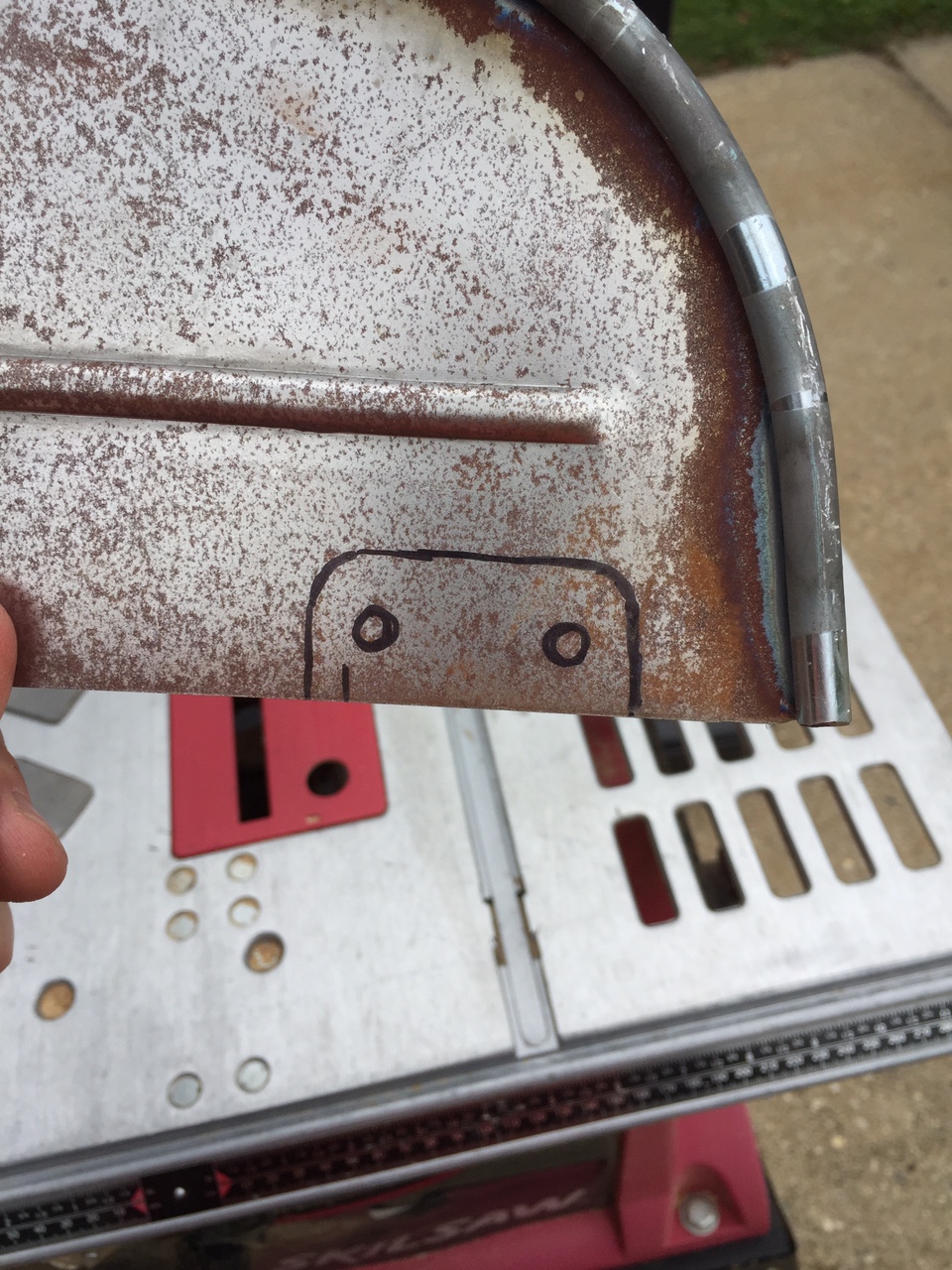

    Cut out all the pieces that make up my seat mounts today. Now I will drill a bunch of holes to put hot rivets through. The rear brackets hold cheapo door latches from speedway. The front brackets are to be sandwiched with a spacer then slide between two staggered L brackets that bolt to the floor. The L brackets will be welded to a small plate to retain the gap that the seat plates side into and one next to. I planed this out for strength and wear. So each seat has four front plates on it and four plates stick up from the floor for two bolts to go through. The front bracket are for the seats to flip forward. Hence the door latches in the rear.

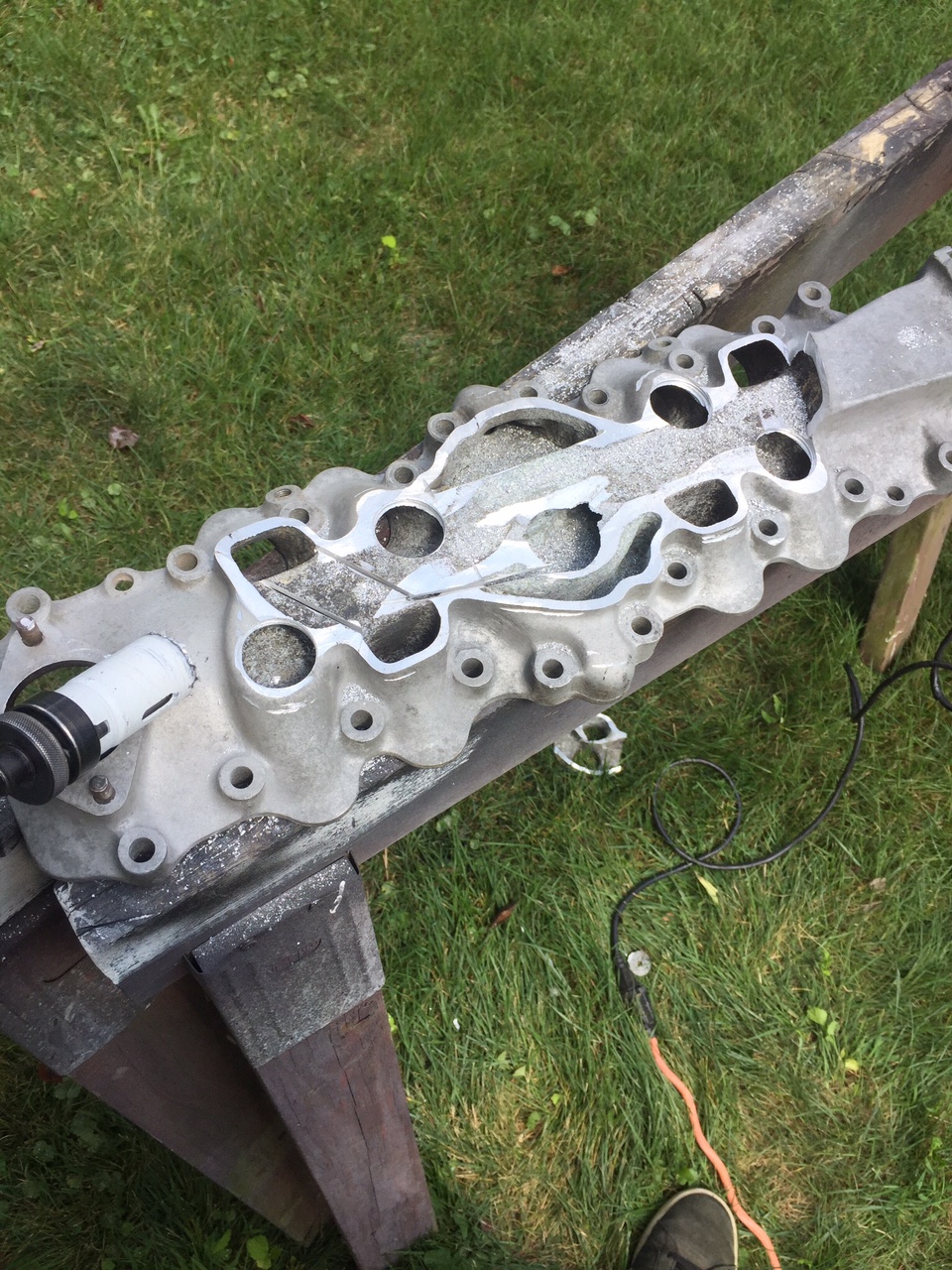

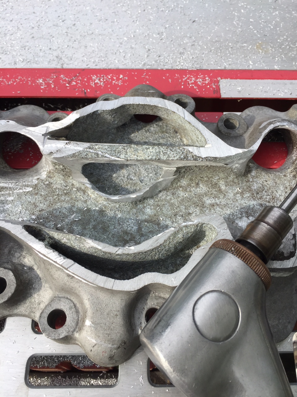

    I picked up a $20 something 40s Ford intake that somebody started to hack apart I believe to mount multiple carbs.
    I continued the process for different reasons.
    I slowly cut my way in.
    Drilled four ports of the lower plane to see where I was headed
    Roughed in some ports but lots to go still
    I will weld in flat stock to patch the front that opened up and this area in the middle to make the plenum more rectangular and seal the heat passage.
    I am ordering a big plate to weld after the top is milled flat and parallel to the base. I am figuring out where to place a pop off valve.
    The plan is to go with a 3-71 now. I missed getting one the other day. I have my eyes peeled.

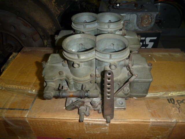

    Some of the later 94’s had larger venturi and throttle body bores. You can easily tell by looking down the throat of each casting to see a fractional number cast into the venturi body. A true 94 is 15/16”, while some of the y block carbs got up to 1 1/16” if I remember right. Dimensionally they are the same externally.
    chryslerfan55 and Runnin shine like this.
  17. ECG-6 casting is a 1 1/16". I'm sure there are others, I just know because it took me forever to find three solid cores with the ECG-6 casting for a project that has now gone a different direction :rolleyes:
  18. Runnin shine
    Joined: Apr 12, 2013
    Posts: 3,337
    Runnin shine
    I suppose 4 2110s at 840cfm is more than necessary. 640cfm should suffice. The first engine build is hopefully using the second 4” stroke crank I got not the one I started whittling on and plan to get offset ground.
    A point of interest. I see in bottom views of 2110s a clear jump from the larger 1 1/16 base down to the main carb body. I suspect the 94 and 2110 bodies are the same venture size. I know that cfm rate can go up with a throttle blade only size increase.

    That is really wild...I take it they are actually all separate still just machined to get them closer to centralize the fuel distribution...OR do they share fuel bowls...is that yours?
    I see only 1 linkage for all four...that must have taken some genius too orchestrate...there sure are some crafty Hoodlums...:D
