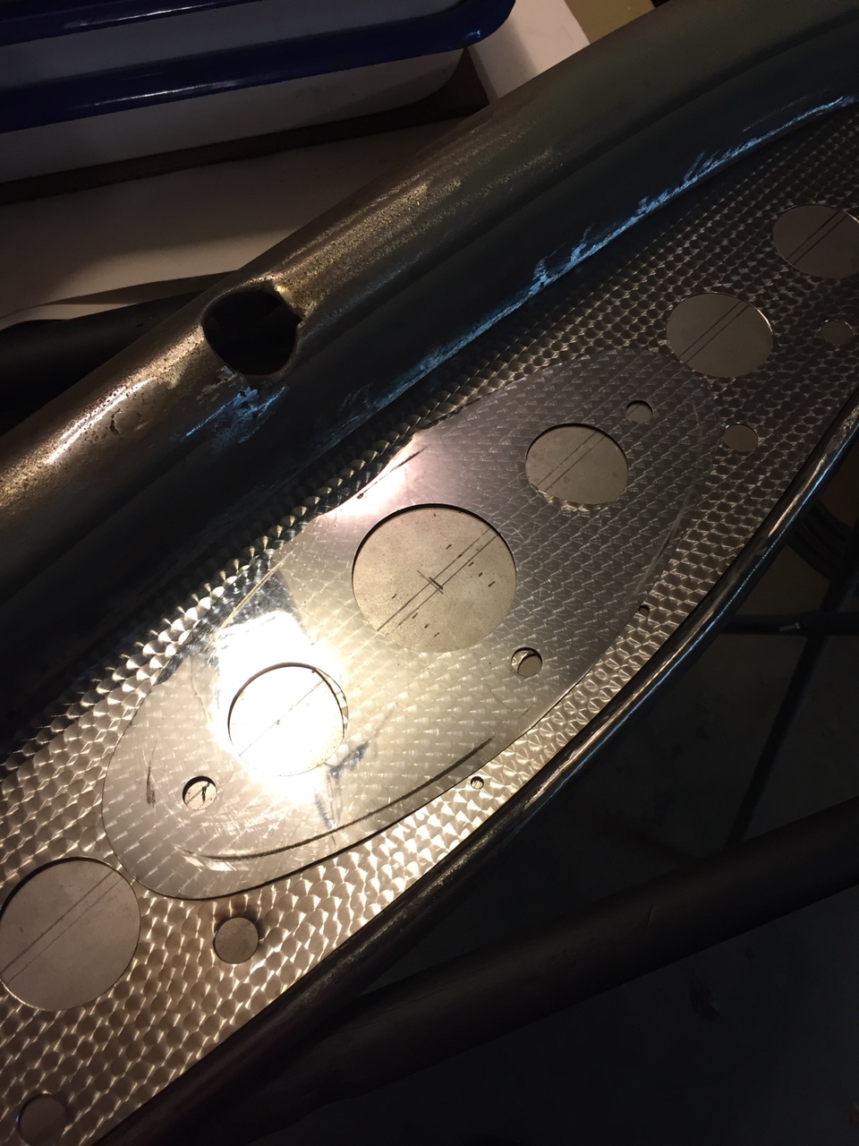

    My first thoughts would be to Mask the hole areas exceeding the hole size with tape and layout centers and drill pilot holes with 1/4" being a nominal start (or what ever size the pilot is and make sure the pilot hole is as close size to as possible...no slop)...engine turned side up. Protect the rest of engine turn area from swarf with heavy paper masked down. Use wood underneath to provide solid base for saw support. I guess you will be using bi metal saw. Perhaps some lubrication may help to. Rpm dunno Look up preferred stainless drilling speeds.
    Oh yeah clamp your dash so all is secure to prevent anything moving and clamp on excess areas. I guess sawing the dash to size is the next hurdle after that...:eek:
    If any swarf got under when cutting with the dash in reverse it would not be good. This all said is opinion #1...
    And remember your golden process from the beginning do a test run on your test pieces...1rst...;)

    The wood backer, masking, pilot hole, chuck itnin your drill press and make it spin!
    The bit not the dash hopefully lol.
    I’d cut the holes and trim everything before i tried getting it flat. Good chance you’d flatten it and then re warp it. This way you have to do it once.

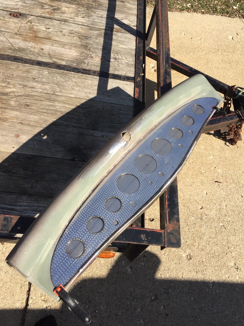

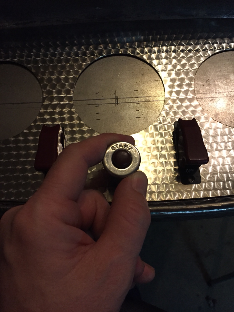

    I came up with this idea this morning to remove the paint off the part of the Mag switch that will stick through the dash and shiny insert. This was an effort to mimic the bezel on the speedo and tach that will stick through as well. I’m going to weld studs on the dash panel for them to tighten down to. Their attachment will be hidden by the stainless piece. All the smaller gauges and switches are hopefully going to hold the panel in place.
  6. Tim_with_a_T
    Joined: Apr 30, 2011
    Posts: 1,006
    Tim_with_a_T
    As far as drilling the holes for your gauges, I would do what was mentioned above (clamped workpiece, masking tape, wood board backer, pilot hole, lube depending on how it went on the test piece, and I would start the beginning cuts of the hole saw by hand turning your spindle if that makes sense. Maybe just superstition, but to me it seems to go better once I see a scribed circle before I fire the thing up at full speed and do the "no turning back" part of the job.
    Stogy, loudbang and Runnin shine like this.
  7. Runnin shine
    Joined: Apr 12, 2013
    Posts: 2,909
    Runnin shine

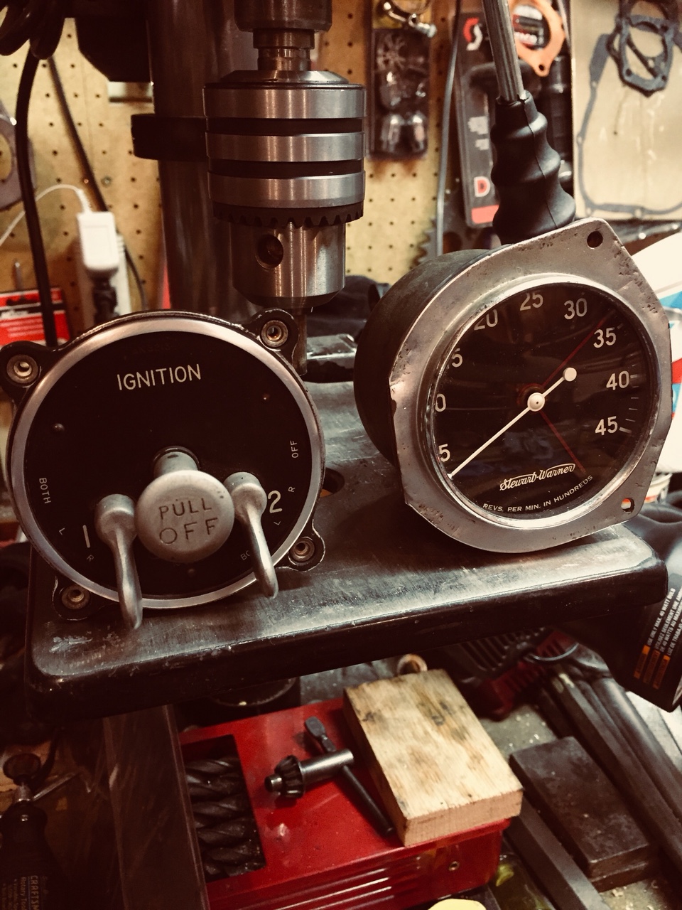

    Check this out, see you can’t even tell that the Mag switch isn’t a Stewart Warner unit now. Man I’m good at this stuff
    I have must of the holes safely done in the dash panel except for slowly opening them up final with porting tools(more flow?). It went well but I waisted a brand new 3” holesaw before I even finished the second of the 3 big center holes. I finished the last one with a dremmel cut-off wheel safely but I was nervous. Here’s a pic after I pulled that off.
    I did the holesawing in the drill press with everything thing clamped tight. The big holes really make my belts slip.
    Dang it I just deleted the pic with all holes. Until tomorrow then.
    spurgeonforge, Tuck, dumprat and 3 others like this.

    Of course I nicked it a couple times with the carbide bit. As a bonus if you zoom in you’ll see where I threw in a nice gouge from the cut-off wheel blade hold down. I’ve decided to listen to @Tim and just except my fallibility and chalk it up to hot rod authenticity. I fitted it a lot better after these to pics.
    Here’s the comparison with the machine finished piece I have
    Here’s a sneak peek or are all these pics sneak peeks?

    If there is a next time, stuff the hole saw with wet paper towels and turn it at the slowest speed you can- as you know, heat kills the bi-metal saws. And, sweet job!
