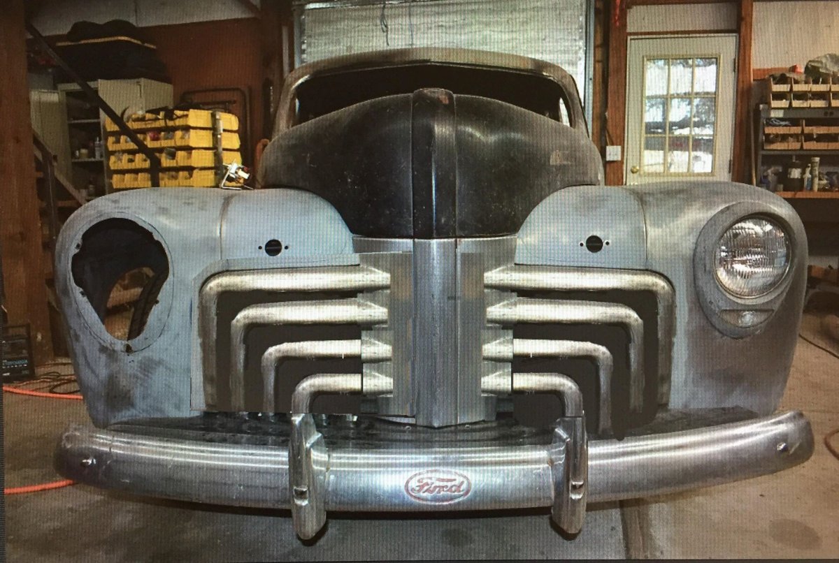

  12. straykatkustoms
    Joined: Oct 30, 2001
    Posts: 27,108
    straykatkustoms
    Hope ya don't mind I did a quickie, I like the Desoto but this one is sure making me think twice. Love your project.

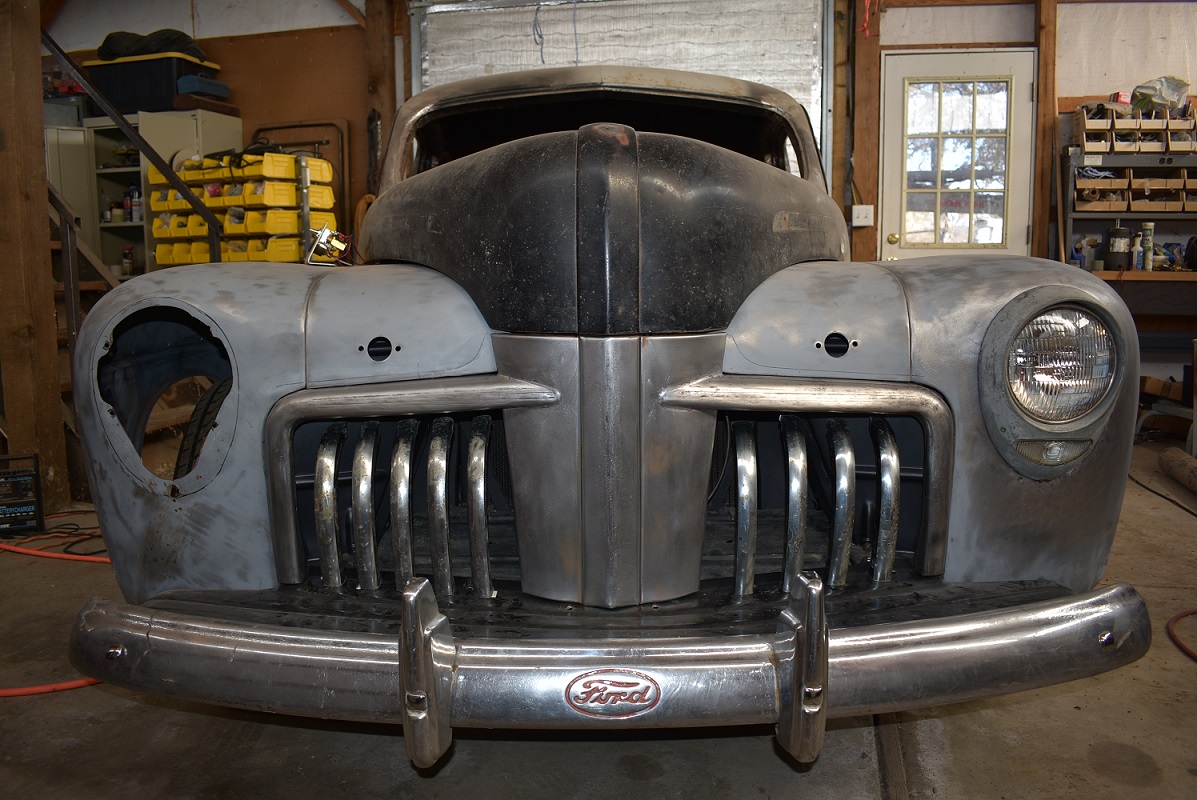

    I decided not to use the gravel pan since I like the look of exposed bumper brackets. So I used the gravel pan to make a chin panel and blend everything together. I decided on horizontal grill bars instead of the vertical teeth. I think the horizontal bars will fit the look I'm going for better. Still need to do some fine tuning and make the bumper bracket openings in the chin panel. 20250107_122928.jpg 20250107_140306.jpg 20250110_144935.jpg 20250111_160256.jpg 20250111_160320.jpg

    DSC_0003m.jpg DSC_0005m.jpg DSC_0011m.jpg DSC_0014m.jpg Drove up and down the driveway and got some outdoor photos. Grill bars are next.
