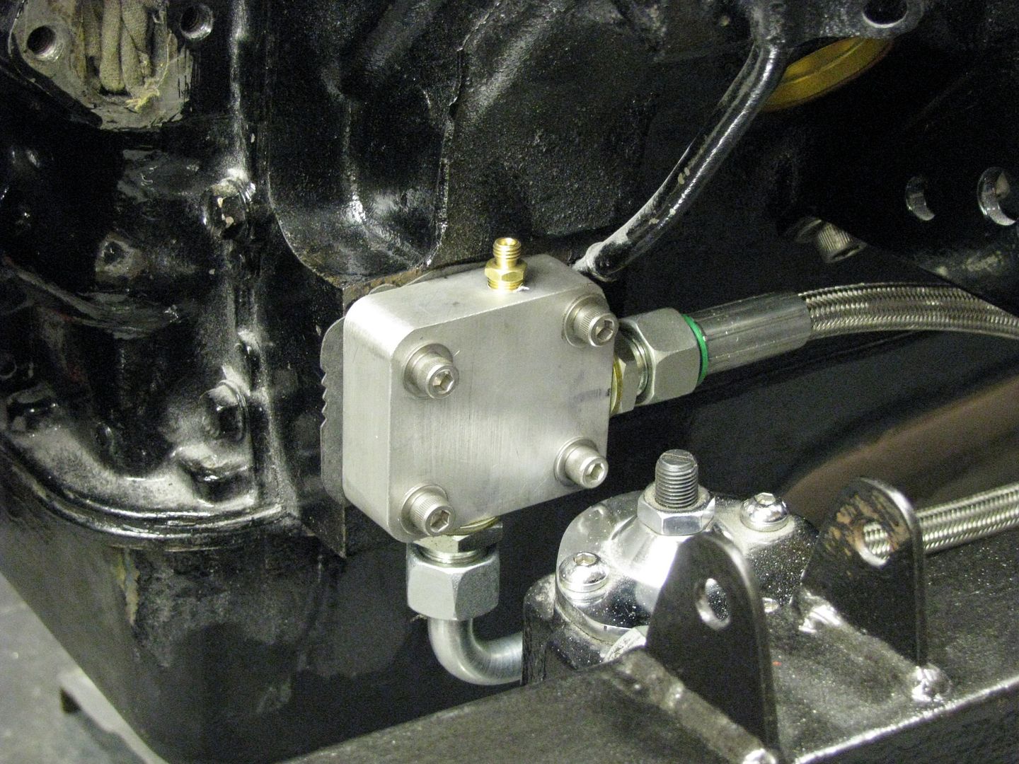

    The one Morrisman made (Great work & idea, but I have neither the tooling nor the skills..), and whatever 30dodgeboy have set me thinking about an oil pump cover instead of an adapter. If I could get rid of the whole top piece of the pump with the pad for the filter that would get me a lot more room.
    It looks like- failing finding the factory piece 30dodge mentioned above- Milodon makes something that sounds like the right thing, but I haven't been able to find any pics of the actual part online, and they make several things that sound like they might work (Milodon #21210 is one that sounds likely).
    Has anybody ever seen the Milodon oil pump cover up close?

    Check this Moparts link:
    http://board.moparts.org/ubbthreads/showflat.php?Cat=0&Number=5764048&Main=5763725

    I looked at that Moparts thread above and have sent an email to AndyF who made the cover pictured.
    That sure looks like what I had in mind, though it would be more useful for me if the ports came off the back side toward the rear of the engine.

    If they come out of the back side will they hit your mounts?
  27. Metalix 421just like that.

    Yeah, After I typed that I printed out the pic and took it out to the garage and realized the motor mount would be an issue. That big (an-12?) fitting he has sure sticks out a long way though.
