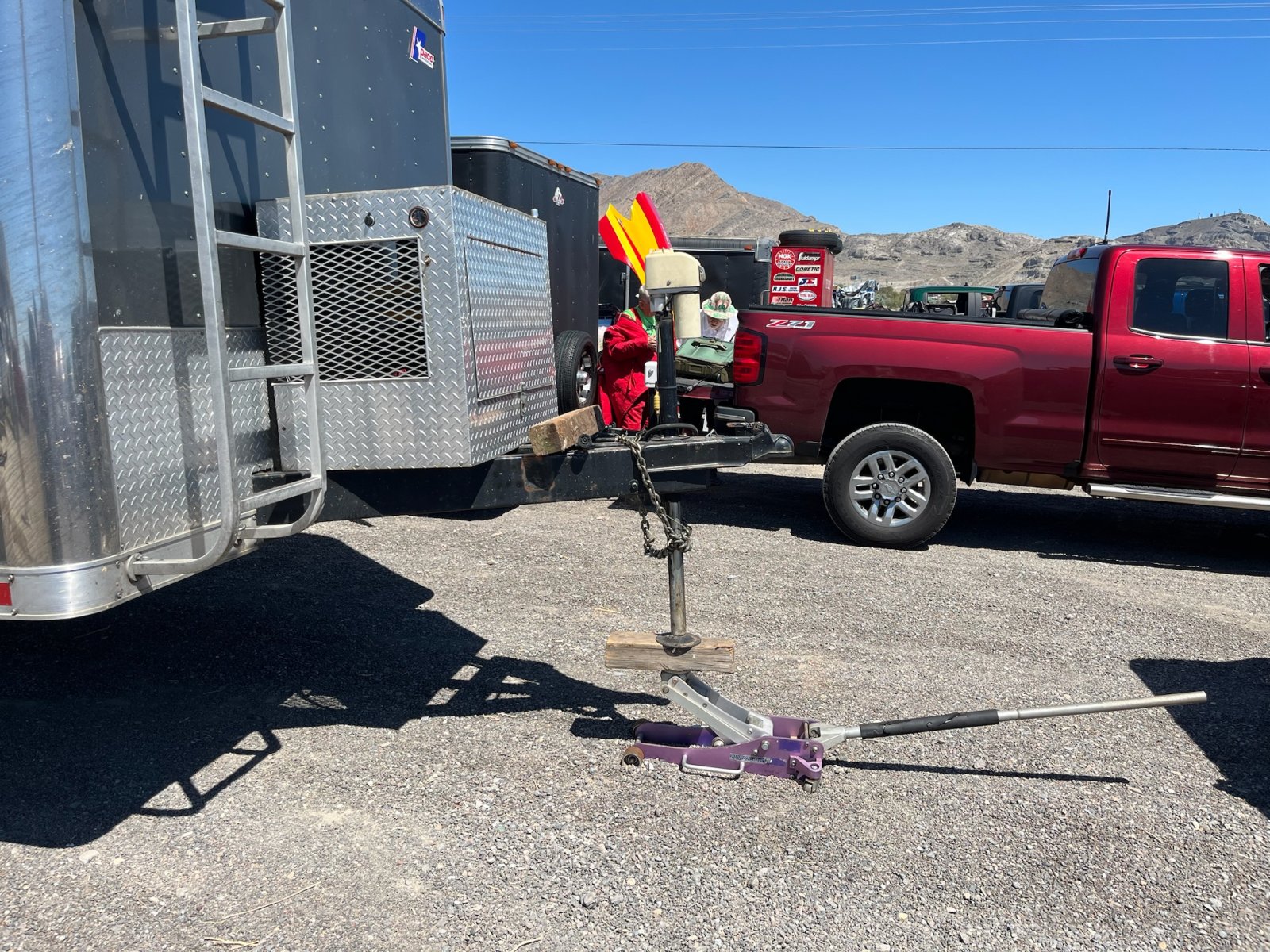

  16. Almostdone
    Joined: Dec 19, 2019
    Posts: 984
    Almostdone
    This worked for a team at Speed Week this year. What could go wrong? They were at tech inspection if you can believe it.
    John
    bulletpruf likes this.
  17. bulletpruf
    Joined: Apr 15, 2012
    Posts: 247
    bulletpruf
    That's pretty sketchy, but I have seen worse.
    Thanks

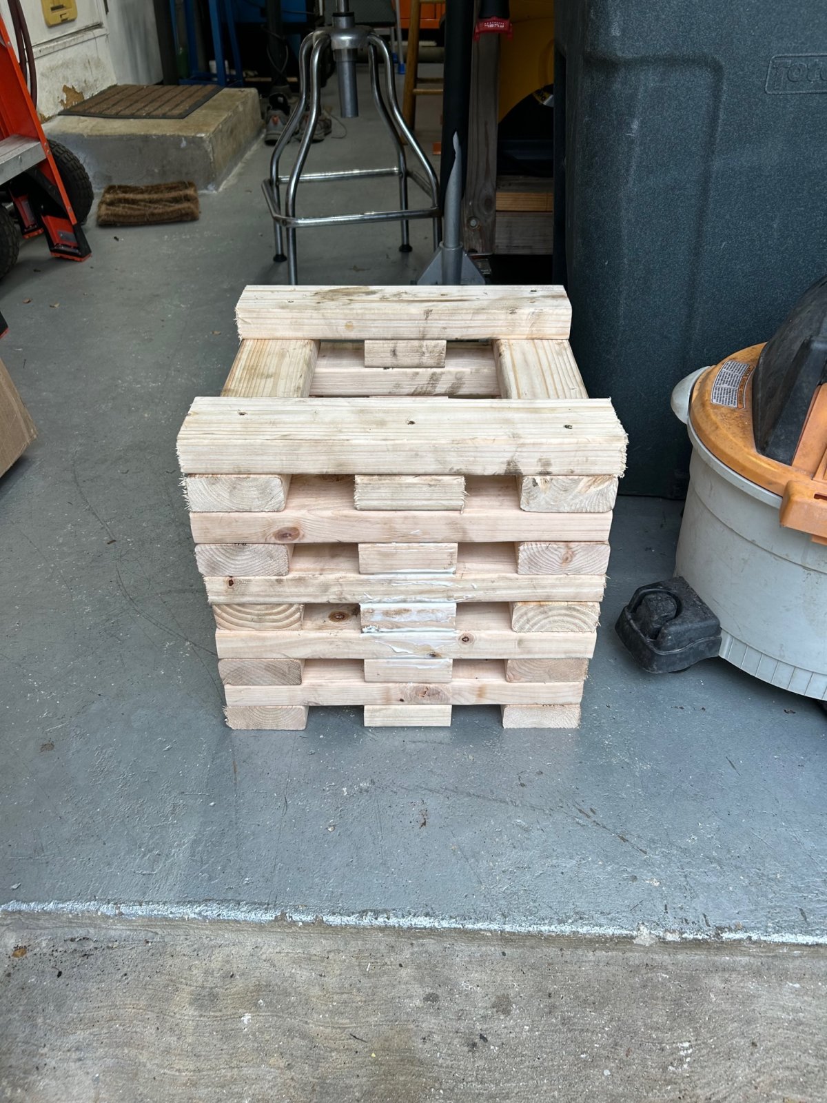

  18. 1971BB427
    Joined: Mar 6, 2010
    Posts: 9,692
    1971BB427
    from Oregon
    I've used jack stands and cribbing boxes to sit under my frame as I raise it. Once the floor jack maxed out I built another single cribbing box with a solid 2"x6" wood top and large enough to allow my floor jack to sit on top. Then just jacked it up a 2nd time, and then with spare blocking I keep around I built up the jack stands or cribbing boxes higher to finally get where it needed to be and still be safe and solid.
    Algoma56 and bulletpruf like this.

  22. bulletpruf
    Posts: 247
    bulletpruf
    Is your jack able to roll on the 2x6 box as you jack something up?
    Thanks
    Scott
