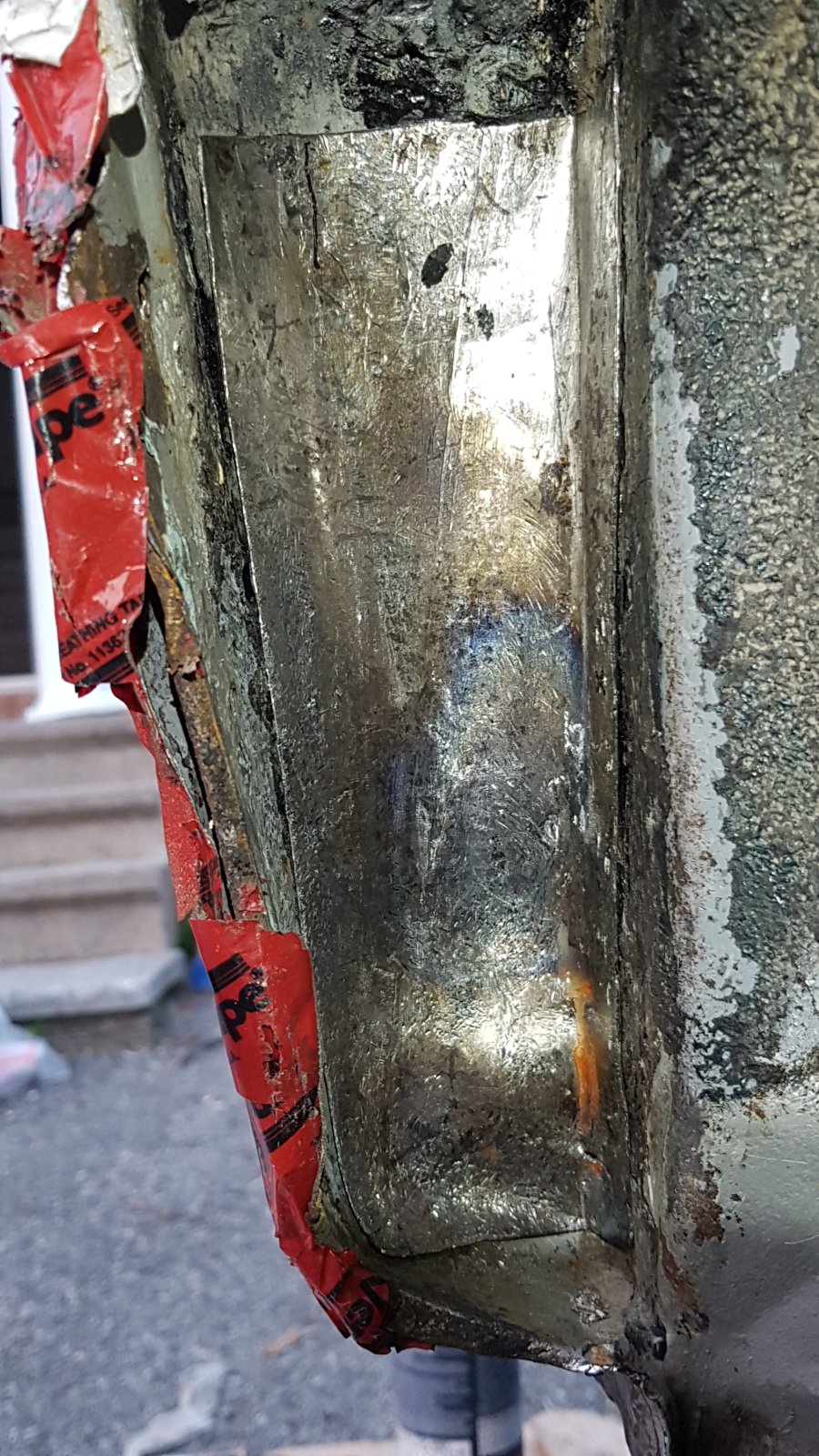

    Posts: 12,546

    Is that really the type of work you want on your car?
    It’s obvious this is not just a daily driver if your worried about rust. You need to worry more about pop rivets failing and the incursion of moisture along seams.

    It appears to fit just fine. Can you flange the body panel so the patch lies flush? At least for the most part? Other wise that is a lot of mils of bondo to properly work that patch for paint
