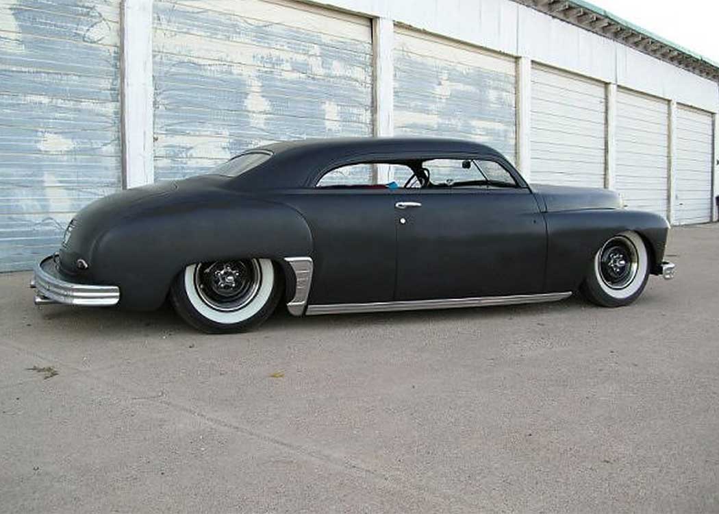

    Hey guys. Thinkn bout changing bumpers, install all the stock trim, and shave the door handles. The car is bagged and will lay frame. I would like to come up with a solution to make the front and rear look lower. Bigger bumpers, extend the bottom of the fenders????? what your ideas??

    I think it looks real good the way it is except at the bumpers, maybe you could extend the bumper brackets lower the brackets and get them level with the pans would look lower. But then again what do I know ?

    The car lays even lower now than that pic but the front and rear still seem like they are in the sky. Doesn't need much, move the bumpers down, put on taller ones and mount same height, add an inch to the bottom of the rear part of the fenders????
    Lets see some bagged kustoms.
  4. With great looking bumpers like a 49 Plymouth has it would be a shame to take 'em off. Why not make pans to go underneath them painted body color, extend the rear portion of the rear fenders down to mate up maybe even do the same with the front lower section of the front fender heels too.

  6. You could extend the rear fenders something like that, but keep your bumpers, they're the coolest ever!

    Section it.

    If you want it to look lower, the bumpers need to be lowered front and rear...the rockers right now are lower than the bumpers, and the bumpers being higher give it the illusion that it's not that low.
    I'd figure out a way to lower the pan below the trunk , that would in turn require you to lower the rear of the fender, that would make it look lower than it is. Same with the front bumper and lower front fender...problem with both is it makes it less drivable over dips and driveways that way.
    If nothing else, add some fender skirts to the rear, that always helps make it look lower...and I'd remove the stone guards too.

    Bring the bumpers down and in, via modifying the mounts and tray. Could look pretty good that way. Would be a little work but worth it in my opinion.

    The frame sits an inch lower than the rockers. Thought about welding an inch on the rockers and reinstalling the rocker trim lower to sit on the ground. I think the fenders definatly need to be lower even if i only add an inch.

    The license plate is not doing you any favors. Start by moving that down and it would visually change the back of the car.

    Yea i'm strongly thinking about putting on 50 buick rear bumper on. It has a spot for the plate in between the bumper guards.... also the bumper is 3 inches taller than mines so it will be three inches lower to the ground. need to do some mockup and post pics.

  20. I've noticed that you have completely ignored the suggestion to run fender skirts,,,That alone will improve the long low look you desire.

    Pretty sure just dropping the bumpers will accomplish what you are after...
    If not, you could lower the highest part of the wheel-wells.

    Man skirts would change everything. That should be your first step. Dropping the bumper without adding skirts is kinda goofy to me.

    stole the above dropped bumpers and did down and dirty skirts

    How about extending the rear fenders FORWARD instead of back? Plus long skirts that line up with the stone guard. Gives you a longer look without having to rework the entire rear end.
  27. That actualy looks very nice! makes the lines flow so much better!

    Thats exactly what these cars need. Seems like Mopar cheaped out and used the same (too short) rear fenders on two and four door cars. That why they look a little off.
    And don´t lower the bumpers. It just adds visual depth to the body, which is exactly what you don´t want.
