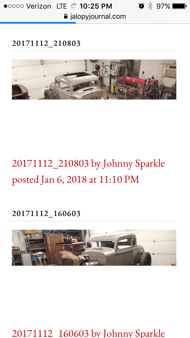

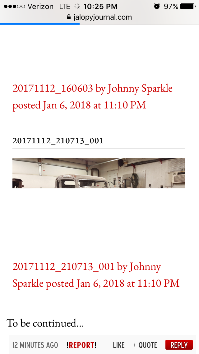

    Step 31: Cut the back of your car off. It'll be fun.
    The back of the coupe had a pretty rough time. The spots where the metal overlapped rusted out, and it looked like, well, it was on a car that was raced and flipped and left in a field. Imagine that.
    Cut stuff. Hit stuff with hammers. Go buy one of those cheap shrinker/stretchers from Harbor Freight. Really. That corner piece would have been impossible without it. They kinda mar the metal a bit, but it cleans up just fine.

    So, that takes us to where I'm at today. I forgot about it earlier, but I ended up having to make all the trunk rain guttering from scratch. Which sucked. Try bending a 4 foot long piece of 18 gauge clamped to a table with a hammer. 8 times. Then shrink or stretch it to fit. I need a fancy brake one of these days.
