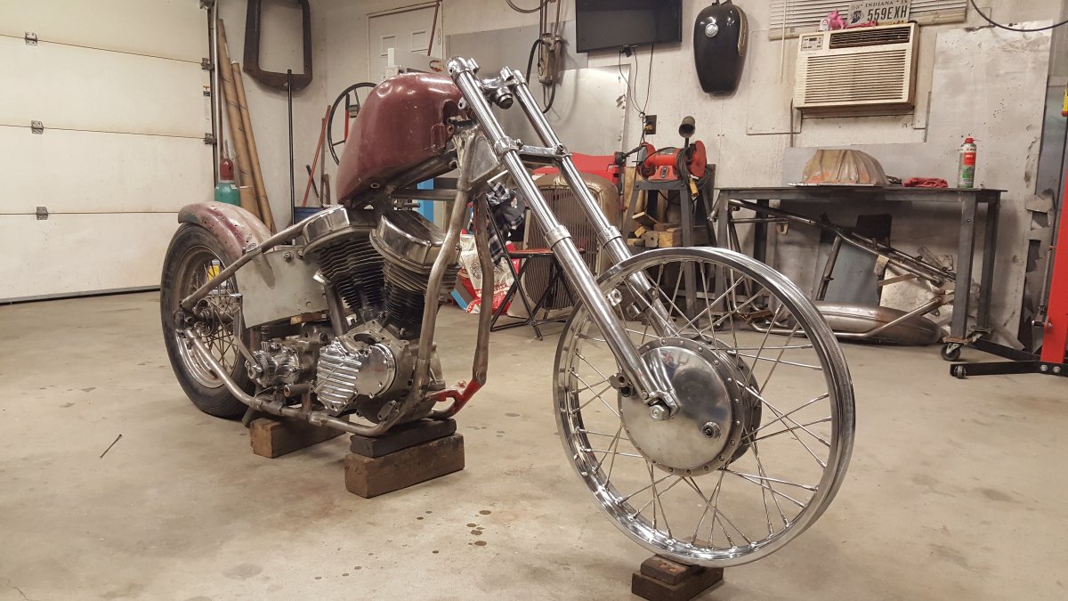

  3. 39 Aaron NZ
    Joined: Jan 2, 2017
    Posts: 86
    39 Aaron NZ
    Hi Johnny Sparkle, thank you for your very informative build thread!
    You made me realize I need to upgrade my hammer selection and my HotRod project needed a bike project.
    Your thought process lets you test your awesome metal work skills.

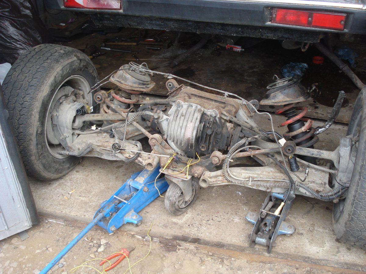

    This is from my 1989 XJ40

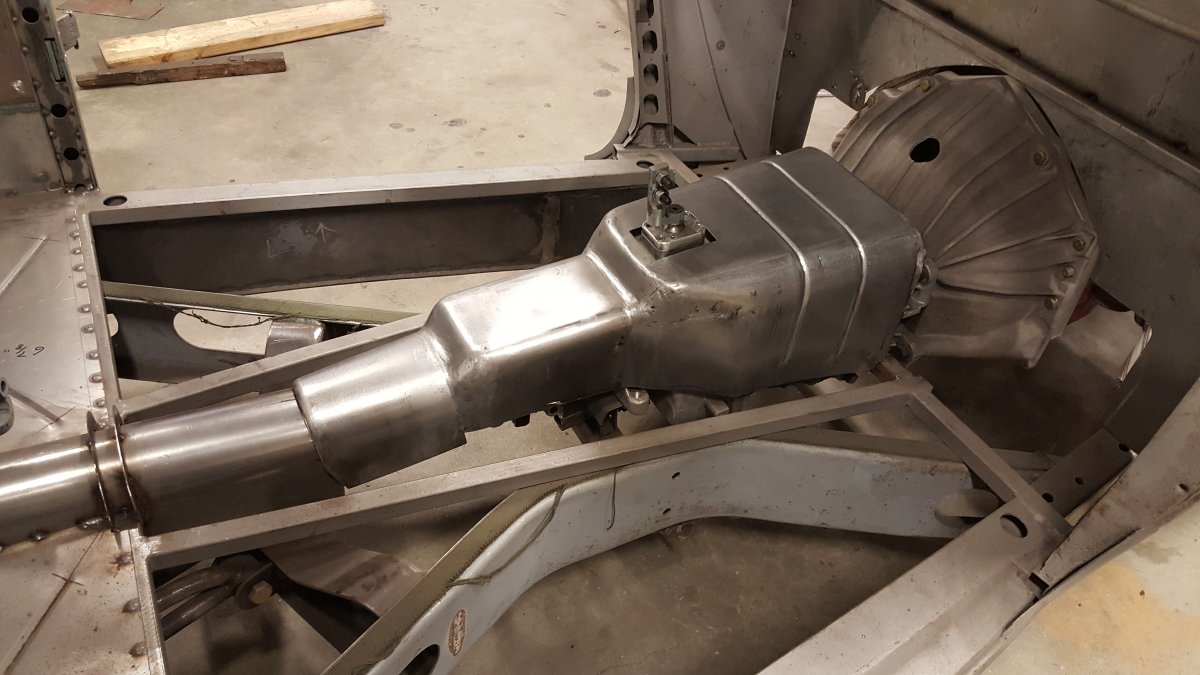

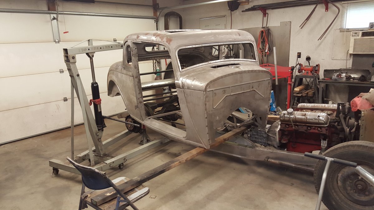

    Step 534:
    Force yourself to work on the coupe again. Get annoyed that it took, like, 4 freaking hours to make this stupid simple looking hoop to go over that funky-shaped TKO600.
    brEad, patmanta, OahuEli and 7 others like this.
  24. Johnny Sparkle
    Joined: Sep 20, 2003
    Posts: 1,136
    Johnny Sparkle

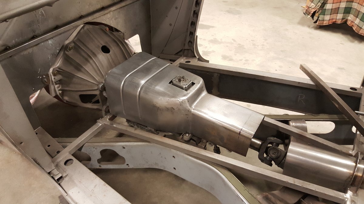

    Step 535:
    Delay for at least a month or two after getting that stupid tranny hoop thing tacked in. Become inexplicably motivated one day and start knocking out the tranny tunnel.
    brEad, patmanta, OahuEli and 11 others like this.

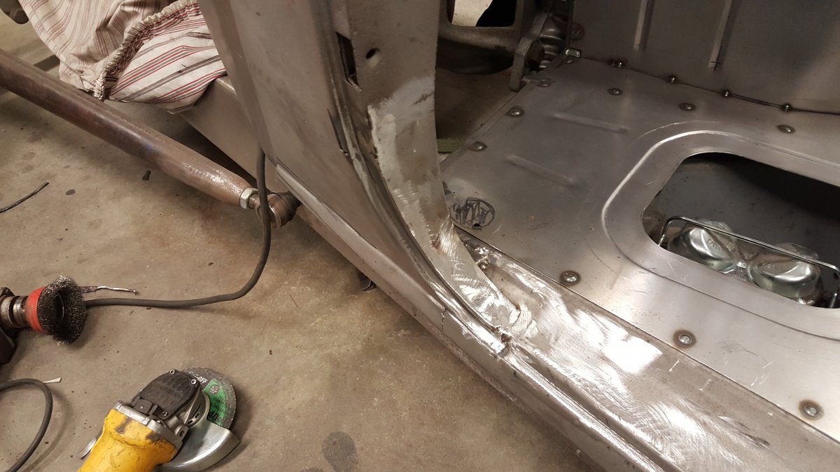

    Step 537:
    Rebuild the bottom of the A-pillar to match the '32 3W patch panels that were hacked up to fit the cowl. Mock up the door skin patch panel. The '32 Ford 3W has a longer door and a bit of a different shape,but the panel will work, I think.
    I've honestly gotten pretty luck on all the '32 Ford stuff working so well so far. The curves are way different than the Plymouth, but it seems to be falling together pretty nicely.
