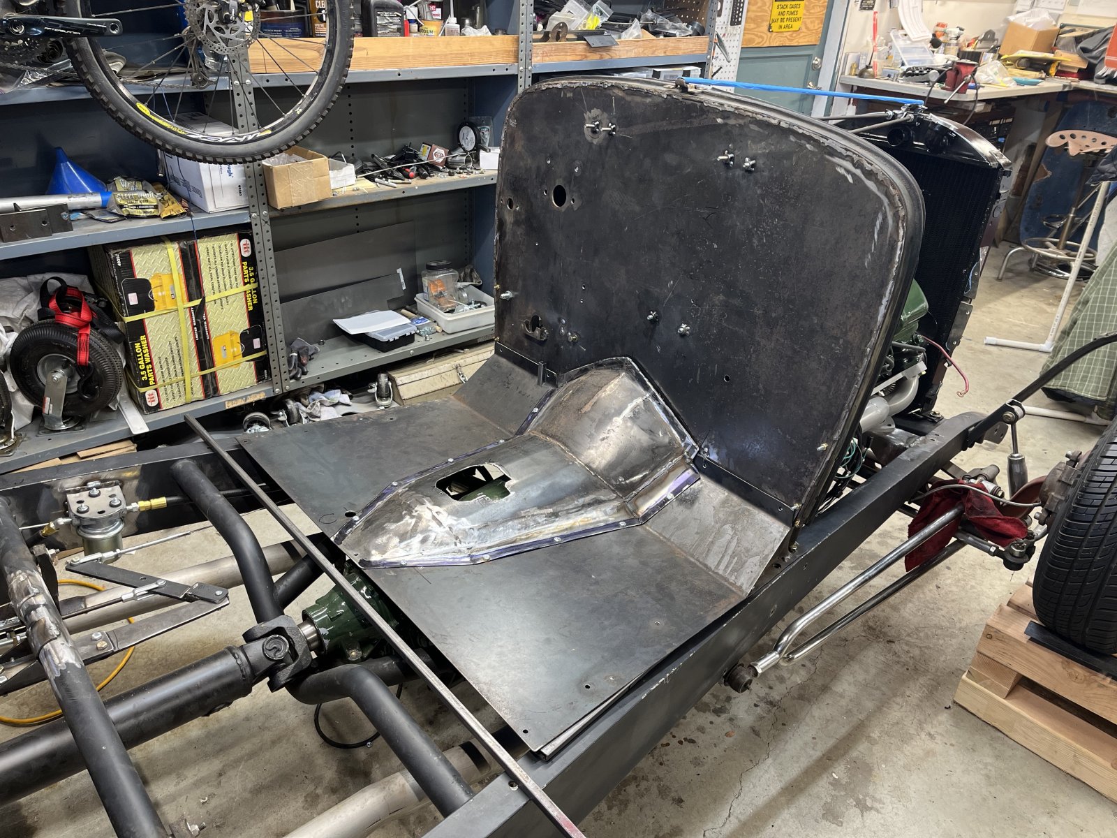

  10. -Brent-
    Joined: Nov 20, 2006
    Posts: 7,719
    -Brent-
    Same! I put a bead in the floor pan to add a bit of clearance to the rib on the bellhousing. If it hits, 2 things are for sure: it will self clearance and something went very wrong with my rear mounts.
