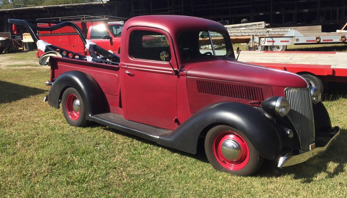

    Bare frame will ride easily in back of a pickup. See attached. A freshly powdercoated 36 Ford frame in my truck, the 36 Fordy.

    You did notice there are '35 -'40 frame(s) on the trailer.
