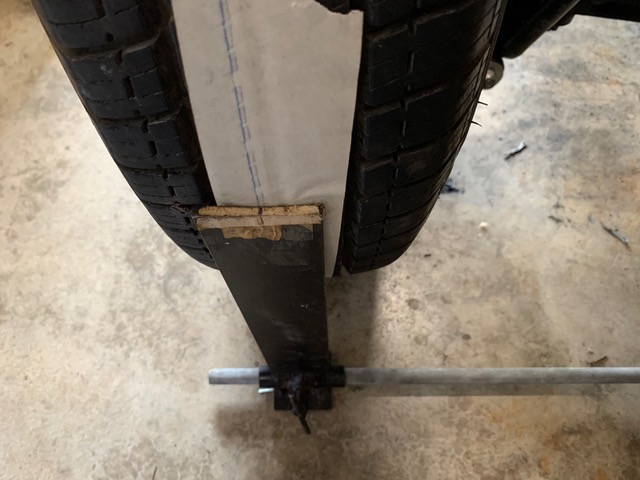

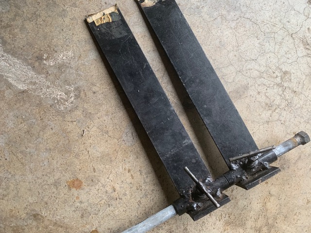

    I was setting the toe-in on the roadster and thought I would share how I do it. I have no idea how most people do it. I tried measuring from tire treads but gave that up and made this.
    I am a slob.

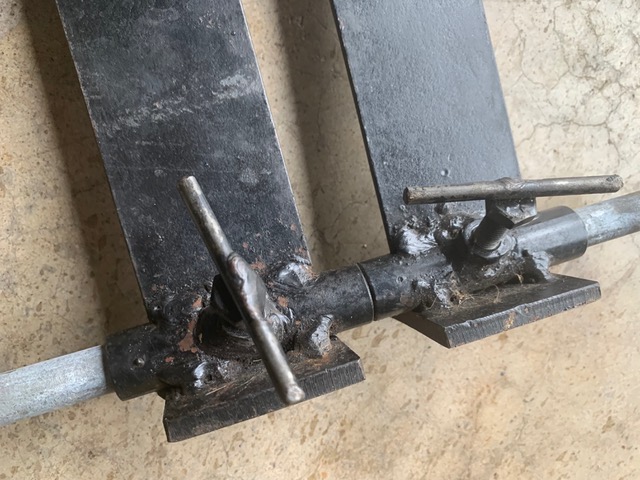

    I use a trammel that I made from scrap. I made it a long time ago.
    It is a piece of pipe with two straps that can be moved and tightened in position. They have marks at the top. I put tape on the tires and mark lines on the tape by turning the tires. The trammel straps get lined up with the lines. The trammel is then moved to the other side. Repeat as much as required to get the toe in set. It is very sensitive to set. I figured that one turn of the tie rod changes the toe-end by about 5/8 in. tempImagecdTBCi.png 4BF80D6B-5CE0-4357-AAC6-F8511CBF585D.jpeg 69008D03-BF3B-4F16-94A7-0F5D669A4BF7.jpeg AFE11B62-43E4-4B18-B917-915492BFCB33.jpeg F1032510-469B-4ABE-9098-130F2BE2A22C.jpeg

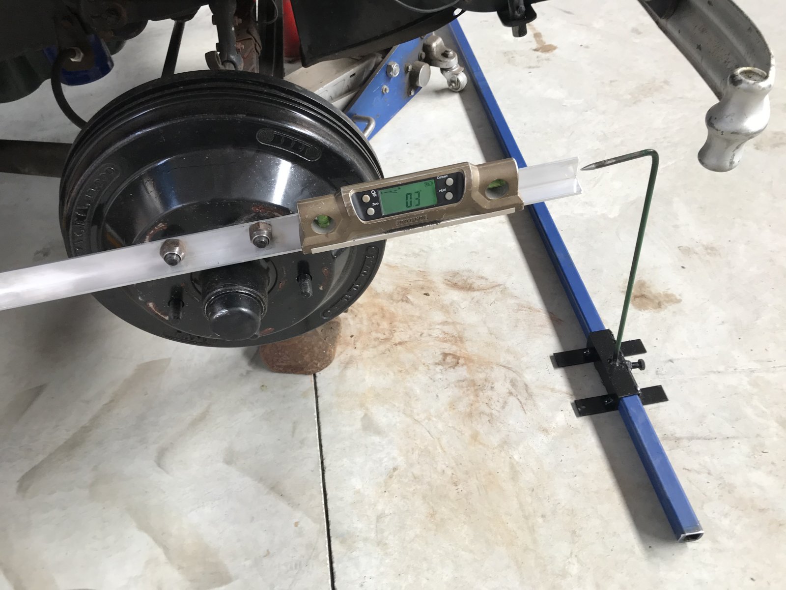

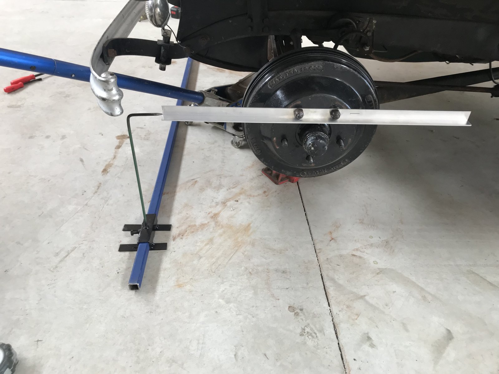

    IMG_7111.jpeg IMG_7110.jpeg IMG_7110.jpeg My method , I didn’t really trust a pen line on tape. I rebuilt the whole running gear , but assumed the tie rod was correct . After a few hundred miles we got the dreaded death wobble. Ha the front end had 1 1/4” toe in . Somebody in the past just guessed it .

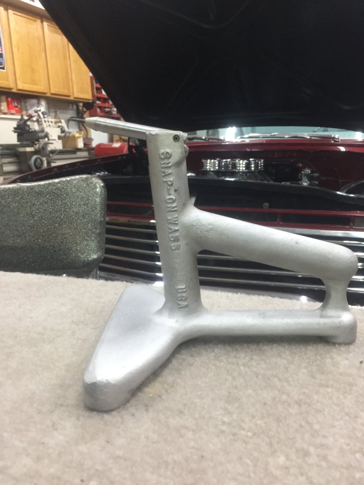

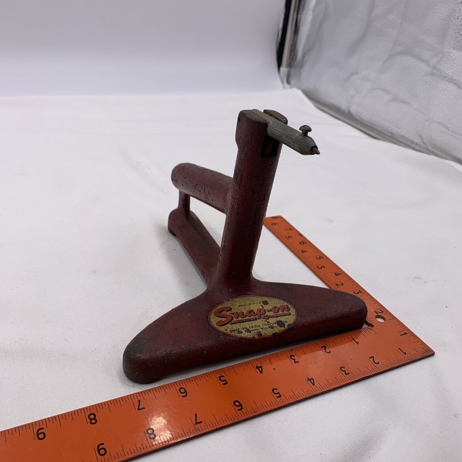

    I've done several hundred of them simply by lifting the tire off the surface, holding a pencil to the tread of the tire with something to steady my hand and slowly spinning the tire so I have a visible line around the center of the tread. do the other side the same, measure from the line on one side to the line on the otherside at the back and repeat at the front and calculate the difference. The only problem with that is that you have to have a helper who will hold tape exactly where they need to.
    The setup that Kiwi 4d posted at least is used when you set the chassis up without tires on the hubs and works. That lets you get that part done on an I beam front end where the toe in isn't going to change when you set the car down on it's tires. It won't work on and independent front end.
    That hanging the angle iron on the sidewalls again is cute but doesn't take in wheel or tire run out. it gets a ball park figure that may be up to a quarter inch off depending on wheel and tire runout. These setups are just amature hack setups that really aren't that accurate.
    I bought a pair of turn table plates from a used too peddler a few years ago that came with the fasten on the wheels aparatus to check toe in and even has two tape measures.
    Just don't overthing it guys, it isn't rocket science and you don't need some elaborate setup to do it. You just need a jack, pencil and tape measure.

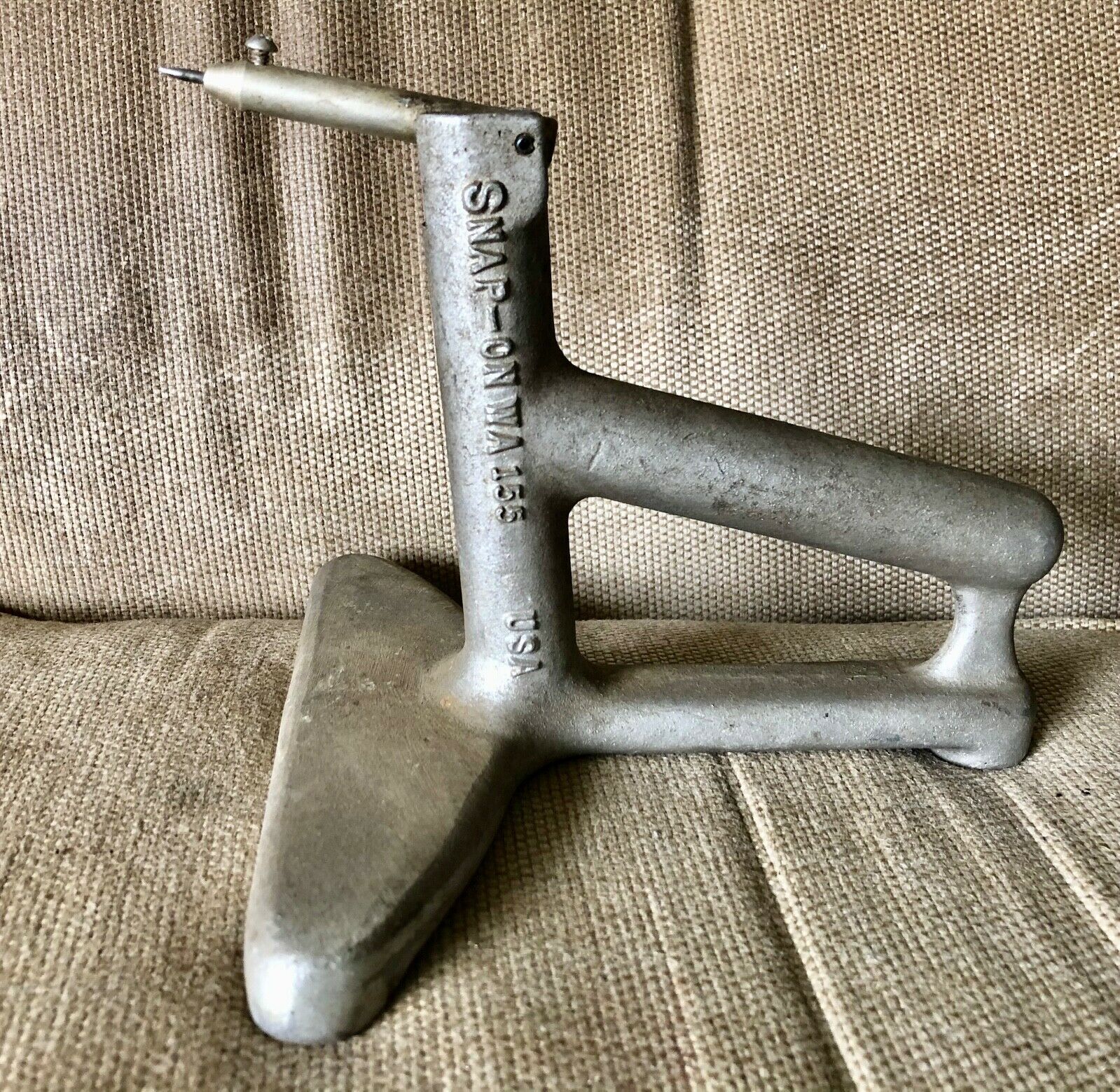

    SnapOn did make a tire scribe tool back in the 40's an 50's and maybe earlier to scribe the line on the tread but I have never got my hands on one. Snapon tire scribe tool.jpg Snapon Tire scribe.jpg

    My procedure is to leave the tires off the ground after scribing the center lines.
    I could just rotate the tires and not have both sides taped. I am lazy and have to move the trammel to the other side so leaving the tires be saves a step.
    I don’t need turntables or sliding plates or to move the car back and forth.
    I don’t trust the wheels or tires to give a true surface to measure from. I have confidence doing it my way.
