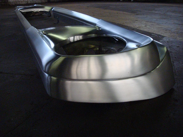

    For a Machined looked the lathe is the only way. If you are sanding it I would use 120 or 150 grit with WD-40 or PB Blaster. It will leave a nice finish. Here is a Ford grille with a Brush look.
