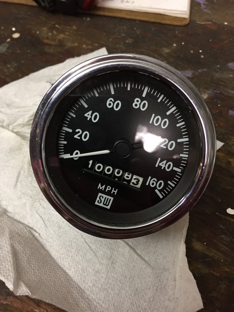

Hot Rods How do I lubricate this SW speedometer?

    Just remove the CABLE from the shielded housing, clean it, dry it and apply "cable ease". Re install, drive. Don't lube the meter it self.

    That Stewart Warner speedometer is the one with the plastic frame made in Mexico, sorry to say that they are junk. Lubrication will not cure what ails it. You can try a few drops of sewing machine oil or mineral oil on the bushing, but I don't think it will do any good.

    The speedometer cable spins the magnet (also called the first worm gear). The second gear runs horizontal and is turned by a worm gear on the shaft of the magnet.
    The second gear then turns a vertical third gear that turns a gear on the odometer. The odometer is supported on both sides of the frame through the center shaft that runs through the center of the odometer wheels. Odometers will lock up some times when rolling over
    multiple same digits, most often 9's or 0's. Since the odometer is the last link (gear) in the chain it can cause the magnet ( first worm) to strip, or break the cable.
    The speedometer needle is pressed on the shaft that is attached to the speed cup. In the center of the magnet there is a small bushing called the jewel (like a watch jewel).
    There is also an upper jewel that supports the speed cup shaft just behind the speedometer needle. When the cable spins the magnet turns inside the speed cup creating an eddy current that moves the floating speed cup thus moving the speedometer needle.
    Calibration is controlled by the strength of magnetism in the magnet which controls the eddy current that moves the speed cup.
    The stronger the magnetism the faster the response of the speed cup.
    Needle bounce or fluctuations happen when the jewel in the magnet that supports the floating speed cup is dry or becomes worn.
    If the jewel is dry and not worn it can be oiled but the speedometer has to be disassembled to oil the jewel.
    When the cup is separated from around the magnet you loose some of the magnetism so the magnet will need to be recharged then de-magnetized while the speedometer is spinning on the test bench to get the calibration correct.
    Most early speedometers have an oil wick hole that will let you lubricate the magnet shaft, this will quiet some noise but not cure needle bounce due to a worn or dry jewel.
    I know this was a long winded reply but I hope it helps explain some of how the speedometer works.

    It can also be caused by a dry or limber (worn) cable. Bouncing below 35 mph is usually cable, bounce or wide fluctuations above 35 mph is usually due to the speedometer being worn, in need of repair.

    Is the "plastic frame" you refer to the threaded black plastic around the shaft?
    Is the "bushing" the shaft that I refer to?
    So these are unrepairable? The "jewel" can't be replace, or is it not cost effective?

    I guess I'm lucky that mine made it to 10,008 miles before shitting the bed. My odometer is still working. The needle bounces at all speeds, more erratically at speeds above 45 mph. I already removed, inspected, cleaned, re-oiled and reinstalled the cable. When time permits I'll road test it. If I get lucky, swell. If that didn't fix it them I'll be shopping for a new speedo.

    Yes the part where the speedometer cable threads on, the entire frame is including that is made of plastic and the speedometer is not repairable, believe me I have tried multiple times. You will just have to replace it. If you notice you have 3 consecutive 0's showing so I bet the odometer is locked up and causing a chain reaction including the needle bounce.
