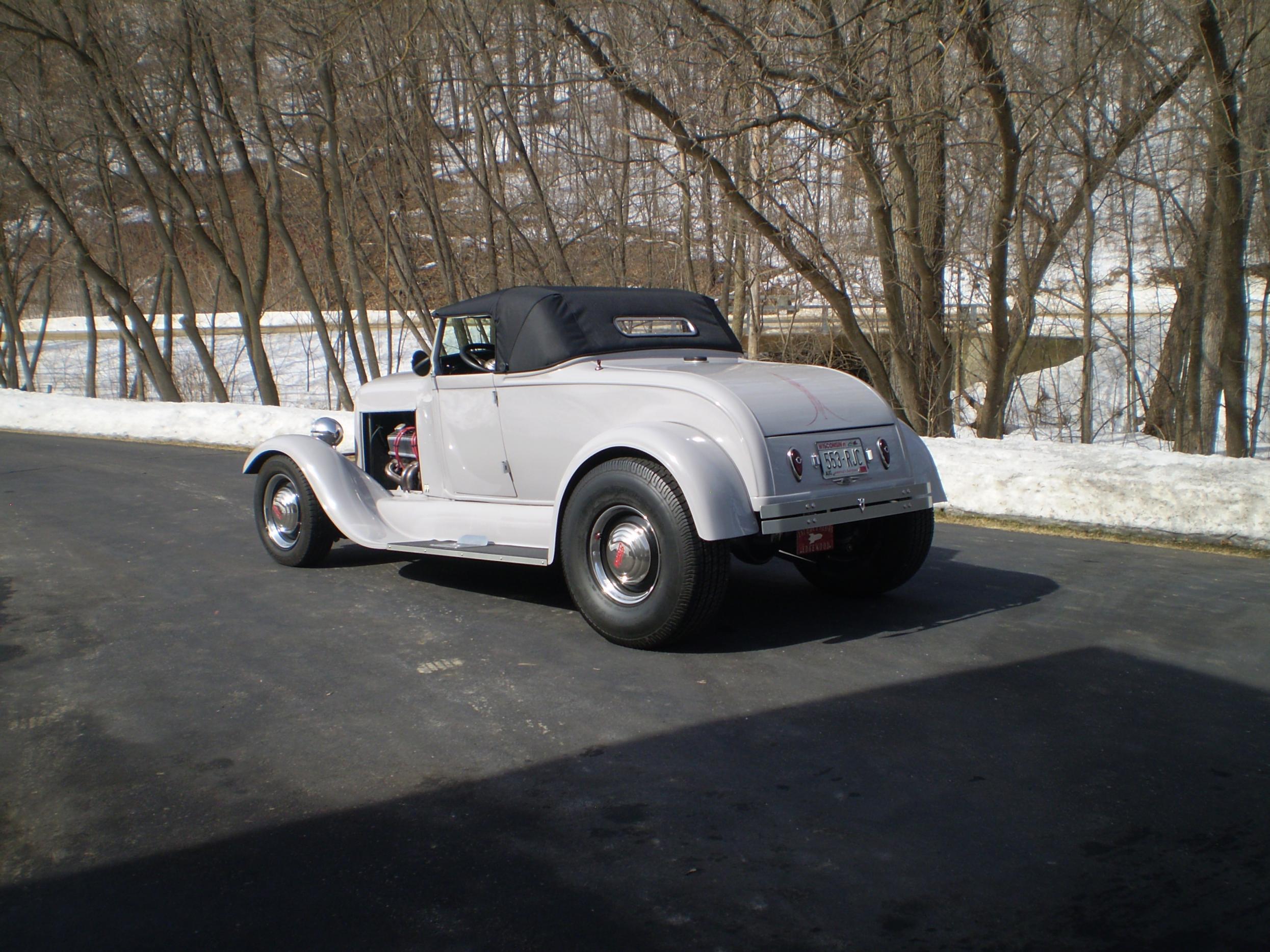

  11. Heater ??? It was 55 degrees here yesterday and I brought the roadster out. :D Seriously though, I had a heater out of a 47 or 48 Pontiac in my 40 Chevy P.U. Three speed blower motor and a rebuilt core and it worked great and looked right at home.
