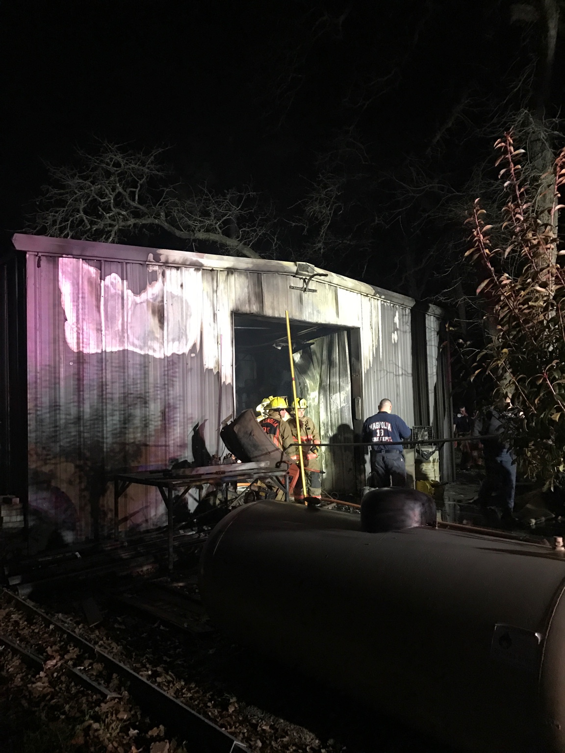

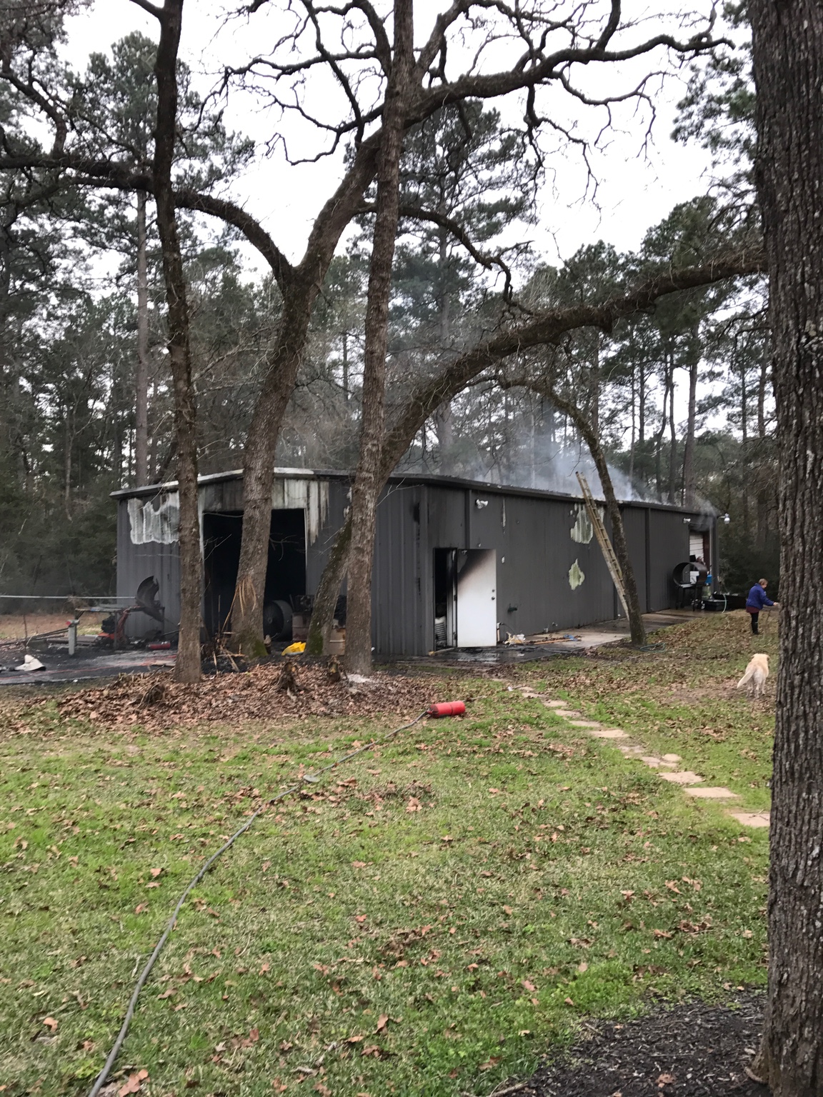

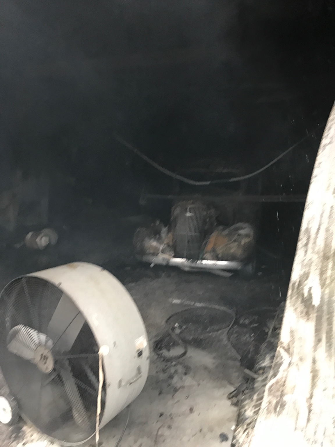

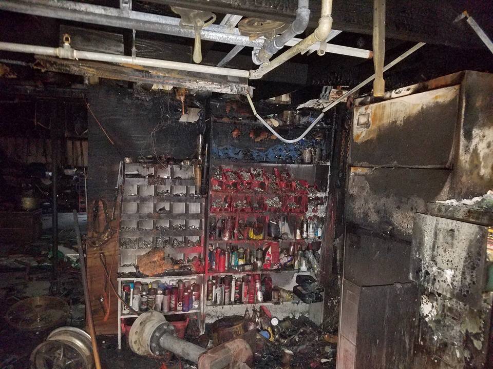

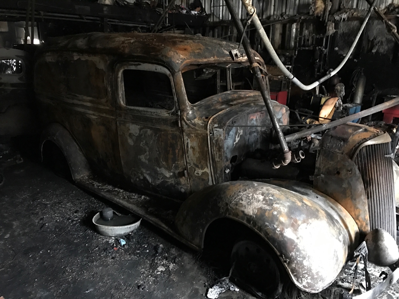

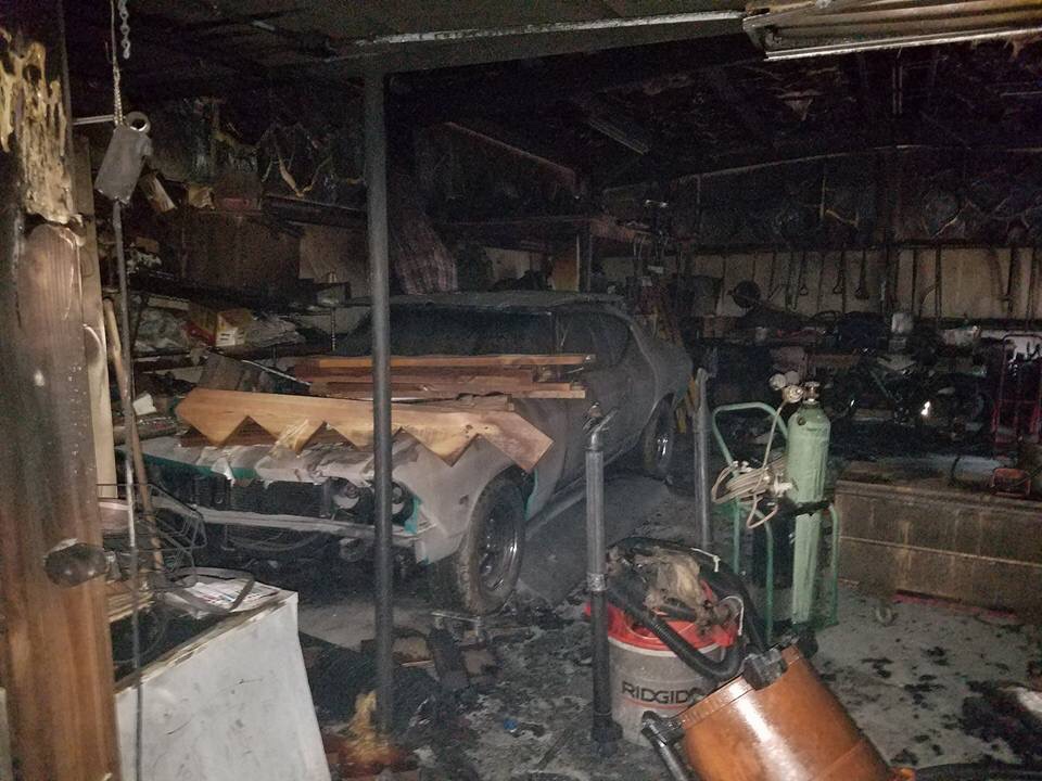

    Well guys my shop burned down friday night. I was draining the old gas out of my dads 37 chevy panel truck and did not realize our dearborn heater was just barely on. The vapors caught fire and i tried to put it out but there was nothing i could do at that point. Bottom line is i was too comftorable and not cautious enough and i hope some of you can take something from my experience. Me and my dad lost so much and its really hard to deal with and i hope nobody has to go through this. I apologize in advance for my dads car being a street rod but just wanted to show what it was before the fire, i took the picture of the car thursday and friday night it was charred. Also make sure you guys have the proper insurance on everything just in case because you never know. Luckily we have insurance and alot of it should be covered. But its the old sentimental things that are really heartbreaking[​IMG][​IMG][​IMG][​IMG][​IMG][​IMG][​IMG]

    That was a nice panel.

    We were just set up for disaster, the we had tons of stuff that we have collected over the years. Me and my dad are both hoarders, my dad 56, im 18. But we had shelves of spray cans, 3 propane tanks that blew, 2 five gallon cans of diesel, 3 five gallon cans of laquer thinner, whole cabinet full of paints, hardeners, reducers, etc. lots of bullets that were going off, small camping propane tanks that were blowing. Oxy fuel rig was in back and didnt go off. Our mig and tig bottles just melted the hoses so they just leaked out. But PLEASE use proper storage for flammable materials. You never think anything of it till it happens to you. I really would just like to share all of this to raise peoples awareness and maybe save someone elses shop!!! Ive noticed there are not a ton of kids on here and mostly very experienced hotrodders so i know as a kid im not going to be able to teach someone but maybe just open your eyes a bit! Thankyou all again
