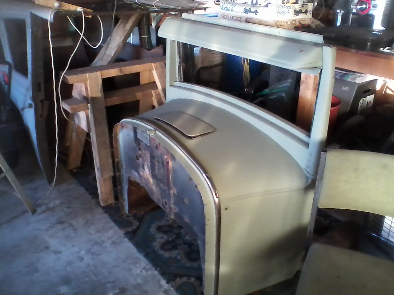

  25. Theres some great stuff coming out here, thanks again to all who have contributed so far. Im going to throw up the pics of yesterdays car crime. That'll get rid of the purusts, lol. Sorry if it offends anyone... No im not, this is a hot rod forum afterall. :D:D:D

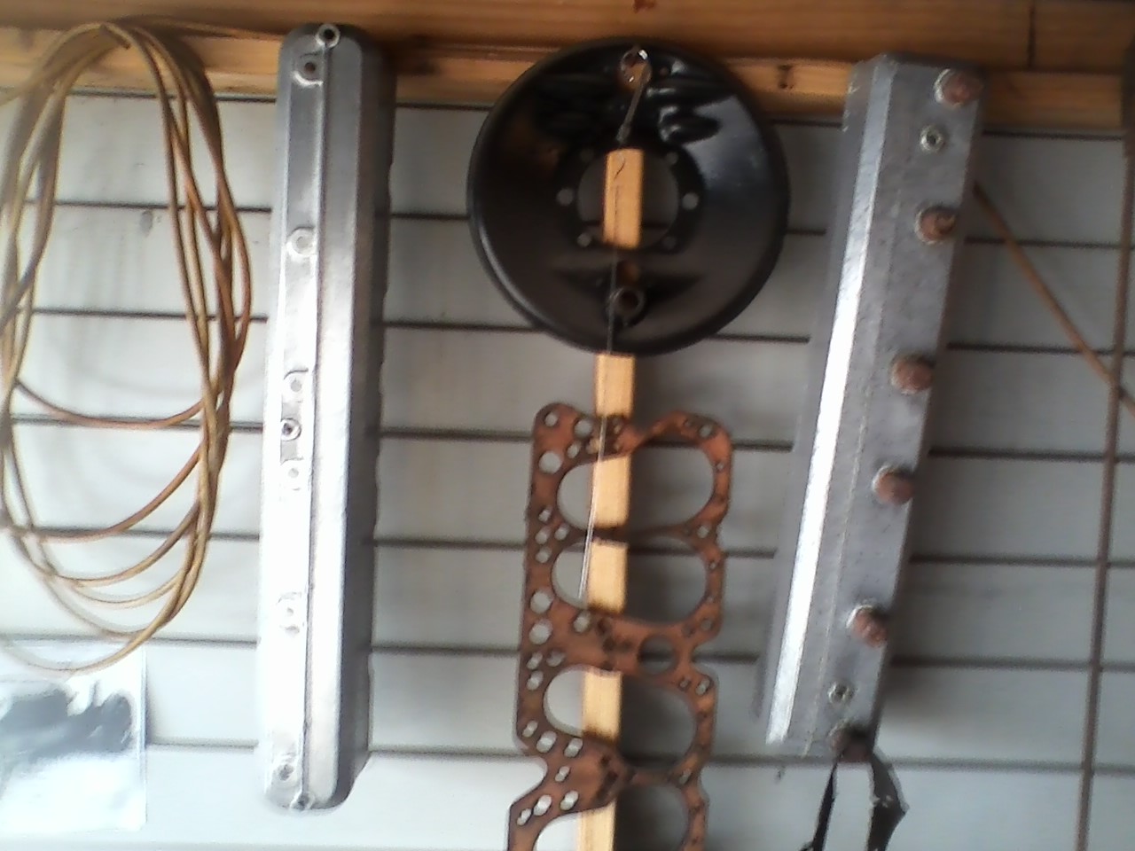

  26. QUIZ TIME, can anyone ID the rocker cover on the right? The left one is 28 or 29 Hudson Super Six, with oilers missing, and the left one is shorter, and more squarish, with oilers. Good question for the purists, who ive just scared off. Lol.
