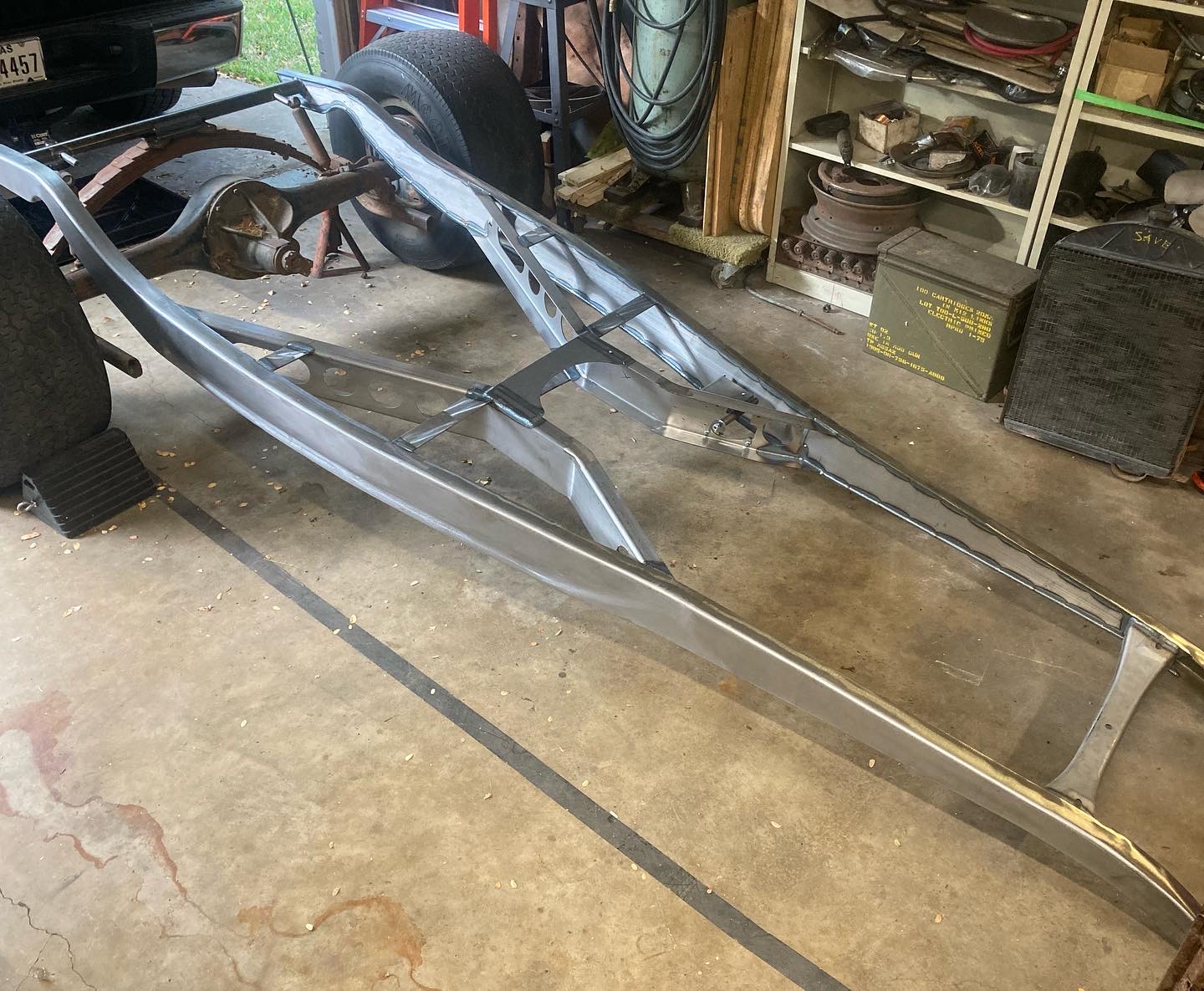

    I elected not to build my own frame this time. I didn’t need anything crazy or really have the time (or effort) to do it. I chose to go with an RJays perimeter frame and am really happy with it. It’s pinched and bobbed for an A, step boxed, ‘33/4 style X-member, A front crossmember. I grabbed one of his pedal assemblies too that should work great. I had thought I would swap the rear crossmember for a flattened original ‘35-‘40 but will wait and see.

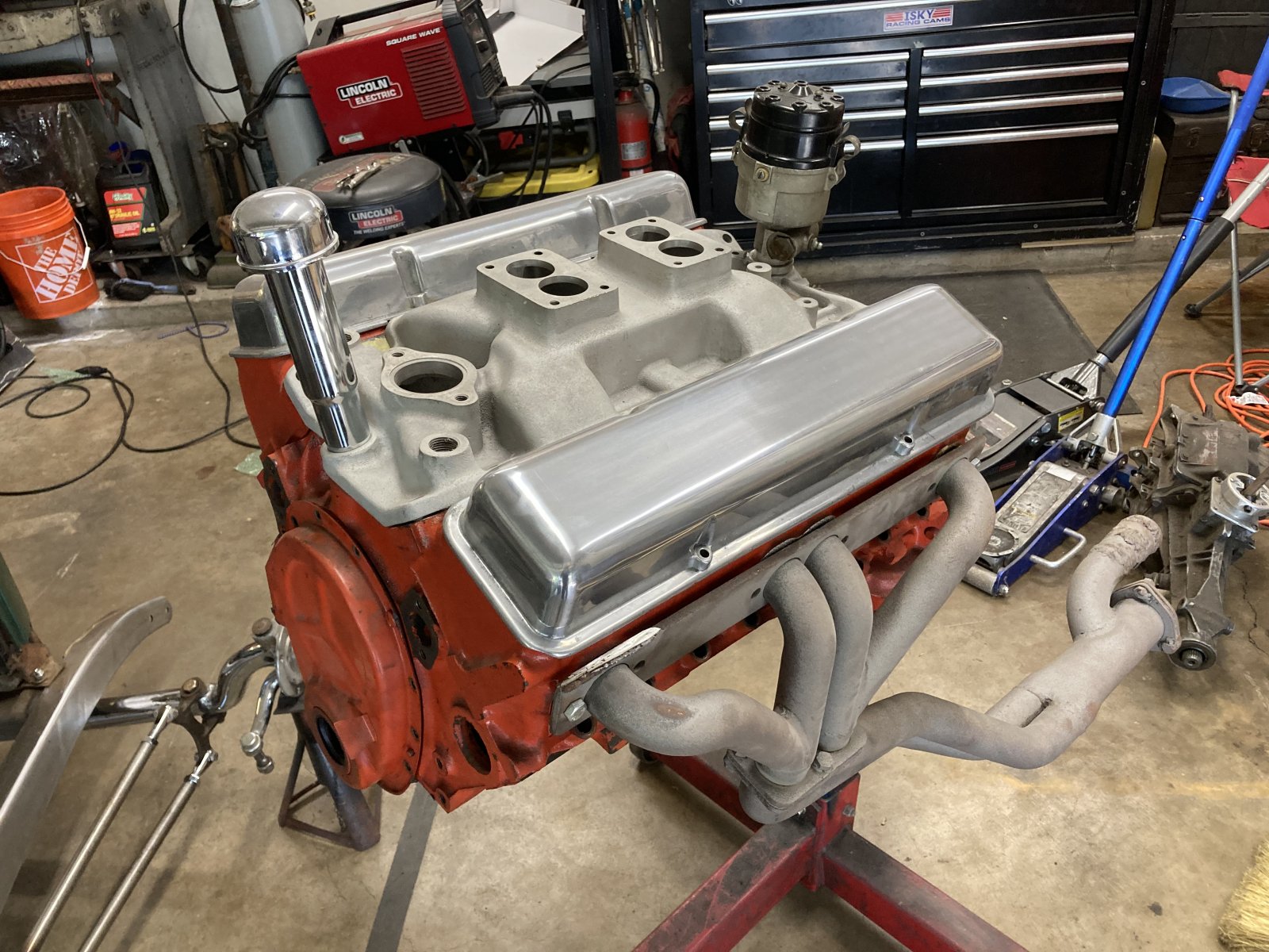

    I very intentionally wanted an early small block in this car, but wanted to dress it up a little differently. I also really like 2x2 intakes. Inspired by Sam Strube, I made my own from a Weiand 4-barrel and a 2x2 4-71 blower top. I'll be running Rochester 2G carburetors. The valve covers are original Corvette that I shaved.

  3. That intake is awesome!
    clem, WC145, bondojunkie and 6 others like this.
  4. GordonC
    Joined: Mar 6, 2006
    Posts: 3,160
    GordonC
    Nice work on that intake!
    Stogy, kidcampbell71 and Anderson like this.
  5. wheeldog57
    Joined: Dec 6, 2013
    Posts: 3,179
    wheeldog57
    Wow!!! That intake!!!
  6. continentaljohn
    Joined: Jul 24, 2002
    Posts: 5,538
    continentaljohn
    Your build sounds awesome and great collection of parts but that intake is wicked cool and ingenious
    WC145, Atwater Mike, Stogy and 2 others like this.

    Lots of hours in that intake. Ameracana alive and well

    Just a lot of planning and about a weeks worth of lunch breaks!

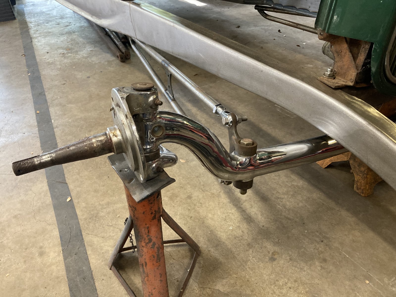

    Small update. Got a parts order and assembled the front suspension. Made some mounting tabs for the hairpins…I think Chassis Engineering used to offer this kind and I really liked them, so I just made my own. That’s as far as that went, since the threads on the end of the hairpins need to be re-tapped from that gnarly weld at the end, and I don’t have the right tap at home.

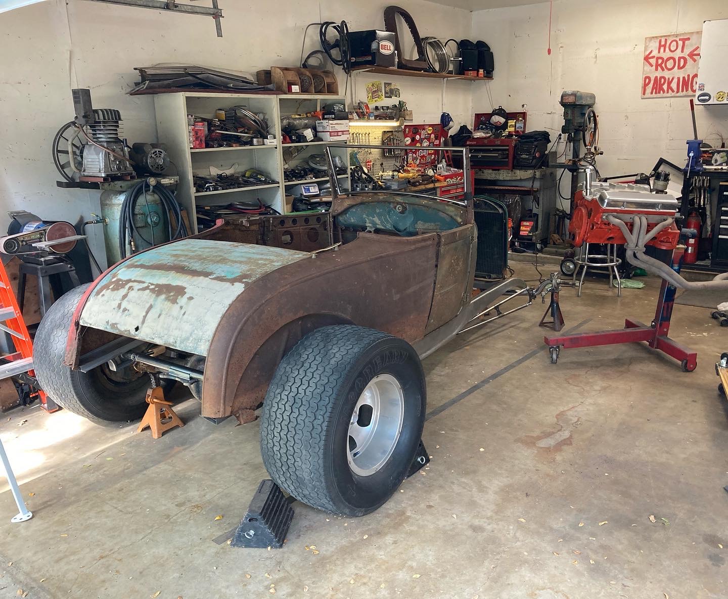

    Been a while since I got to sit and stare at a hot rod in the garage! Hairpins sorted out and the rear mounts tacked on. Trans crossmember bent up and clamped in place, final engine position looks good to me.

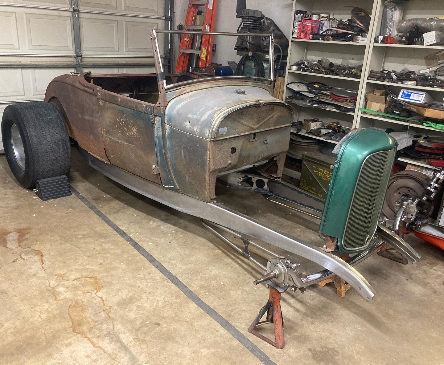

    The custom intake and 2 piece Tri-Y headers are really bitchin, as is that bellhousing even if it will be hard to see. By Wisconsin standards, that body is really pretty good, too!
