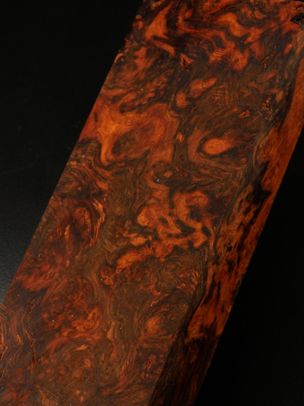

    Picked up this method on the Hamb last year.
    This winter it was time for small update on the 33.
    Have been looking at this one for five years now, time for a change
    Took out a spraycan of HYUNDAI Hellrot orange,
    Fired up the acetylene torch and sooted the dashboard.
    And used toilet paper dabbing around to get something like a wood pattern.
    Then without touching it I sprayed on some coats of clear, to protect the surface.
    I will fix the rest later, spring is arriving soon here in Sweden.
    I think it came out quite nice.
    I have all electric buttons mounted under the dash , because i dont whant to add any extra holes in the rare 1933 standard dashboard.

    maybe the pictures don't do final result justice but, does not look like any type of would I use for projects.
  3. Looks more like tortoise shell.

    Turned out nice but hardly looks like wood grain...

    neat design, but it doesn't look anything like wood. although i've never seen swedish wood.
  6. Has kind of a "burled" look to it.

    I like it, kind looks like tigers eye maple or burled walnut to me.
