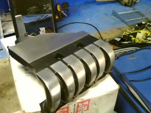

    i work at an auto shop and peiced one of these together today to blast an intake
    manifold for my car..
    i used a tube deflator
    a quick air fitting
    2x chrome inner mount valvestems
    and some 3/8 rubber hose
    i didnt bother putting any kind of trigger on it, but i also only used it for 5 minutes
    heres the finished product... 80 grit - soda blast - polished...
