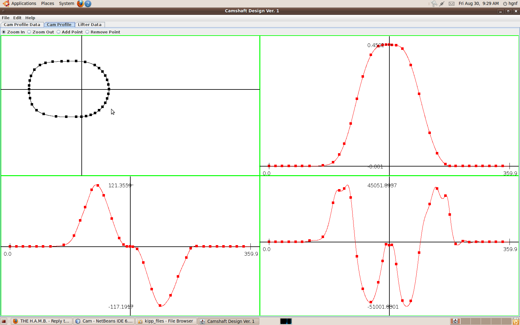

    So the basic idea: build a cam and all the associated machinery, electronics and software from scratch.
    Steps:
    1) write a software program to design cam shafts
    2) design and build the electronics that will interface between the computer program and the grinder.
    3) build the grinder.
    I've got the software program about 70% complete, but haven't touched it in about a year. Attached are some very early screen shots I'll upload some newer versions of the program when I get a chance. There are four windows, the upper left is the cam profile, this happens to be a radical roller design with the center of the cam located where the axis cross each other, thus the base circle is on the right at 0 degrees and the centerline of the lobe is at 180 degrees in standard x-y graph fashion, the upper right is the lift as a function of cam shaft degrees, the lower left is the velocity of the lifter, and the lower right is the acceleration in in/sec/sec. (latter versions read out in pounds of force). The specs on this particular lobe are: Base circle radius - .5", roller diameter - .750", lift - .450", duration - A LOT! ~330 degrees of crankshaft rotation at .050" lift, vlv is dwelled at its max lift.
    To design the cam one clicks on the squares on the profile and drags them, the computer then calculates a smooth curve through all the square points for the new profile and calculates the lift, velocity, and acceleration. The profile in the first attachment is a relatively smooth roller cam profile (albeit a very radical profile). In the second one I dragged the the square that is highlighted blue in a little and we can see the step in the lift graph and the rather huge accelerations, which one would expect with a rather large dent in the cam shaft lobe.
    Incidentally, When I started writing the program, I assumed the hard part would be the behind-the-scene calculations, but by far the hardest part is getting the graphs to be displayed correctly!

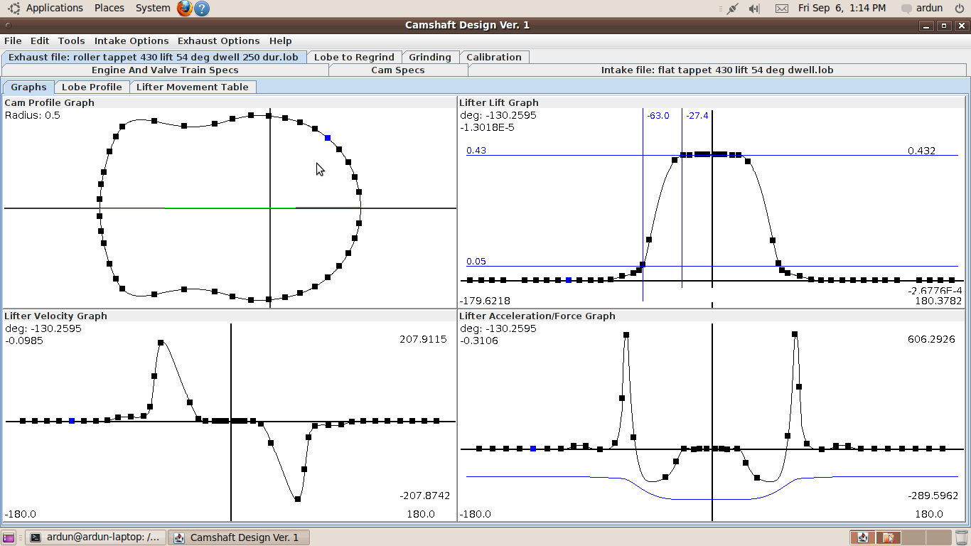

    Hi all, I'd like to share more of what I have learned about camshaft building...today the topic of:
    Max Valve lift and Dwelling the cam.
    When I began this project, I nievely thought there's no need to lift the vlv more than what the port can flow. In other words, as the vlv begins to open more air can flow through the port and vlv and into the cylinder. The more the vlv opens the more air that can flow. But there comes a point when the vlv is no longer the factor that limits the air flow and rather the port becomes the limiting factor. Once that happens, no matter how much the vlv is lifted beyond that point, there will not be an increase in flow. For this example I'll use a Ford flathead. For a ported, polished, undercut, relived flathead Ford this occurs around .430" So make the max vlv lift .430, right? Nope...well maybe...depends on the situation.
    Lets say our cam had a max lift of .430" That means that maximum air flow is only reached for a brief moment just as the vlv reaches max lift. It would be much better if maximum air flow could be had for more than just a brief moment. So we need to keep the vlv open to at least .430" for a significant amount of camshaft duration to realize more HP. There are two ways to do this, first we can simply open the vlv more, say to .515" max lift, that way the entire time the vlv is open greater than .430 there is maximum air flow through the port. The second is to dwell the vlv at .430". There are several problems with dwelling the vlv, larger crankshaft duration at .050, larger loads on the cam and stiffer springs are required (esp to keep crankshaft duration down).
    To illustrate these points refer to the 3 attachments.
    The first shows a flat tappet cam with .515" max vlv lift and 270 degrees crankshaft duration. The vlv is greater than .430 for 54 camshaft degrees, note the blue lines on the lift graph, the horizontal .430" line crosses the profile at -27 degrees, and there is another 27 degrees past the lobe centerline, designatied as 0 degrees, that the vlv remains open greater than .430". (we have to keep camshaft degrees and crankshaft degrees straight here, crankshaft degrees are the industry standard when describing duration, taken at .050" lifter lift. When referring to this duration I will use crankshaft degrees, for all other "durations" I will use camshaft degrees)
    Some graph explanation first, the lower right graph is Acceleration/Force, the values are in pounds - force (lbf). Positive values denote the force that the cam has to apply to the bottom of the lifter and negative values denote the force that the spring needs to exert in order to keep the lifter on the cam lobe. The blue curved line on the lower half of the Acceleration graph is the force that the spring applies, as long as this value is larger in magnitude than what is required to keep the lifter on the lobe, then the lifter will follow the cam lobe, else it will leave the cam lobe. The force depends on RPM and the mass of the vlv train. I chose 300 grams for vlv train mass and 4500 RPM, the exact values won't affect the outcome of this discussion. Also, the spring shown is stiffer than what is required for this particular cam and vlv train combination, but again, it won't affect this discussion.
    For the first attachment, the largest load on the cam is 265 lbf and, though not shown, the spring would need to apply a force of 90 lbf when fully open.
    By comparison, the second attachment shows a flat tappet cam that dwells the vlv at .430" for 54 camshaft degrees, therefore, the same amount of time for maximum airflow as the first cam. But the crankshaft duration is now 330 degrees, at .050". (I'm not even sure if that will run?!) All other parameters where kept the same. This cam too would require 90 lbf of spring pressure at max lift but notice that the cam now has to exert ~600 lbf on the bottom of the lifter, a significant increase. In order to reduce the crankshaft duration, the time spent at .430" would have to be reduced on this particular cam.
    Therefore, for a given crankshaft duration, a cam that has a max vlv lift greater than the vlv lift required for maximum air flow will allow the port to achieve maximum air flow for a longer period than a cam which simply dwells the vlv at the vlv lift required for maximum air flow, thus more HP.
    Back to the cam that dwells the vlv. By switching to a roller cam, (see the third attachment) we can invert the flanks of the cam and get the crankshaft duration back down to 270 degrees. However, notice that the spring force required to control the vlv train has more than doubled, the spring on this cam would have to exert ~200 lbf at max vlv lift, as opposed to 90 lbf with the first cam.
    Therefore, comparing the first and third cams, both have the same crankshaft duration and both keep the vlv at or above .430" for 54 camshaft degrees, but the one that dwells the vlv requires a spring that is over two times stronger than the first cam.
    So, that is why it is better to have a cam that exceeds the maximum that the port will flow. The only reasons to switch to a cam that dwells the vlv would be in some sort of racing that limits max vlv lift or, as in our case, a flathead engine where max vlv lift is limited by the head. An overhead vlv has no restrictions on max vlv lift so that is why we see .650" plus cams. But on a flathead, the more we relieve the head to get greater vlv lift, the more we loose compression.
    A roller cam that dwells its vlv seems to be the best option for a flathead engine. And, fortunately, the vlv train is lighter and more robust than the overhead vlv engine, therefore, we don't have to worry about the higher spring pressures.
    Incidentally, 270 degrees duration at .050" is a competition only style cam. For example, 270 dur in a SBC has a power range of 4000 - 8500 RPM. This is not what I'm planning to run, it was just for illustrative purposes.

    The rate at which a roller opens or closes refers to the velocity of the vlv train. A large peak velocity doesn't necessarily mean a large acceleration is required. For example, lets say we wanted to drive 50 miles in one hour. Now lets look at two different methods to reach this goal. Method 1: gently accelerate for the first 30 minutes to a peak velocity of about 75 MPH then gradually decelerate reaching 0 MPH just as we get to the 50 mile and 1 hour point. Method two: stomp on the gas pedal and accelerate as fast as possible to 50 MPH hold that for one hour then slam on the brakes and come to a screeching halt at the 50 mile and 1 hour point. Both methods went the same distance in the same amount of time, however, the acceleration and deceleration for method one was much, much smaller than for method two, therefore the amount of force to produce method one was much smaller than the force required to produce method two. In the vlv train, it is the spring that supplies the force to decelerate the vlv while opening and accelerating the vlv to close. So if we were to go from a cam profile similar to method two above, and say .400" at a given duration and RPM, to a cam with a profile similar to method one above with say .450" at the same duration and RPM, we may actually need less spring force even though the average velocity increased.
    Spring rate: The spring has two parameters we need to look at, the force at a given compression and the spring rate, these are related but different (I'll admit I will often use the term spring rate, or stiffness, when I should be saying spring force). Mathematically they are related by the equation: (known as Hooke's Law)
    Spring Force = (Spring Rate) X (free length - compressed length)
    Lets look at a scenario, I'll use large unrealistic numbers just to make the math easier. Lets say we had a cam that had a 1" lift and required a spring force of 200 lbf at max vlv lift to keep the lifter on the cam. And lets say the installed height was 3", thus at full open the spring height is 2". Now lets say we choose a spring that has a spring rate of 100 lbf/inch and a free, uncompressed, length of 4". Using the above equation, with the vlv fully open, we get a spring force of 200 lbf (100 lbf/inch X (4" - 2")) and, with the vlv closed, a force of 100 lbf.
    Now lets say we increased how fast the vlv opens and closes by increasing the RPM, thus we have the same max vlv height and same duration, but at the higher RPM the cam now requires 300 lbf at max vlv lift. We can use a spring with the same spring rate it would just have to be longer. The free length would be 5". With the vlv full open the spring force would be 300 lbf (100 X (5 - 2)). But the spring force with the vlv closed would be 200 lbf.
    If we were okay with the increase in spring seat pressure to 200 lbf then great, we can use a spring with the same spring rate even though we increased the rate at which the vlv was opened and closed.
    However, if we want to reduce the seat pressure back down to 100 lbf then we need to increase the spring rate to about 170 lbf / inch with a free length around 3.7" thus a seat pressure around 100 lbf and a full open pressure of around 300 lbf.
    So back to Kerry's statement, in general the cam profiles are not as radically different as the driving scenarios above, thus, generally speaking an increase in the rate at which the vlv train is opened or close will increase the force required to keep the lifter on the cam, thus requiring more spring pressure. And when it comes to springs, we wouldn't have to increase the spring rate unless we wanted to keep the seat pressures down, which we generally do. So yes its a generally true statement, but not always, just depends on the specifics.

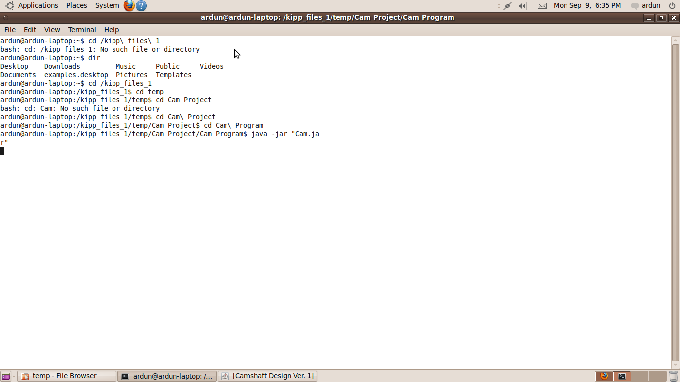

    For all who want to play around with my cam program: (I haven't written a "Help" section yet so I've included instructions here)
    Attached is the cam program thus far. It is a Java program that can be run from the command prompt (I still need to learn how to package it up and make running it user friendly, any Java guys out there that know how to do this? pls let me know so I can share this program and make it user friendly) Most computers come with the necessary Java Runtime Environment (JRE) already, but in Windows you need to "tell" Windows to "link" the command prompt to the JRE. There is plenty of documentation on-line of how to do this. I don't run Windows anymore, but did it years ago.
    When you unzip the file there will be a directory called "Cam Project." Inside of it there are two directories, "Cam Files" and "Cam Program." Cam Files has various files that I've created just as test files for lobes, springs, etc, none of the values, ie mass, spring rate, etc. are actual values. (except SBC roller lifters have a .750 diameter)
    The attachment "Command Prompt" is a screen shot of the Ubuntu version of the command prompt and the instructions I had to type to run the program. Note, when there is a space in a directory name or file then a "\" is used before the space to tell the computer that there is a space in the name.
    There is a lot of documentation on-line of how to run Java Programs from the command prompt so you should have no problems googling it (now being able to follow what some of those guys write....well...)
    Once you get it running, the "Engine and valve train specs" tab will be on the screen first. When the program opens, all options are available to input data (OHV, triple springs, different springs on intake and exhaust, different rocker arms, etc) In general, the engine won't need all the various options, under the File menu you can select various options that will reduce the amount of stuff on that first tab. For example, if you check "Flathead" all the rocker arm information goes away, if under "Spring Files" you check "All Springs Are The Same" then the exhaust spring data goes away and the spring data just becomes "Spring Specs." The same is true for F-head, single, dual, triple springs, same rocker arms, etc. Note, if under "Cam Lobe Files" you select "Single Pattern Cam" there will still be an Intake and exhaust tabs, that's because, in general, at least the valves will be different and therefore the graph of Acceleration/Force will be different for the intake and exhaust. In this mode, making changes to the lobe in either tab, Intake or exhaust, will automatically update the lobe in the other tab.
    To start, open an existing intake or exhaust lobe from File -> Cam Lobe Files -> Open Intake (exhaust) Lobe then navigate to where you put "Cam Project" , "Cam Files" , "Cam Lobes" and select one of the lobes.
    To start a lobe from scratch, click on the menu "Intake (Exhaust) Options" -> "Create Circular lobe." Then click a point on a lobe and drag it outward to make the cam lobe.
    Some pointers / options / known bugs:
    - To shape the lobe, click on a point in any graph to highlight it blue. In the Cam Profile Graph, click and drag the point for course movements, usually when starting a new lobe. Then you can use the arrow keys for fine adjustments. You can change the amount by which each key stroke moves the point under "Tools" -> "Set Arrow Key Increment." I usually start at .010" then .001" then .0005 then .0001, as I'm tweaking the lobe. The arrow keys move the point the direction you would expect, up, down, left, right. Even if you highlight the point in a different graph, say in the lift graph, you are still moving the point in the Cam Profile Graph, up, down, etc which has an effect on the same point in the lift graph, but you are not moving the point in the lift graph directly.
    - Zoom in and out with the mouse wheel (easy way) or under "Tools" -> "Zoom settings" -> "Zoom in (out) with mouse click." (a left click in the fields of the graphs gives this option as well but it is currently broken) Once a point is highlighted in the Cam Profile Graph, then zooming in and out will zoom the other graphs in and out so that only the portion of the graph that is displayed on the Cam Profile Graph is displayed on the other graphs. This is true even when zooming in and out on the other graphs. If the highlighted point goes out of view, in the Cam Profile Graph, the other graphs go to their default zoom until the highlighted point is brought back into view. All the graphs can be moved by clicking on any white portion and dragging the graph around.
    - center the lobe at 180 degrees not 0 degrees (standard x-y graphing degrees), in other words, to the left of the vertical axis. (the mathematical model is a linear representation of a circular object that wraps around the lobe 2 1/2 times thus minimizing any mismatch at the 0 degree point, but I've had troubles with placing the lobe on the right side at 0 degrees) It shouldn't really matter where you put the lobe center line because the computer calculates the lobe centerline (that's the green line) by making the area under the lift graph equal on both sides of the lobe center line.
    - Acceleration/Force graph, positive values are the forces the cam exerts on the bottom of the lifter. Negative values are the forces the spring has to apply to keep the lifter on the cam. (Strictly speaking, the positive values displayed is only the force, along the axis of the lifter, required to overcome the inertia of the valve train, it does not include the extra force from the spring, nor does it include the extra force on a roller lifter that comes from the side loading of the lifter, latter I'll have to include graphs of these other forces, so we will know how much force the cam will really have to exert)
    - play around with right clicking on the graphs and their header bars and on the blue lines that you or I have created. There will be options to change the units, where appropriate, to insert, delete, and move the blue reference lines, etc. On the Acceleration/Force graph there is a curved blue line for the spring force, this will only come off the horizontal axis, and thus be useful, if the units "lbf" are selected.
    - In the window "Cam Profile Graph," if a section of the cam lobe turns red, that means the lifter, or roller on the lifter, cannot follow the cam there, (the inverse radius of the lobe is smaller than the radius of the lifter) On the rest of the graphs, this area will disappear and there will be sharp spikes on the Acceleration and jerk graphs, as one would expect with a large "dent" in the cam lobe, its like hitting pot holes in the road. If a section turns orange, that means the grinding wheel cannot follow that section of the cam lobe.
    - If the spring is not strong enough, a curved red line will appear on the Lift graph. This is the actual path the lifter and valve will follow as they leave the cam lobe.
    - Select which graphs you want displayed in "Intake (Exhaust) Options" -> "Displayed Intake (Exhaust) Graphs"
    - You can have a symmetrical or asymmetrical lobe. Under "Intake (Exhaust) Options" -> click on "asymmetrical", "Match lobe below X-axis to above X-axis" or the other way around. There is a glitch, you have to be in Asymmetrical mode when opening a lobe file, open the lobe file, move a point a little bit, then switch to one of the symmetrical modes.
    - you can add and delete the "control" points, those are the squares on the graphs, by right clicking the cam lobe line to add a new point or right click the point to remove it.
    - If you want to change the base circle, you can select points to be "on the base circle" then change the base circle on the Cam Specs tab. Currently the base circle is the only thing that can be changed on this tab, the cam lobe separation angle is set at 110 and the advance at 0 (to be changed latter). The rest of the info is calculated from the lobe / lifter combination. Glitch - it only displays one crankshaft duration not separate Intake and exhaust, so the last lobe to be modified is the crankshaft duration that is displayed.
    Its not finished yet but I hope you guys enjoy this, comments and recommendations are welcome.
