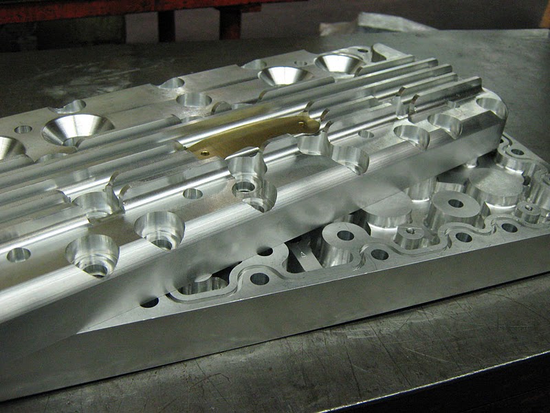

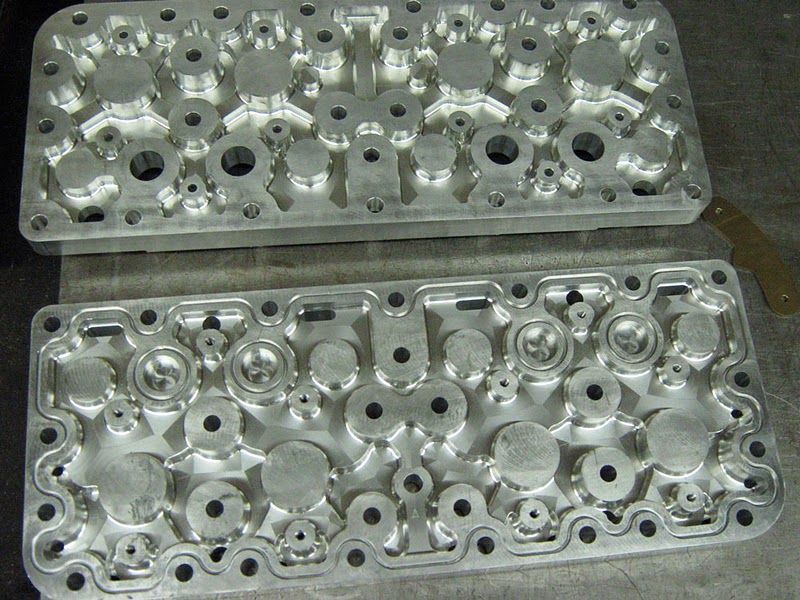

    I assume you will mill water passages between the 2 head halves?

    Yes - water jacket machined between the head halves.

    This is awesome. I thought of milling my own head for my A but couldn't figure out how to do the water jacket.
    Maybe I missed it, but the jacket is in the top half right?

    In all the ones I've seen and owned, the jackets were in the top and bottom halves.

    38Flattie, How thick is the head above the combustion chamber?
    I was going to leave .500" overtop the quench area and .300" over the vlvs with a rib in the top half that will add support to this thinner area.
    (7.5:1 comp and 6 pounds boost)
    What do you think?
