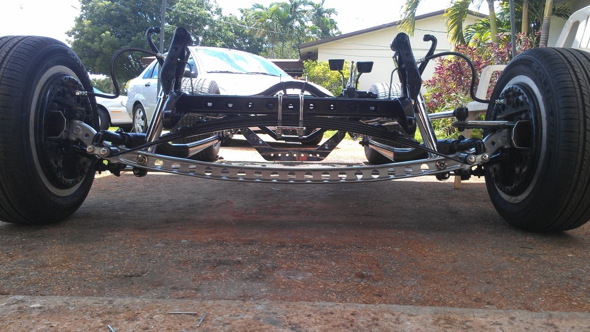

    hello everyone , I been messing around getting ready to build some lower front shock brackets , I know I could just buy some ,but I like doing things like this , so I could use some ideas ,I'm using a 32 ford front axle and tradional steering , like I said some ideas would help , thankyou in advance

    front axle 32? you talk tube or H,both were used. H is like most ,I like the spring forword 48 my self best. But lower for eye/tube shocks can be very simple,just drill hole in too beam center rib,add blot an spacer,on any H type can just. If needed a offset can be added like I did so I could used a little longer shocks. This is best photo I have from the last restore I did too my own 48axle in 28A. With tube you can make"L" bracket that goes on bone bolt.

    Made my own, shock and light mounts , might redo ended up being short on travel 1485312938077.jpg
