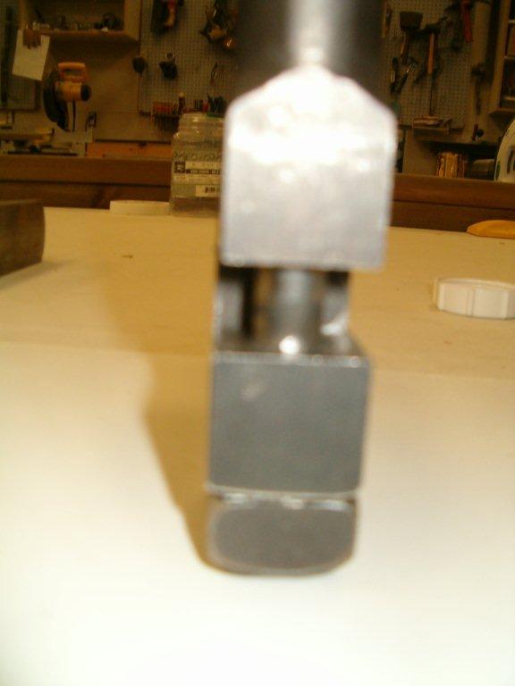

    Bitchin' Mod, do you have shots of results on sheet metal? Are you using a air hammer or press?
  4. Voh
    Joined: Oct 18, 2006
    Posts: 1,038
    Voh
    what would you use that particular tool for? I get the edge/flange maker part. What does that rib do for you?

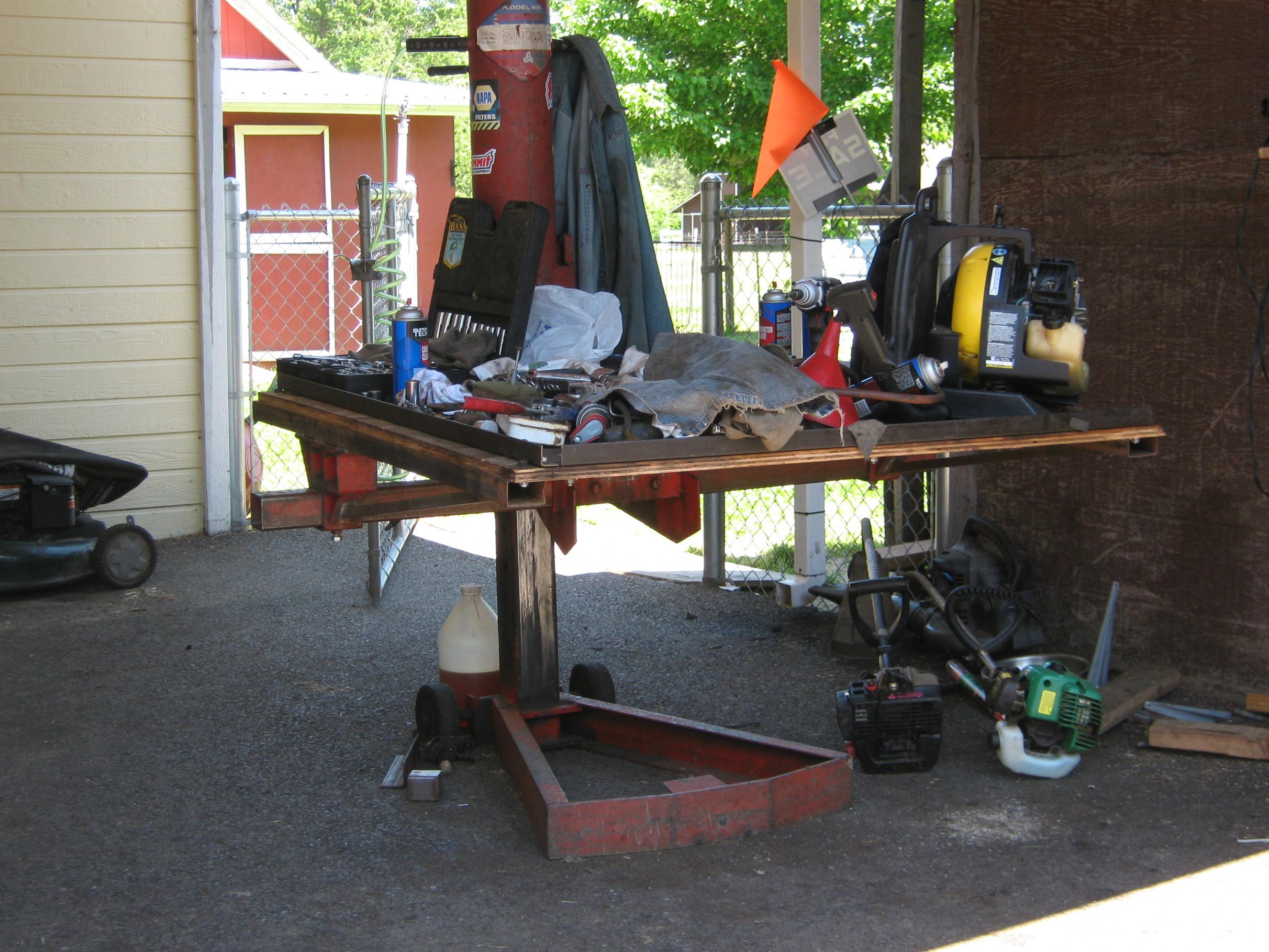

    "repurpused" front end lift,for my mower repair shop...

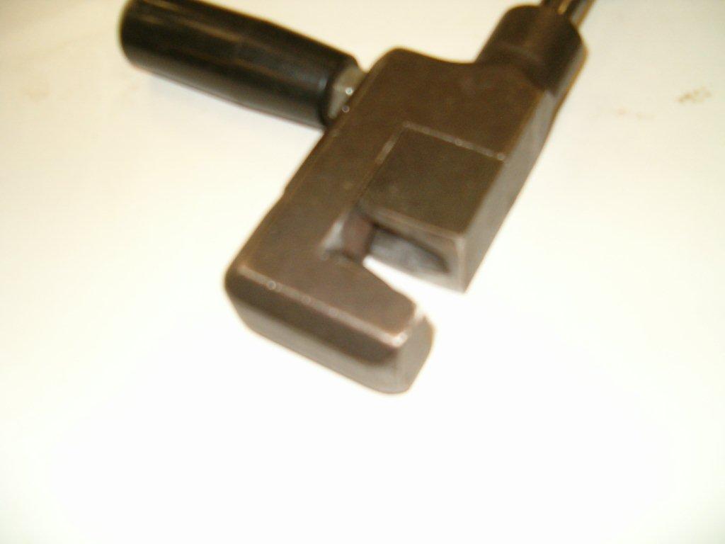

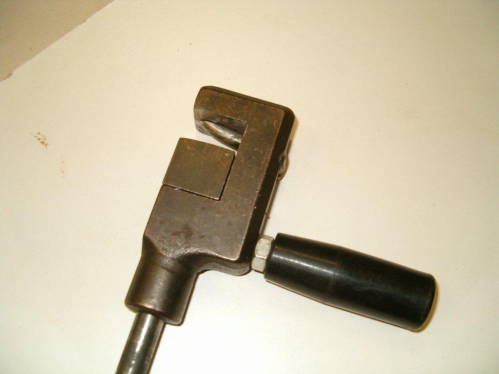

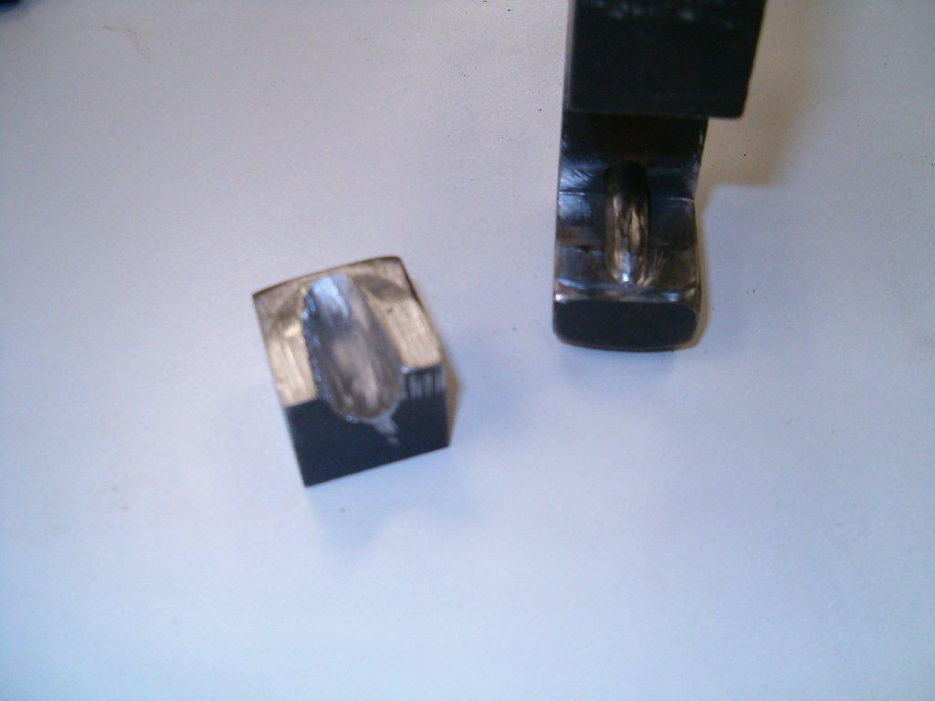

    i'll take some pics .....i'm still tweaking it ......it makes an awesome clean tuck but i'm still working on the hammer flat ....it is shrinking right now but to be honest it isn't pretty......i used a drill bit for the thumbnail and it is too brittle..it has broken twice ......next thing is a Chinese drill bit or a grade 8 bolt? .....next time i will leave more area in front of the thumbnail ......i'm using an air hammer.
    voh ....its a thumbnail shrinker ....hammers sheet metal into itself to shrink an edge....

    You want a bit of extra clearance in the thumbnail area. the only part that actually touches should be the flat area in front of the thumbnail. If that makes sense. that way the TN has enough room to pull the metal in from the sides. and oil the dies, it helps. but i think you may be unhappy with the throat of that tool. might work Ok as a flange shrinking tool. Make you some home made lancaster dies. that'd be cool.

    Thats where that lift went,,,,, Under my bench.:D
