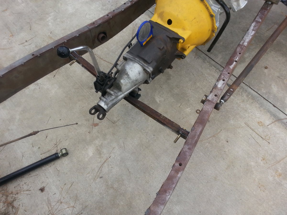

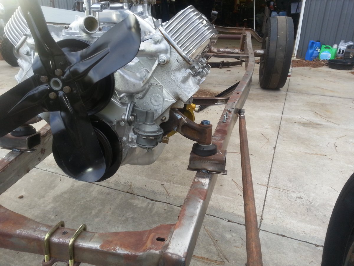

  9. Gott do some fine tuning to them but I built the motor mounts for the 259 stude in my tudors chassis out of a 40 axle. used the rest of the axle making a drop out trans cross member, more cross members to follow...
    twenty8tudor and Stogy like this.
  10. Cool. We made a front cross member for an A roadster pickup out of the center arc from an A axle once. Old axles make good car parts of you have them. ;)

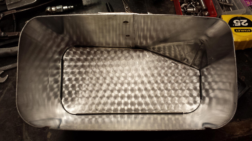

    Had some fuel issues with trying to gravity freeing the stock tank.. So making a small 5.5 gal tank to go underneath and use an inline pump out of it..
    Start
    Little lathe work on some round stock
    Bungs for the fittings is what the round stock turned into
    Ran some pieces through the mill to fit them inside.. Forgot to take into account over lapping pieces..
    Makes for a nicer fit then trying to grind it down with a grinder
    Time to weld
    And now we have a tank to pressure check today..
    Hnstray likes this.

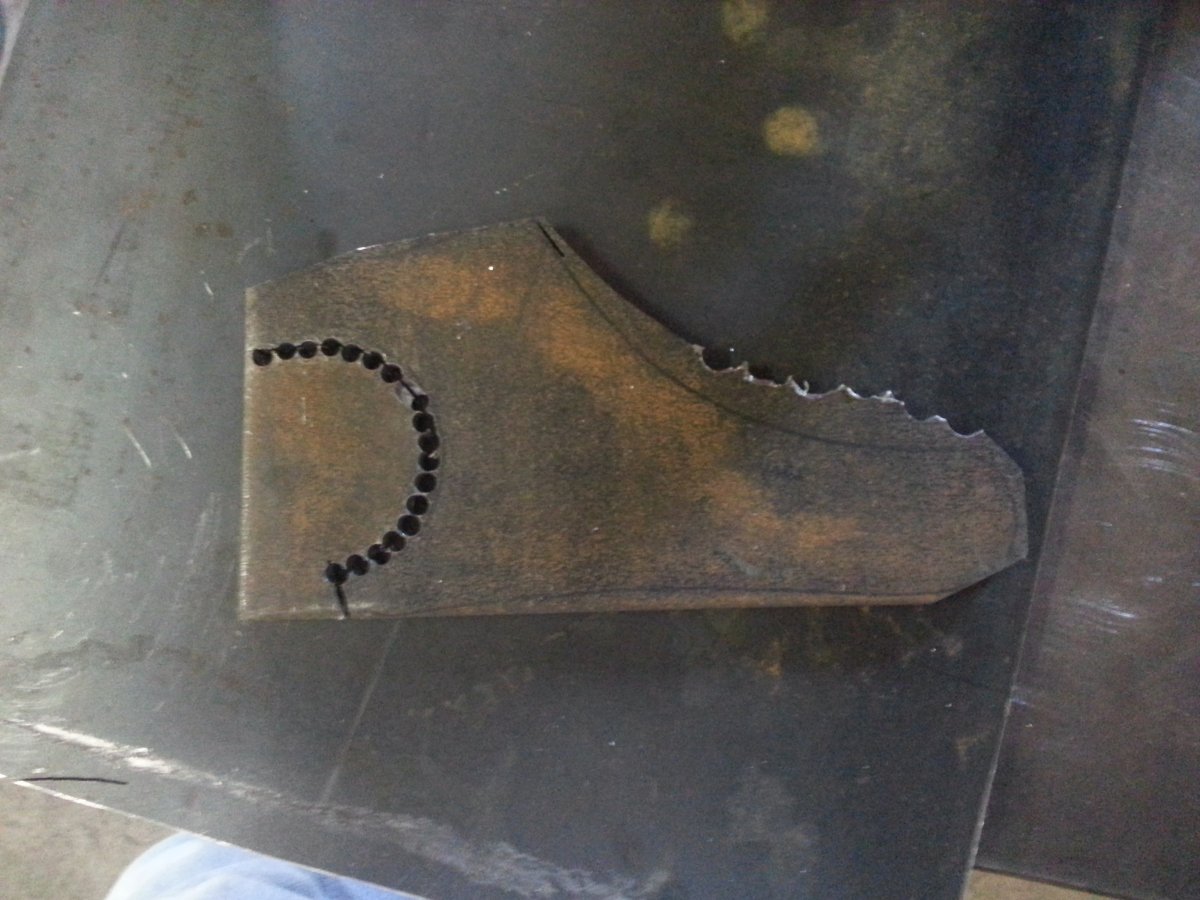

    20161016_103203.jpg 20161016_094637.jpg I think you can tell what part this is.
    For when you don't have a plasma cutter and are out of gas in the torch.....
