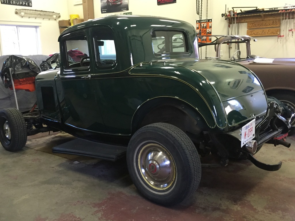

  5. I had the car appraised yesterday so I could properly insure it. Now that that's done, I was able to start making a few changes. Hubcaps off (looks better I think), spare tire removed. I did pick up a new rear spreader bar which I can hopefully get installed this week. I'll also need to see if I can do something with the gas filler. Shorter bumper brackets are in order as well. I also bought a '57 9" that I'll be picking up this week. I really want to get this converted to 5 bolt front and rear so I can get a more appropriate tire/wheel combination.

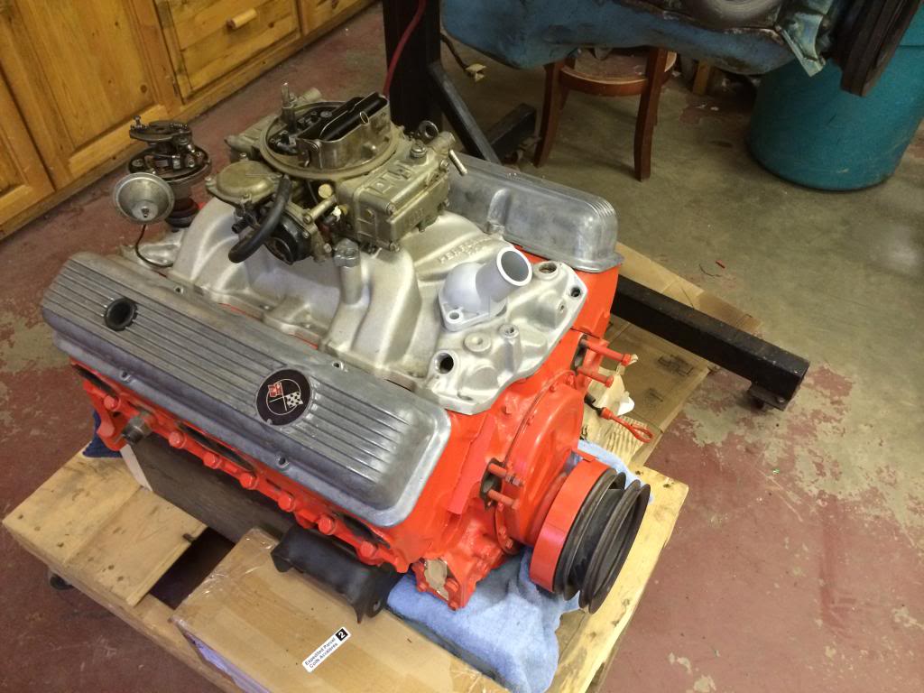

  7. I picked up the 327 yesterday. Fully rebuilt with paperwork from the engine shop. .030 over, forged pistons, triple angle grind, hardened seats, etc. Should be a great engine for this. Just trying to decide whether to just do the front brake kit and install the 9" and drive it this summer like that, or to install the 327 as well. Any opinions on how easy/difficult this swap will be?
    Thanks in advance.

  8. Is the Edelbrock Performer RPM intake a good intake for this engine?
    I've also got a line on a Weiand 2P 8000.
    Is one better than the other?

    Performer RPM is the real deal.

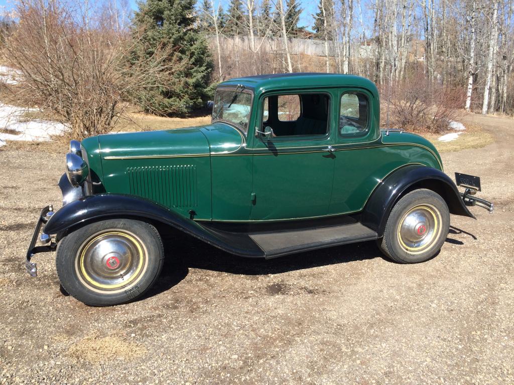

  11. It will be a couple of weeks before I get the 11" 5 bolt brake conversion..... and probably longer before I get it and the 9" installed, so I was screwing around with some hubcaps today since the dog dish caps don't fit these rims. I really like the look of these. What a difference from the 70's T-bird caps that were on it when I bought it. I just wish I had 4. Can anyone tell me what they're from? I bought them at a garage sale about 5 years ago.
    Allan
  12. Those are Lyon caps. There are a lot of them around. I think I have one or two of them. I will look.

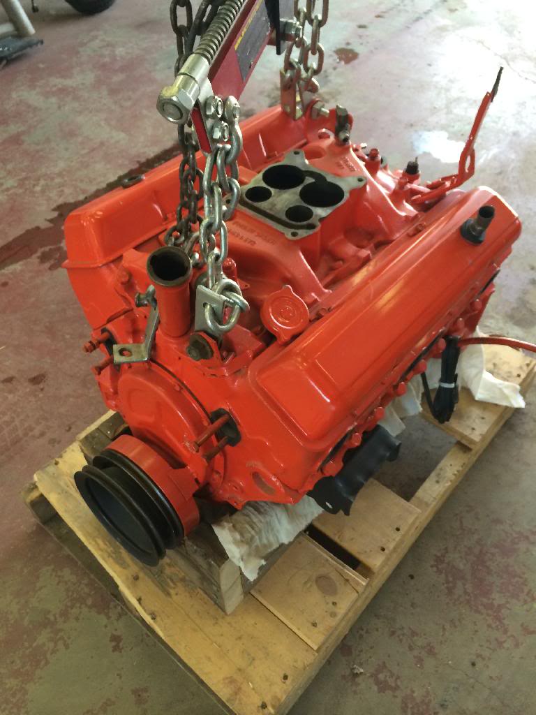

  13. Really busy with work so not a lot has been done to the deuce, but I did get the 327 looking a little different. I'll be running a single belt to drive the alternator. Would somebody be able to advise whether a short water pump would allow me to use the inner pulley so I can lose the outer pulley and make some room?
    Thanks in advance,

    A short water pump setup uses a flat pulley that sits right on the balancer like the inner pulley in your photo so I think you should be fine to use that one with the short pump.

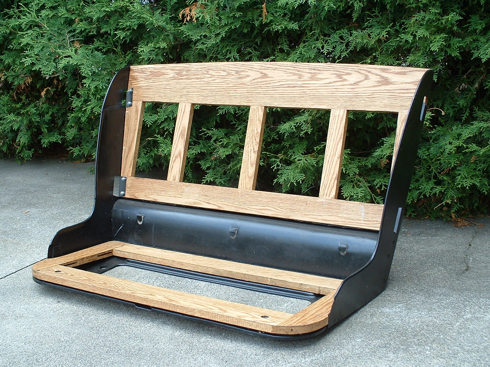

    Here's what you need for a seat Al, an original 32 frame.
    Apparently this one was available here on the Hamb and another member scooped it up.
    Keep your eyes open and you can find one.

    that sure looks the same as 31 coupe. Is it?
  18. Blue One
    Joined: Feb 6, 2010
    Posts: 11,462
    Blue One
    from Alberta
    Don't believe it is, 32 5 window specific.

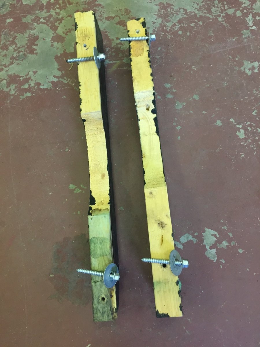

  19. I've been working on the '32 a bit, installing an 11" brake kit that I'm now trying to source brake hoses for. Any advice on where I can find a couple 16" long hoses with a 1/4" female end with normal clip mount and a banjo at the caliper end? The parts guy I go to is having trouble finding a suitable hose.
    While I'm on the search for hoses, I figured I'd address the headroom issue in the car. I pulled the seat out yesterday and then went to remove the risers from the floor. I had assumed they were bolted though the floor with adequate washers etc......... umm NO!
    05CD29B4-1A82-4E6A-9889-25EC5381B2D5_zpsle5kzpgw.JPG 5AB83E56-1CB4-4902-8504-A0740A30738B_zpsmq7woxy5 - Copy.JPG
    Who mounts a seat like this......... someone who's not planning on getting in an accident?
    Getting rid of the risers and safely mounting the seat to the floor will gain me about 3-1/2 inches of headroom.

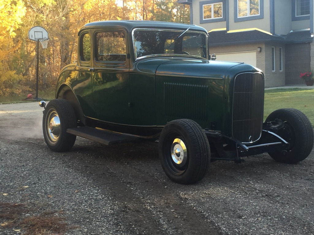

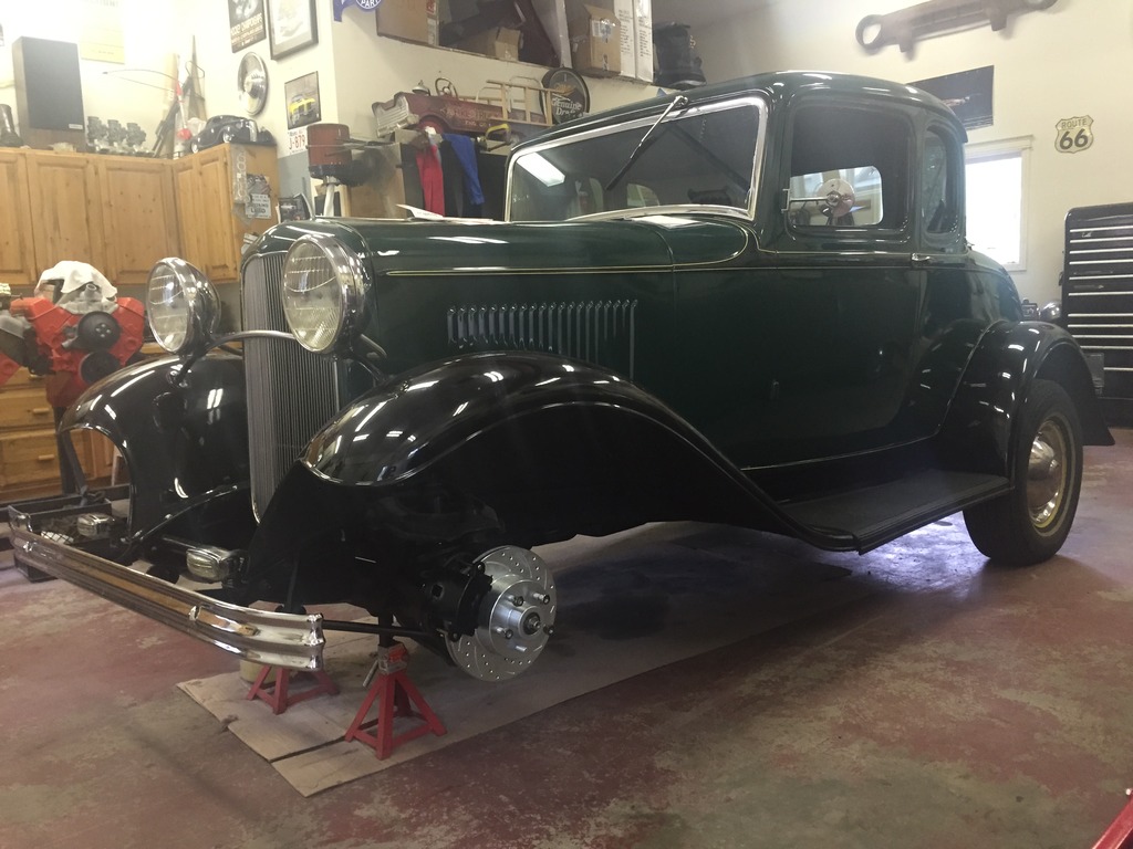

    I finished the brake upgrade and went with 15' rims with a 195 60 15 tire. Huge difference on how the car looks. I really need to get the 9" installed so I can get the rear rims/tires on.

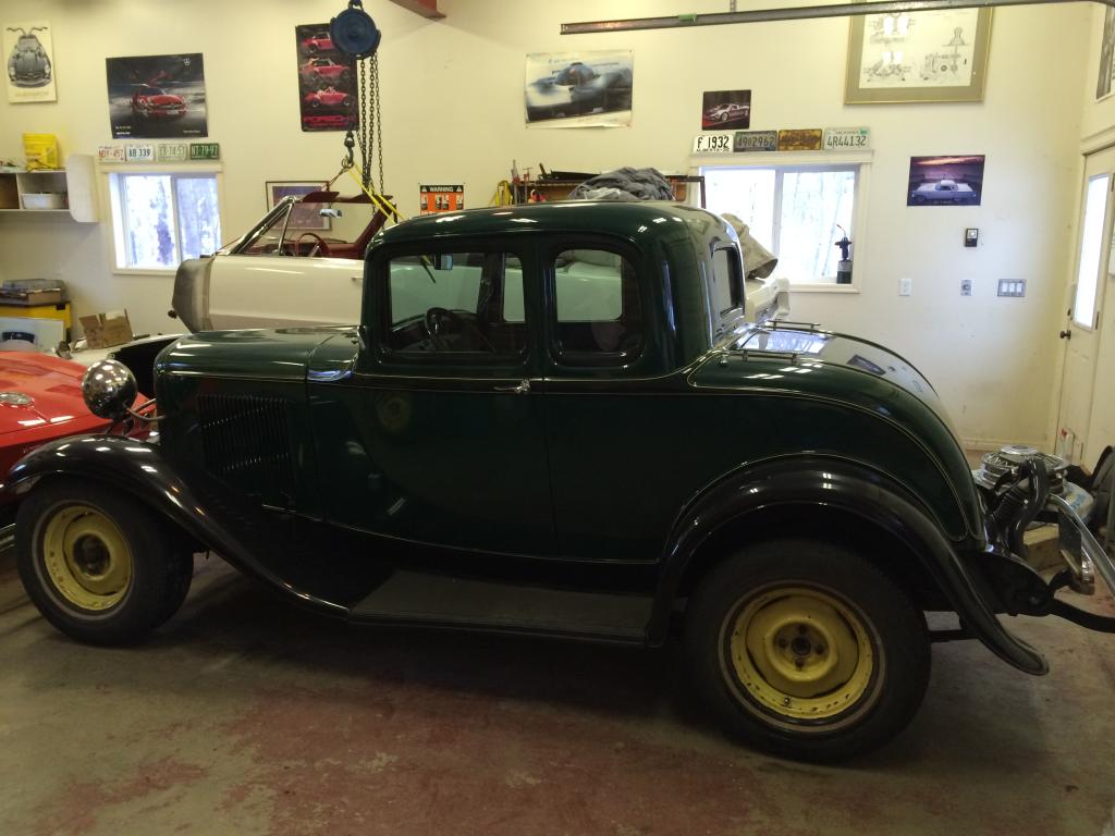

  24. I just couldn't get over the Mustang II suspension and Pontiac V6 under this car. I bought a rolling chassis off the HAMB from a great guy (thanks Steve!) so the car will be getting a bit of a reincarnation this fall. I'll hopefully have the frame delivered by mid August using another HAMB'er for transport. Bill's Transport. Great guy as well!

  25. One last shot as it was.
    The dismantle begins..........
    DE6AE420-099E-4A4A-82F4-A4EF547C482B_zpskcqr9p8e - Copy - Copy.JPG F97961A5-007E-4D9B-9E46-4B1B196D9523_zpsbsxqlnis.JPG
    It does look a lot cleaner with the VW back-up lights removed and will look even better once the coil springs are gone.

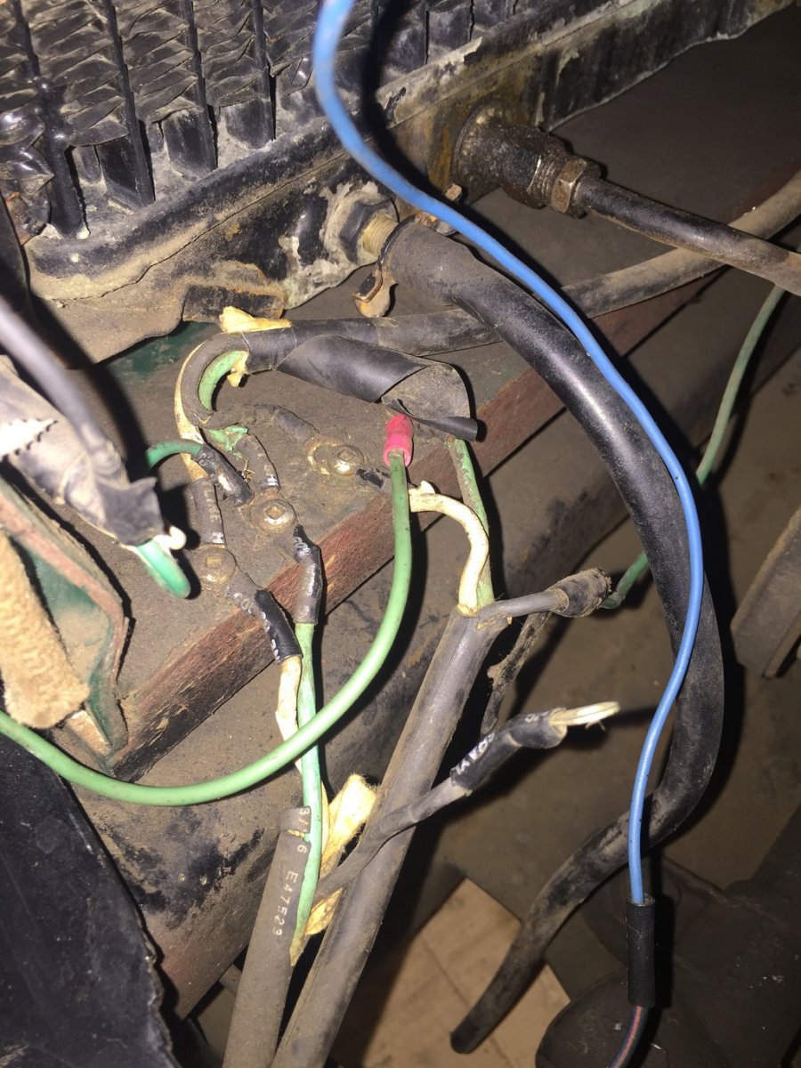

    Nice terminal block. A piece of wood supporting the radiator was used to connect the harness to the headlights and marker lights. I guess it was more traditional than I thought. lol
