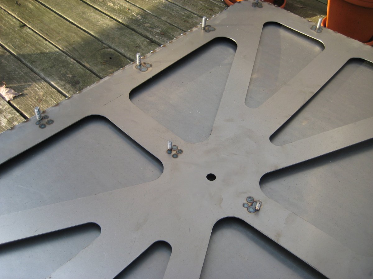

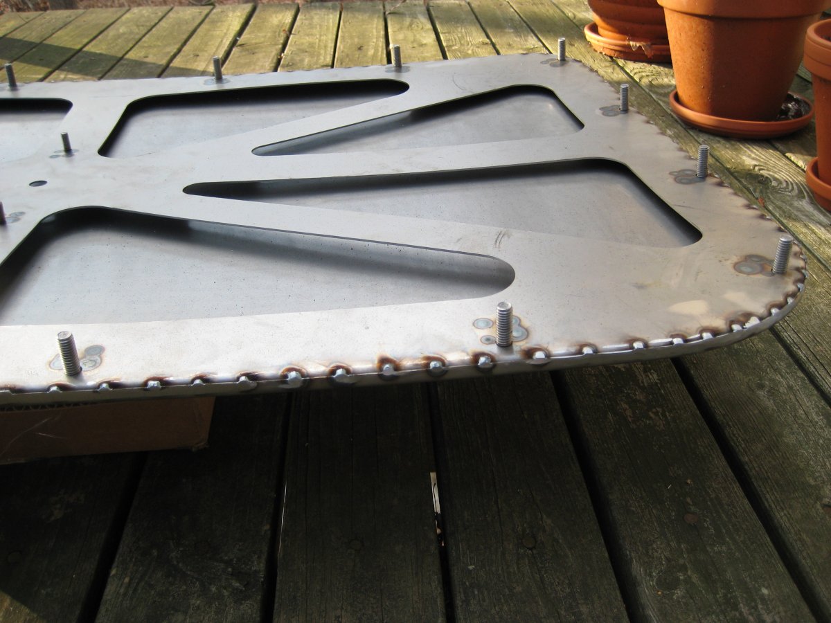

    41Stude, Here is the one I made for my current 36 (the coupe in my avatar). I made the top on my english wheel, and it has a 1/4" lip around the perimeter facing down. The inner structure has a 1/4" lip facing up, and is a material thickness smaller so they nestle together and have small spot welds around the perimeter to hold them together. Each piece is flimsy on it's own, but when tack welded it becomes very strong. It bolts into place, and uses a rubber gasket. Technically you can remove it by unbolting it, but once it's bolted in place that's where it lives. Take a look at my albums of my other 36's, and if you'd like to see all the metal work done on this coupe, I can send you a link to my Flickr picture album of the build. Bob

    Bobper, thats some serious metal work you did. I am not in that league however I did build something I think I will use. I started by using my shrinker/stretcher building a frame that has a 1/2 inch lip down and 1 inch lip overlap the top. After getting the correct shape I tack welded a piece of sheet steel over it bending the edges around. Very rigid at that point. I plan to cover it with Marine grade vinyl. I am looking at using dowels to slide the front in and using some sort of locking latch on the back. Putting a thin rubber seal under the overlap lip will hopefully seal it. Yours looks great but I dont have that talent.
