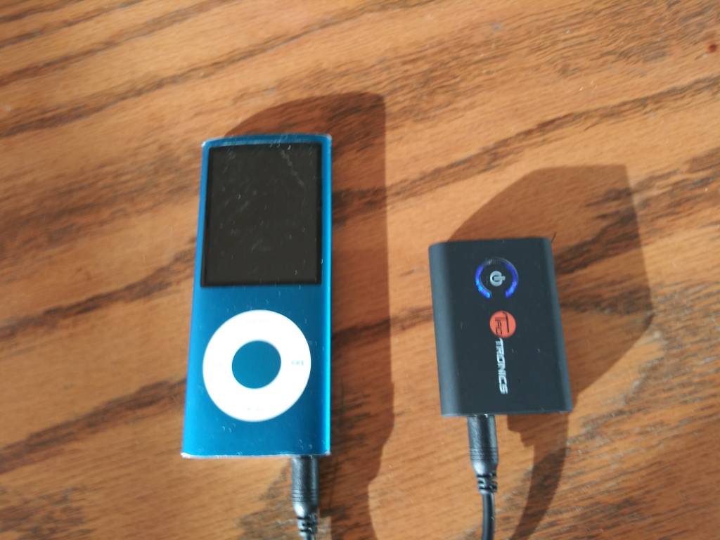

    Billy, I have an old I-pod without bluetooth that I wanted to play with bluetooth speakers. Picked up a bluetooth transmitter on Amazon (pic) very reasonably.

    I press the button for a couple of seconds, it flashes for a few seconds while pairing then glows solid when paired.

  7. 19vegas56
    Joined: Apr 4, 2004
    Posts: 30
    19vegas56
    It automatically pairs with whatever is in range. It has to be within 3 ft to pair and operating range is about 30 ft.
    Sent from my LM-X410(FG) using H.A.M.B. mobile app

    But the MP3 that @19vegas56 uses wouldn't need the bluetooth transmitter . A 3.5mm phone jack cable [supplied] from the MP3 to the Amp would also work great.
    Thats how we use our MP3 player

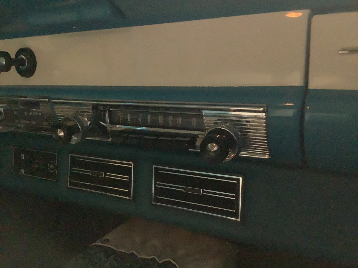

    The majority of my thread is all about how we hid it . The actual install itself is very simple ,like installing an old style car radio [except No Cutting of the dash]
    The AMP we used was designed to boost sound quality on computers . And computers are usually left switched on for long periods of time.[24/7] .This explains the lack of mounting bracket as it would normally sit on a shelf.
    It is also 9v-24v DC input which is great for vehicle [even 24v trucks]
    We were very sceptical, but thought the $$$ was worth the risk.
    So we hooked it up to an old 12v AC adaptor used for a cordless phone [this was 12V x 2A output or 24W] Then we ran some speaker wires across our lounge floor to 2 x home theatre speakers . The sound was pretty good [enough for me to turn the volume down from sitting in the next room]
    My phone was very easy to pair to it. It recognised the Bluetooth "frequency" automatically .
    If you buy the NS-01G it has controls on the face, and an annoying voiceover that says "Bluetooth Mode" or "Audio Input Mode" etc
    But the NS-10G PRO has less features but better electronics and is a more suitable candidate for being hidden out of sight/reach.
    Here is an amusing review of the Nobsound NS-01G
    This shows how it works in Bluetooth and Aux Input modes
    The NS-01G is only 60W [30 x 2] but also has headphone output, and voiceover etc that you don't want.
    This is a review on the NS-10G PRO that we used
    We use a 7.5A fuse so that limits ours to 90W [7.5A x 12V] to get 100W you need a 10A fuse and better speakers than our "Freebies"

    The only difference since the original write-up is we changed from using a Piezo-electric buzzer on the door switch.
    We now have a door relay switch which switches off as soon as the door is opened [with ignition off]
    This is needed with our 57 because we don't have an accessory position on the key/switch.
    Now about the sound system!! [We are not "Audiophiles" but do like reasonable quality]
    The system was so successful, that we now have 2 of them in our house.[it was also a fun project]
    These Amps are brilliant in a car ,and amazing in the house with reasonable speakers
    If we were to do it again, We wouldn't bother mounting the Amp blind in our glovebox.
    Just hide it up under the dash or under the seat and simply use the bluetooth mode [we don't use the 3.5 aux input at all]
