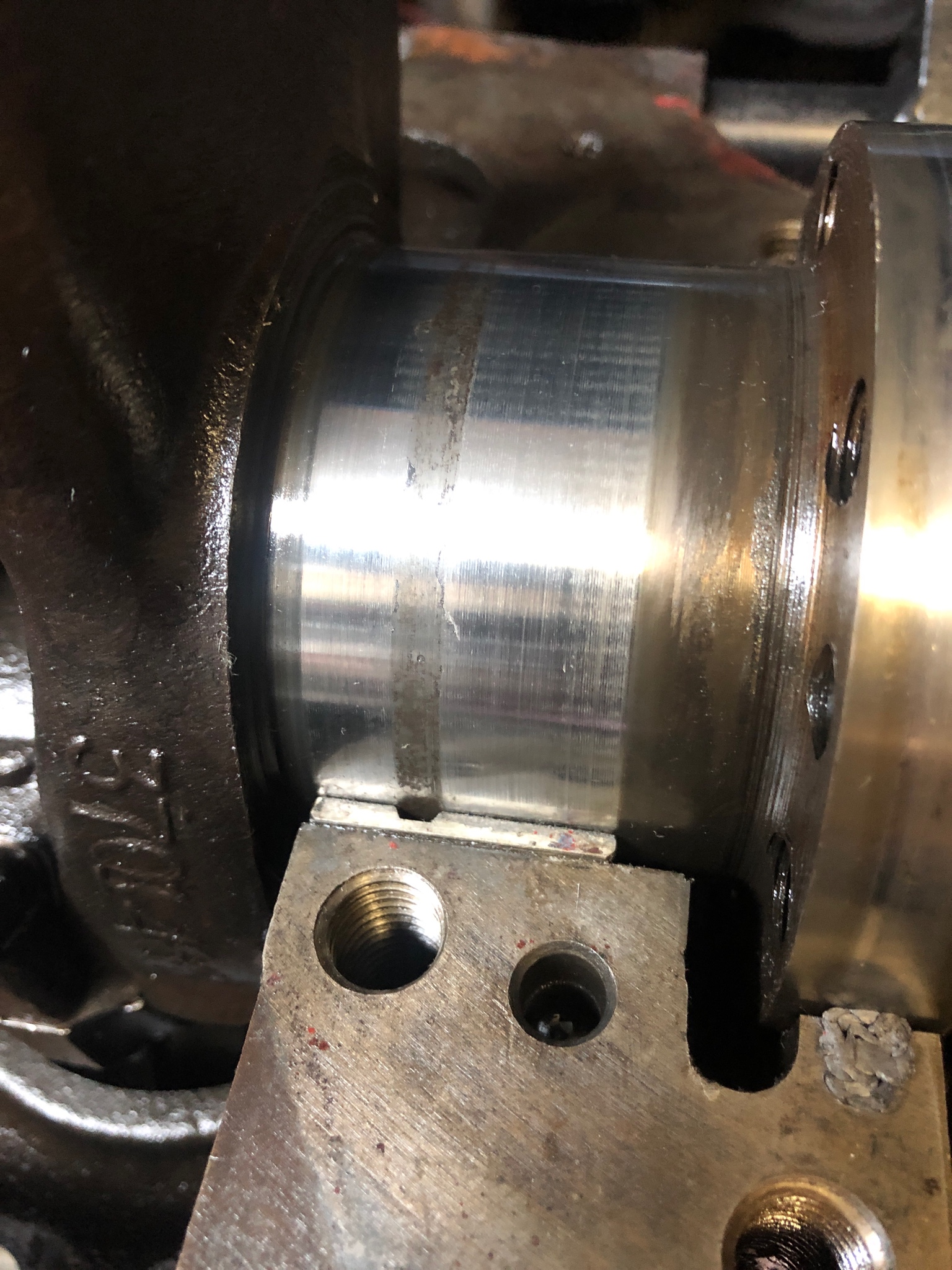

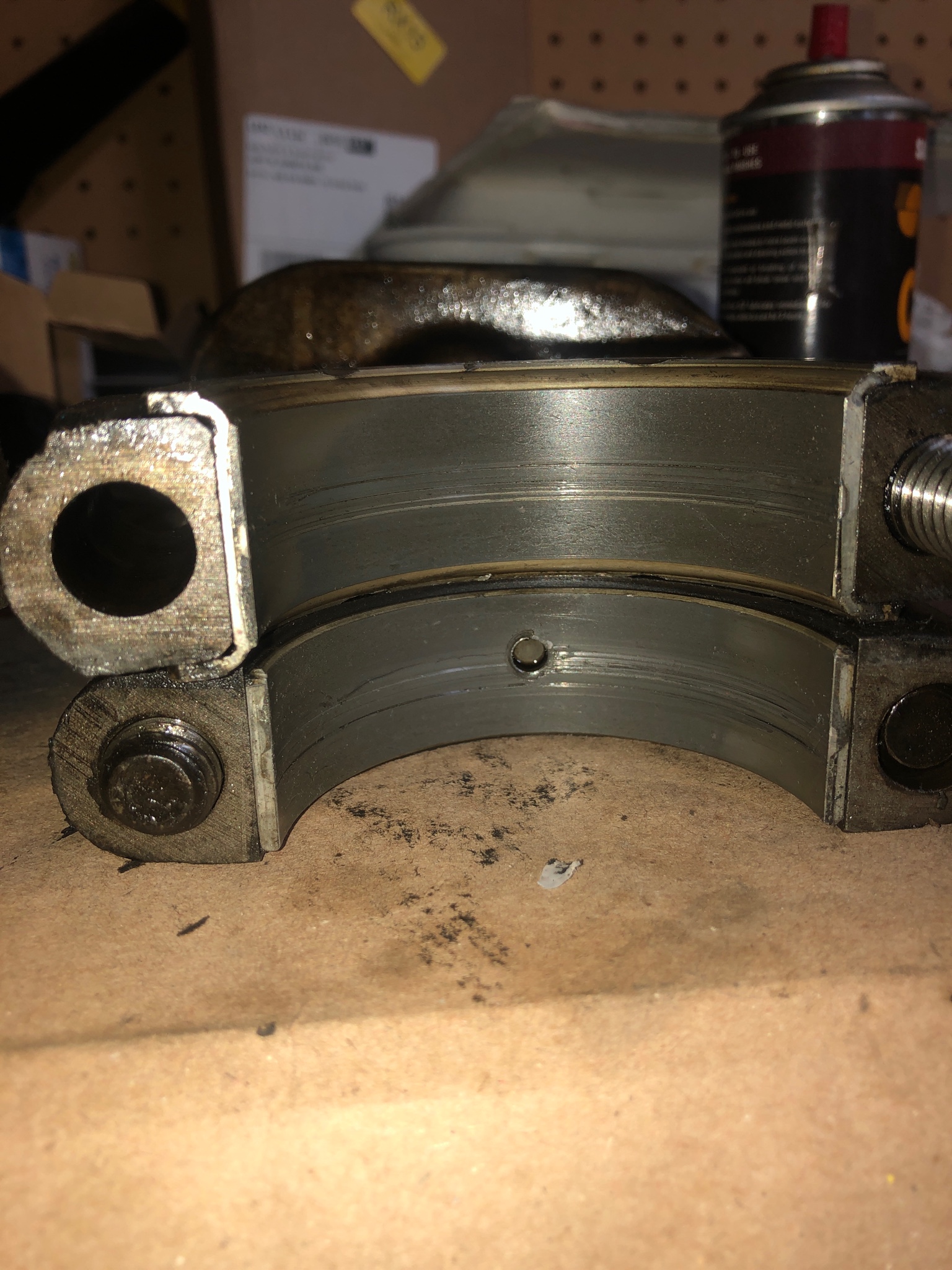

    I got this engine torn down to change out all the seals, inspect everything, clean and paint etc... The main bearings all have these score marks that are just deep enough to feel with my fingernail. The crankshaft has corresponding discoloration, but I can’t feel it with my fingered or nails. I’m going to replace these bearings, but should I have the crankshaft turned as well?
    Sorry for what may be a stupid question, but this is my first time diving into [​IMG]the deep end of an engine, so I have lots of possibly stupid questions [​IMG][​IMG]
  2. What do the upper shells look like?
    Those look like a little damage from some trash going through at some point.
    If the crank looks good ,,,no reason to have it turned,,,maybe polished,,,up to you?
    Do you plan to spend a lot on this rebuild?,,,,,there can always be plenty of things to spend money on.
    Post more pics of the other bearings and crank journals,,,that will help as well.
    By the way,,,did you already clean the rear main cap,,,,,that old rope seal looks really good.
    If the entire bottom end is that clean,,,you might have a really good engine to start with.

  3. Those bearings have seen dirt and debris .
    Worth while replacing.
    Take a pic of the crank .
    Might get away with just bearings and a polish.

    That is an example of the bearings doing their job. Being the softer metal compound of the two (crank/bearing) they absorbed the consequences of the debris and kept the crank from serious harm. Replace the bearings and polish the crank, you’re good to go.

    I would not even replace the bearings (they're kind of expensive). I'd just replace the seals, and drive it, assuming that the rest of it is in decent condition.
    Before they had full flow oil filtering, there was always a bit of trash running through the oil system. There is not nearly enough wear there to warrant replacing anything.

    Locate a new shim package before re-assembly. The factory shims after one or more disassembly are a bitch to work with. Bearings show no real wear, just debris from dirty assembly.

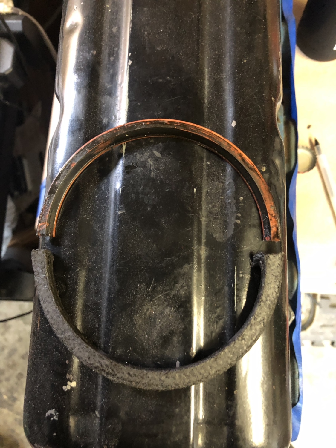

    Here’s the old main seal. Somebody mixed and matched parts. That too half was in backwards, with the lip facing the back of the engine. It leaked a LOT.

    squirrel
    the crank is beautiful, I would just put it back together.
    Can you find a rubber rear main seal? I would use one, if possible...

    That would be ideal, but Tom Langdon says the seal surface on these cranks weren’t machined concentric with the bearing, and to use a rubber 1 piece seal requires some pretty expensive machining.

  20. Man,,,I have never seen a half and half rear main before,,,half rope and half neoprene.
    I think Jim meant to use. Regular neoprene 2 piece seal.
    At least that was how I took it.
    Yes,,the crank journals look fine,,,go with it.

    I guess you can try the rope seal...I'd try the rubber seal first, then change to rope if it won't seal. But that's only because I'm not very good at installing rope seals.
