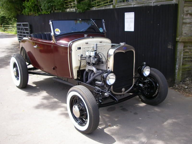

    What color did you paint your roadster? I've been tossing around an oxblood red color for my roadster or an old original ford color from '29, but havn't concreated any decisions yet??

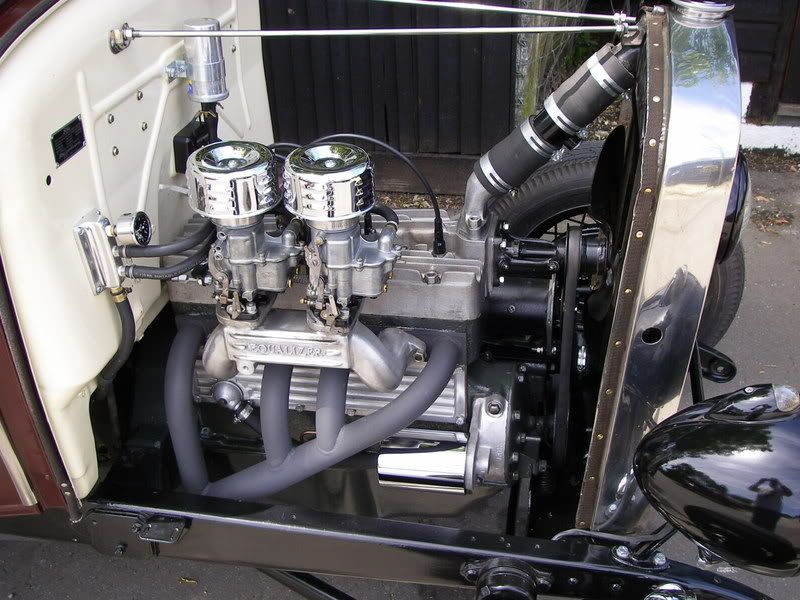

  29. I mocked up the SU's.
    Thing is, I don't like them... :(
    They just look too.. Eerrmm... Birtish. They look like they fell off an MG sports car and thats not a good thing!
    Oh well back to the drawing board... :rolleyes:
