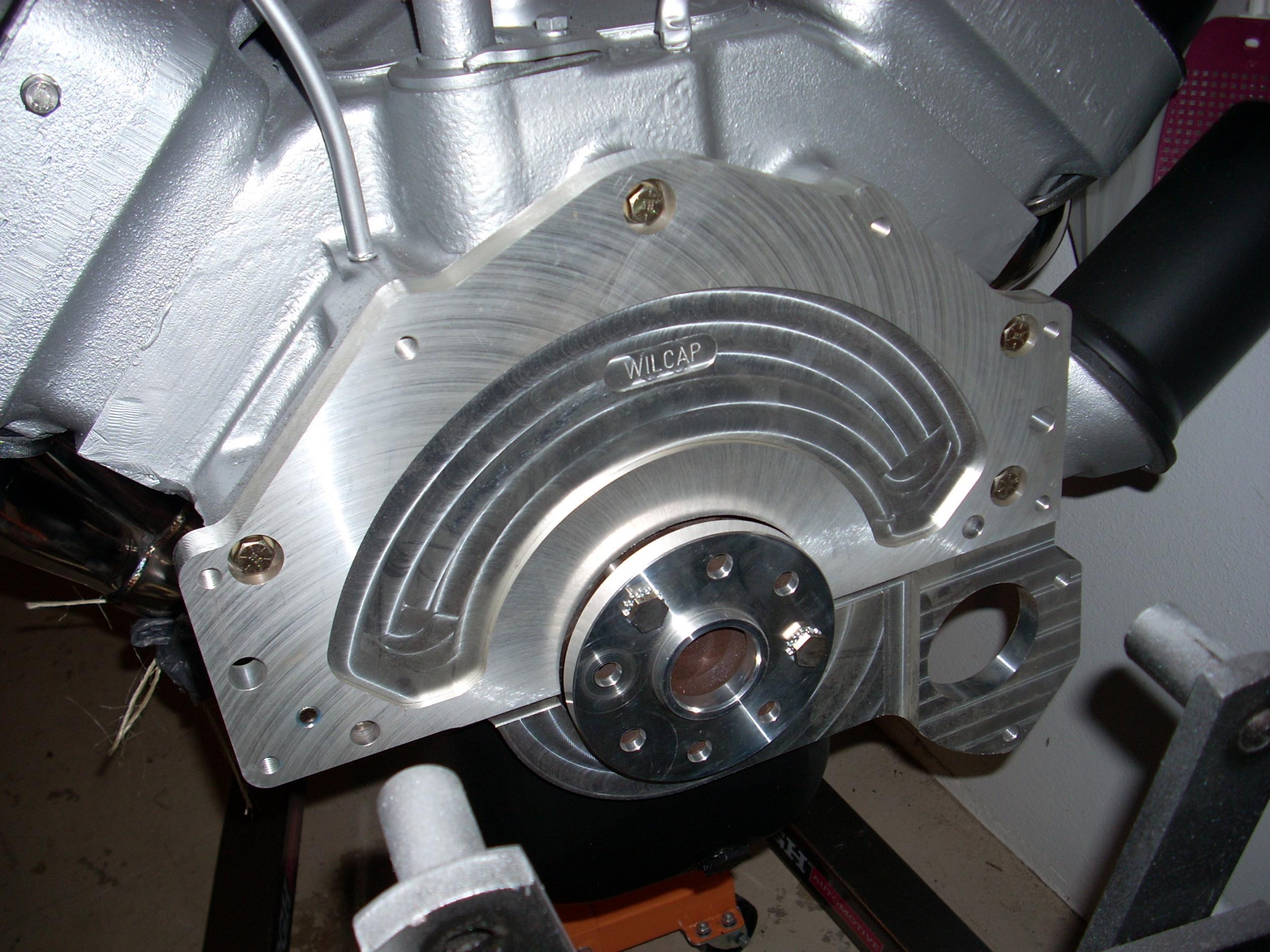

    Getting moving on my next build, a Desoto 291 into a 31 coupe.
    291 will have a Chev AT behind it. Looking at Wilcap and Hotheads adapters:
    WILCAP: http://www.wilcap.com/Hemi.html#392350
    $580.
    HOTHEADS: http://www.hothemiheads.com/transmission_adapters/adapter_chevy_auto.html
    $435.
    They adapter plates look different (I'm sure they both work) and the kits are priced way different. Anyone recommend one or the other?
    Also, what are the pros and cons of the starter either on the driver's side, or the passenger side?
    Thanks for input.

  2. Nemosgarage

  3. Fenders
    Joined: Sep 8, 2007
    Posts: 3,921
    Fenders
    Which is why I wondered why some people would put it on the pass. side......
    I see that Speedway also has the kit, looks similar to the Wilcap adapter plate design.
  4. Pat at Wilcap asked me thuroughly about steering box/steering/starter placement/and exhaust.
    Didn't push anything on me at all- Asked Q's I didn't think of at the time....
    Very Helpfull and all. I went with Wilcap. 354 Chry in a 30 roadster.

    1. Early Hemi Tech
    Either brand will work equally as well as the other.

    Bob @ HH said his full circle adaptor has to be bolted up before you put the oil pan on(@ least on rear sump pans). If you can't get the pan off with the engine in the car I can see problems with work on the tranny or engine if you have to drop the pan to separate the engine/tranny.

    We used a Wilcap in an A/GS Willys, with a 400 Turbo behind a blown 392. It's still in there after nearly 20 years, and Pat is a great guy to deal with.

    I used a wilcap a number of years ago, with lots of frustration I got it to work. I remember having to remove the rear main bearing in order to bolt it up. Also, there were some issues with bolting the flywheel which I can't remember how I fixed. It will work, but it's not a slam dunk.

    I got this kit from speedway. HH was out of stock.

    When I bought my Hemi adapter from Wilcap, I also got a timing cover/water pump mount. I told Patrick that it looked just like a Hot Heads cover. He said "that's because it is. I sell his covers and he sells my adapters". I suspect that is what Speedway does too. I am very pleased with both items and run a remote filter to avoid any clearance problem with the right side starter.

    I have never used one, but have heard there is difficulty with bolting up the torque convertor when using some of those "full circle" adapters, as there are no holes to access those bolts.

    I am using the HH adapter, it very well may be made by Wilcap I just do not know. It is nothing like the adapter shown above though. The one thing I would advise is to tap the crank flange, I did this on my blown 392 build and installing the flex plate was a breeze. On the hemi I am building now I did not tap the crank flange and installing the flex plate was an ordeal. It was doable with the Hot Heads adapter but a huge pain. I personally will never not tap the flange ever again.
