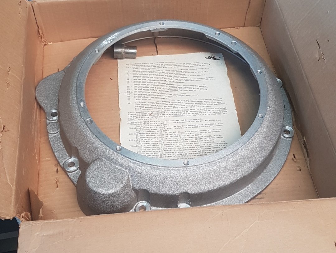

    But i use a Wilcap adapter on my build and thought i could
    put in how i did on my build.
    The pics and text is from my buildthread.
    I wanted to have a manual trans and know that wilcap
    have adapters for all common smallblocks.
    After some lookingaround i found a 3-speed from a Ford Mustang 66.
    So i ordered one kit from Hotheads for Ford sb.
    To reach in to mount the nuts on flywheel bolts i had to expand the hole.
    Later i hade to cut al the way down to reach.
    I am not worried about the streinght couse this is how the stock
    adapter used with automatic transmission is done.
    It was some different supportbearings included in the adapterkit but nothing i could use.
    This is just a mock up so i dont need it yet so i mounted it without.
    Checking the starterfitment. Looks good. I dont see any problems here.
    The mountinginstructions say the kit is ment to be used by a Mopar ministarter.
    I really hate the look of a ministarter and cant find any reason to not use a ordinary starter.
    The adapterkit was supposed to use Ford 10 inch clutchparts.
    So i buy me a 10 inch cluchkit that was listed from 65 to present to use thru ebay.
    I dont know if Ford have used different pressureplates during the years or
    if the flywheel is drilled for another pressureplate.
    ( The instructions says its drilled for Ford but on the first page
    its written that all kits is drilled for Chevy patterns.)
    Its some mixed info and i have wery little experience in Ford and Chevy stuff.
    But the one included did not fit the flywheel.
    Looking in my spareparts i had a pressureplate for Dodge 53 with 10 inch clutchdisc.
    And that one fits perfect.
    And then i looked on the clutchdisc and think it look close to my 53 Dodge to.
    So i get my centeringtool made of a inshaft for a Dodge gearbox and tested.
    It was a perfect match. With a sparedisc at home to i really didnt needed to buy
    any clutchparts at all.:D
    But i used the clutchdisc and the throwout bearing included.

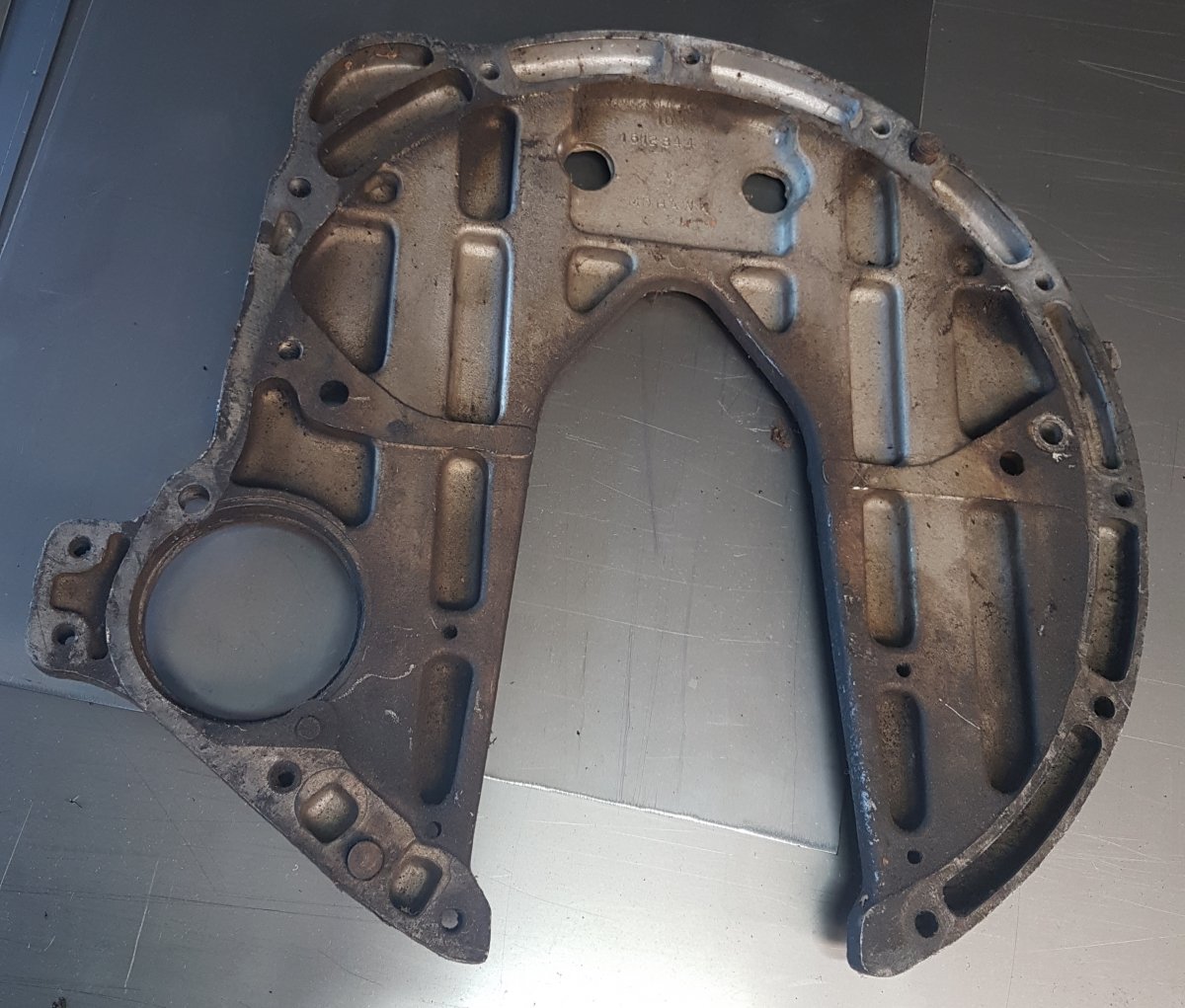

    1. Aussie HAMBers
    Tried searching but to no avail. I have a Trans-dapt NC-4 to put the 3 speed behind my little red ram but am having trouble finding the 1613713 starter plate. The Trans-dapt paper work recommends the 1613713 or equivalent, my question is, who has the numbers for the 1613713 equivalents/interchange?

  22. 35desoto
    Joined: Oct 6, 2009
    Posts: 765
    35desoto
    An adaptor plate from a 1954/55 V8 onwards powerflyte will fit. The number you quoted comes from a 1956 maybe 57 yet the plate from in front of any powerflyte is the same through the mid to late 50's. The torqueflyte ones are slightly thicker and I am scratching my head to recall the thickness difference between a powerflyte and a torquflyte one. cheers Brett

  24. 73RR
    Joined: Jan 29, 2007
    Posts: 6,565
    73RR
    There are three different thicknesses for the plates. Back in the 'old' days the adapter folks used the 57-58 in order to use the 12 volt starter and the 172 tooth flywheel. The 57-58 plate is 1-1/8" inch thick. I don't think many used the 56 pieces.
